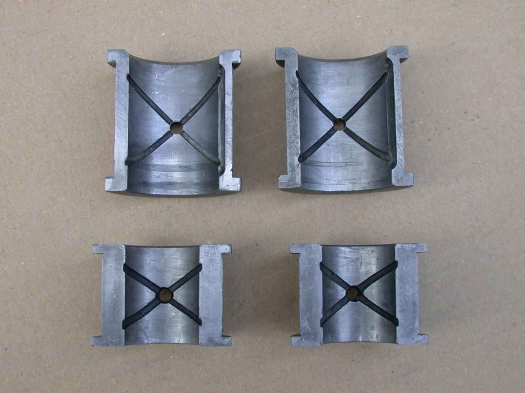

                        Too much oil is better than too little, although messy. What you want to do is flood the headstock bearings when you start up, then reduce the flow as you keep working. Don't forget the bearing will warm up as you use the machine, and alter the clearances.
                        The white metal bearings in which the spindle runs have grooves in them which retain some oil – will do a pic if I can dig out some spare bearings I have.

                                    As promised earlier, picture of ML7 headstock bearing shells, for those who've never removed the spindle.
                                    Phil
                                    #116898
                                    marqous basu
                                      @marqousbasu54479
                                      Oh, I see, thanks for the pic.
