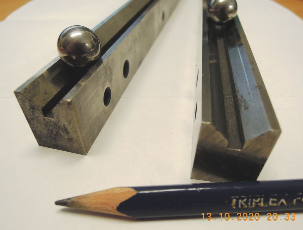

        My microscope X-Y table guideways might need a regrind. They have a little wear but it's the brinelling and corrosion pitting that's the real problem as this affects the smoothness of operation.
        I think the regrind would need to be a precision job with no more than say 5um taken off each of the surfaces of the 45 deg. flanks. At the same time I cannot risk having any part of the 250mm length of the guide not cleaned up or that might introduce some other problems.
        Do you think this is a feasible operation ?
        If so does anyone happen to know anyone within say 50 miles of Milton Keynes that might be capable of this ?
        The reason I need to keep cut depth to a max of 5um is because I have to compensate for the machining with some oversize balls to avoid introducing play into the system. I think the largest oversize 1/2inch balls are about +10um.
        Your thoughts are welcome.

          Have you considered lapping the surfaces?
          Mill some copper/aluminium to 90 degrees, charge it with abrasive paste and give it a go is what I'd try first.

              Regrinding the whole face seems a bit OTT as there is only line contact. Why not get bigger or smaller balls?
              OK, I dont know the the construction but I would have thought smaller balls and packing to correct the height should be doable.

                  You state 'cut depth to a max of 5um', which is .005 mm so not a grinding job as it would be nigh on impossible to set up & remove such a small amount but as previously stated lapping would be you best bet.

                      Tony – As I thought about it more last night I concluded that the best way might be to drop the bars into V-blocks and skim each flank using a surface grinder. (The side of the wheel should clear the other flank due to the undercut at the root.) Assuming the guides are already precision machined, most of the error 'could' be in the heights of the V-blocks so some shimming might be required here to get the guide perfectly parallel with the table. I'm by no means an expert in such a field so I would be very interested in your thoughts as to why 0.005mm would be a challenge.
                      Lapping proposers – yes this went through my mind too. I was worried by two things. Firstly straightness is important. Unless the lap is equally straight, as long and rigid as the guideway itself, would I be at risk of producing small undulations along its length? My second concern was to do with the width of the surface. Its only about 5mm wide so I was thinking the lap would be a little unstable and i would probably end up converting the flat into a camber. Have I got the wrong idea here ? Sorry Blowlamp – I have just re-read your post and I see you are proposing a 90 deg block, presumably to do both flanks at the same time. Yes this solves my stability concern.
                      Ian P – unfortunately the guides are dowelled and bolted to flat surfaces so it wouldn't be easy to allow for a smaller or larger ball without a lot of argy bargy.

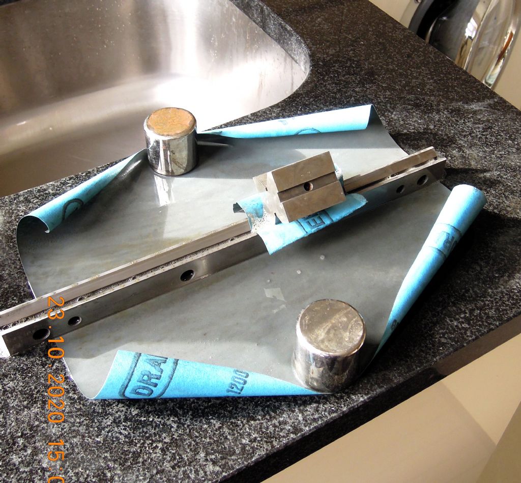

                          Tony I think you were right. I did some flatness checks with a micron DI on a surface plate and although the guides were surprisingly accurately ground it was quite obvious a 5um cut would leave some areas not cleaned up. This was the last thing I wanted. I therefore used the corners of a small V-block and some carbide papers to clean up the surfaces.
                          I didn't manage to remove the brinells completely (which I measured to be about 5um deep) but removed enough metal to take away the rims around the craters, and the corrosion pitting and staining. This should make the things smoother.
                          As I need to make new ball-spacer bars, I'll produce the new ones with the ball spacing slightly different to the originals. This will ensure that all the balls don't fall into what remains of ruts at the same time, hopefully further improving the smoothness of travel.
