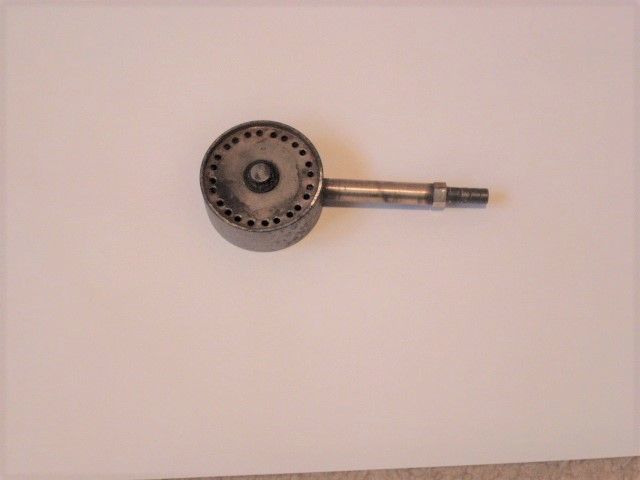

            Clive Brown 1
              @clivebrown1
              burner.jpgI run my Stuart 10H and other small engines using a "Tubal Cain" 3 inch vertical boiler as described in ME some time back.
              I made the burner from bits of material in the workshop. The jet is drilled no. 80, ( 0.35mm) being the smallest drill I had and it runs directly off a Camping Gaz butane cylinder. The air admission is on the underside, not visible in the photo. Works fine, controllable and produces plenty of steam.
              The main body is 45mm dia.
