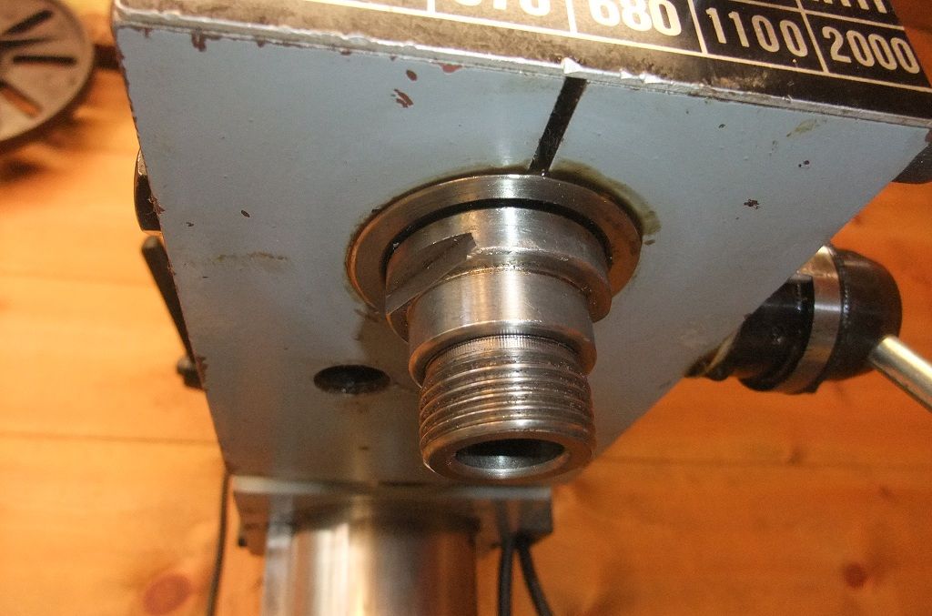

                            I have now got the Mill and, of course will have lots of questions
                            I need a clamping set, what size will I need (T Piece)
                            Here is a photo of the end of the rotating bit, is this meant to come off
