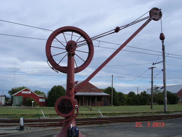

                  I think there was a bit in ME, back in the 1990s, suggesting that with documentation, faults, repairs, upside down lock nuts, and other oddities can actually gain points if you are copying a particular prototype, but then again you can build your model as the prototype should be. One of the important things in the artical was the presentation of information, about the prototype, and the model, and if the item for display in competion it should be well documented.
                  Heres a crane at the "Ferrymead Park" on the railway platform.  It's not complete, but still interesting.       Ian S C007 (640x480).jpg
