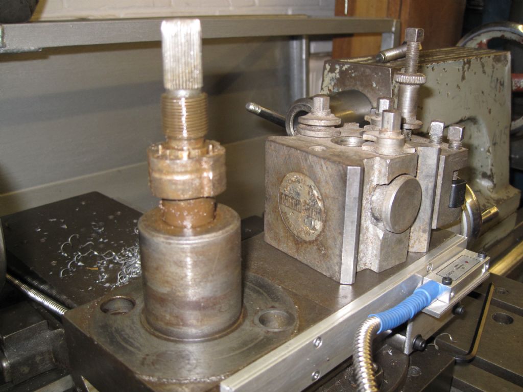

      I have just purchased a very good Colchester QCTP with 4 toolholders from Fleabay. Intention is to fit it to my Colchester Student 6" lathe which currently has a 4-way tool post. Dismantled the 4 way toolpost to find that it revolves on a 44mmx4mm pillar which appears to be as one with the topslide casting. The threaded and splined post you can see in the photograph is removable by undoing a locking bolt of some form underneath the topslide. I unfortunately thought the whole assembly would come of as one.
      The QCTP came with a 'T' slot mounting and bolt. What would you advise. machining off the 44x44mm pillar and just using a bolt without the 'T' slot fixing. or machining off the pillar and maching a 'T' slot in the topslide (not sure there is enough depth for this option till fully dismantled. This latter option would cause issues with the DRO components so may well be a no goer. The more I think about it option one would appear to be the best. What are your views.
      Many Thanks,
      Colin

          I did the same on my old student to fit a piston type tool post
          I cut off the pillar and drilled and tapped for the right size stud (16mm IIRC)
          worked well for 5 years then I bought a newer student with the newer style topslide
          Ian

              Ian,
              Did you hacksaw the main chunk off and then mill down the face of the topslide, or did you flycut it. I am highly unlikely to get rid of this lathe as have lots of bits for it.

                Ian Parkin
                  @ianparkin39383
                  Yes I just bandsawed it off and then cleaned up the face on the mill
                  i seem to remember making a loose stud with a square head which fitted in the remaking hole.
                  my newt student has a t slot available to mount a tool post or whatever
                  ian

                    My Dickson toolpost has a ground circular recess on the bottom plus the centre hole is larger than the stud, if yours is similar why not saw part of the cast column off and then machine the remaining 6mm or so to suit the recess in the bottom of the Dickson holder.this would give a firm reliable location spigot.

                      Nigel,
                      The toolpost does have a recess. How do you suggest I machine the spigot. Obviously I cannot do it on the Colchester, not sure whether the topslide would fit on faceplate of ML7. I could possibly fix it to the rotary table and do on Milling machine. I have not used the rotary table as yet, so this would be a first.

                        Richard Kirkman 1
                          @richardkirkman1
                          Just for reference, I just received a spare whole cross slide with QCTP attached. Looks like it's just been chopped off and flattened, then a bolt has been used to secure it. However, the actual slide has not been tapped.
