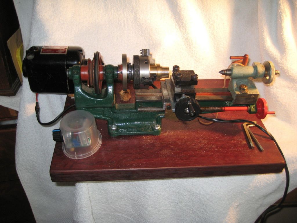

  • #206432
    James A
      @jamesalford67616
      It is nigh on impossible to find chucks and other fittings with a 1/2" thread to fit the Flexispeed, but there is a plethora of equipment threaded 14mm. I have been considering turning up a spigot, internally threaded 1/2" and externally threaded 14mm to screw onto the spindle. This would allow me to fit new chucks, faceplates and, possibly, collets.
      I was wondering, though, whether the overhang which this would introduce would be a problem, leading to avoidable flex and inaccuracies. Any thoughts?
      Regards,
      James.
      #17846
      James A
        @jamesalford67616
        #206434
        David Clark 13
          @davidclark13
          You could make a new mandrel with the correct thread. The surplus original threaded items would find a home on Ebay.
          #206437
            James,
            I think the popular 14mm fit is now 1mm pitch … so, if you were prepared to skim the crests off the 1/2" thread, it may be just possible to make a tubular sleeve, internally threaded [somewhat less than] 1/2" and externally threaded 14mm.
            It would be very thin, and would need to be made with great care and good material !
            Then; David says, you could probably sell any original items … I suppose it depends whether you want to preserve the originality of your Flexispeed, or modify it.
            #206439
            James A
              @jamesalford67616
              Thank you for the replies. I do not yet feel confident enough to try making a new spindle, primarily due to the the Morse taper for the centre. This is the sort of thig which I had in mind.
              : 455912.jpg
              Regards,
              James.
              Edited By James Alford on 03/10/2015 10:25:22

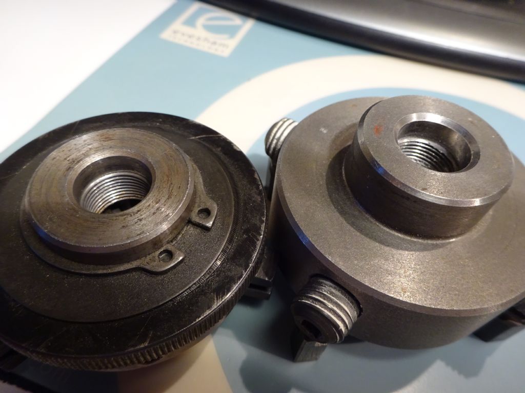

                                I think I would bore out the 14 mm thread in the chuck to something larger, cut a thread in the hole(can be quite fine), then make a short sleeve, with a 1/2" thread in the bore, and a thread to match the new thread in the chuck. It might be best to fit the sleeve in the chuck first, then bore it and cut the internal thread, you would of course need another lathe to do this.
                                Ian S C
                                #206607
                                Lambton
                                  @lambton
                                  The conventional way would be to make a chuck back plate with a 1/2" thread and register to suit the existing lathe spindle, then machine the front face to suit a standard chuck of suitable diameter. Arc sell a range of suitable small diameter back-plate fitting chucks at very reasonable prices.
                                  When I first acquired a Drummond lathe many years ago this is how I fitted both 3 jaw and 4 jaw chucks.
                                  I think this will give a more satisfactory result than some of the more ingenious methods suggested.

                                                    Thank you for all of the suggestions. The one which I originally favoured was turning off the existing thread, fixing on a sleeve and threading it to fit the new chuck. However, having looked carefully at the spindle, the wall between the inside taper hole and the outside, once the thread has been removed, will be very thin, especially near the end. This rather puts me off the idea.
                                                    I have decided to buy a chuck anyway and just have a good look at the fitting. The pictures of it give the impression that it has a very deep, unthreaded 15mm register. If that is the case, I may be able to make a spigot, but use the depth of the register to reduce the increased overhang introduced by the spigot.
                                                    If, on the other hand, it does cause a large overhang, then I shall have to think again. Mind you, seeing this set up, I wonder……..
                                                    Regards,
                                                    James.
                                                    #206778
                                                      Looking at my two Emco chucks with teh M14x1 thread it would be possible to machine say 2-3mm off the boss that sticks out teh back and open the threaded section out to 16-18mm.
                                                      You could then take a piece of 30mm steel, bore and tap to suit your existing spindle. Then screw that onto the spindle and reduce most of its length to a good fit in your modified chuck but leaving a 3mm flange at the head end, this would in effect become a backplate.
                                                      Now just drill for three M3 fixings and tap the chuck to match and you have a chuck with minimal overhang that will screw onto your existing spindle.
                                                      The register on an Enco U3 spindle is 14mm and the chuck plain hole 14.1mm
                                                      Edited By JasonB on 06/10/2015 08:13:12
