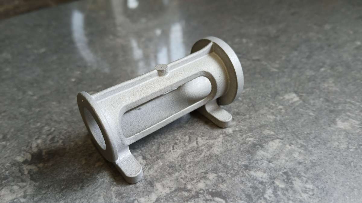

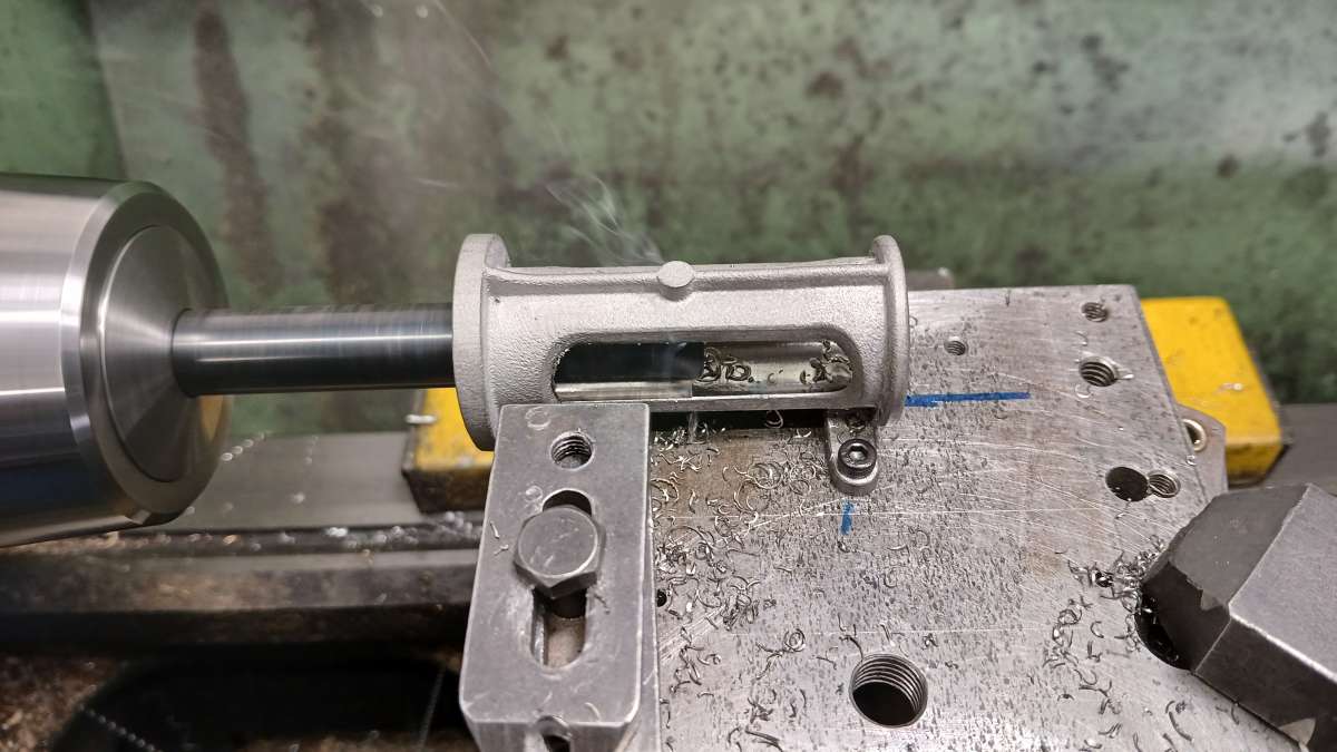

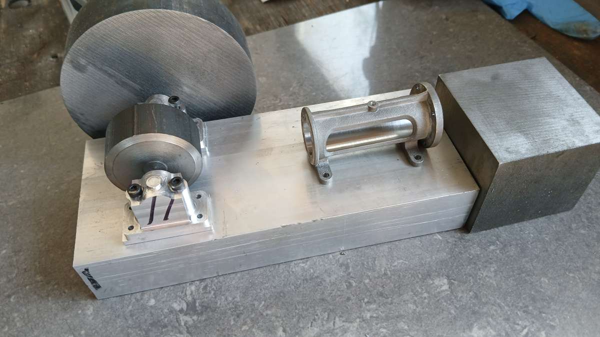

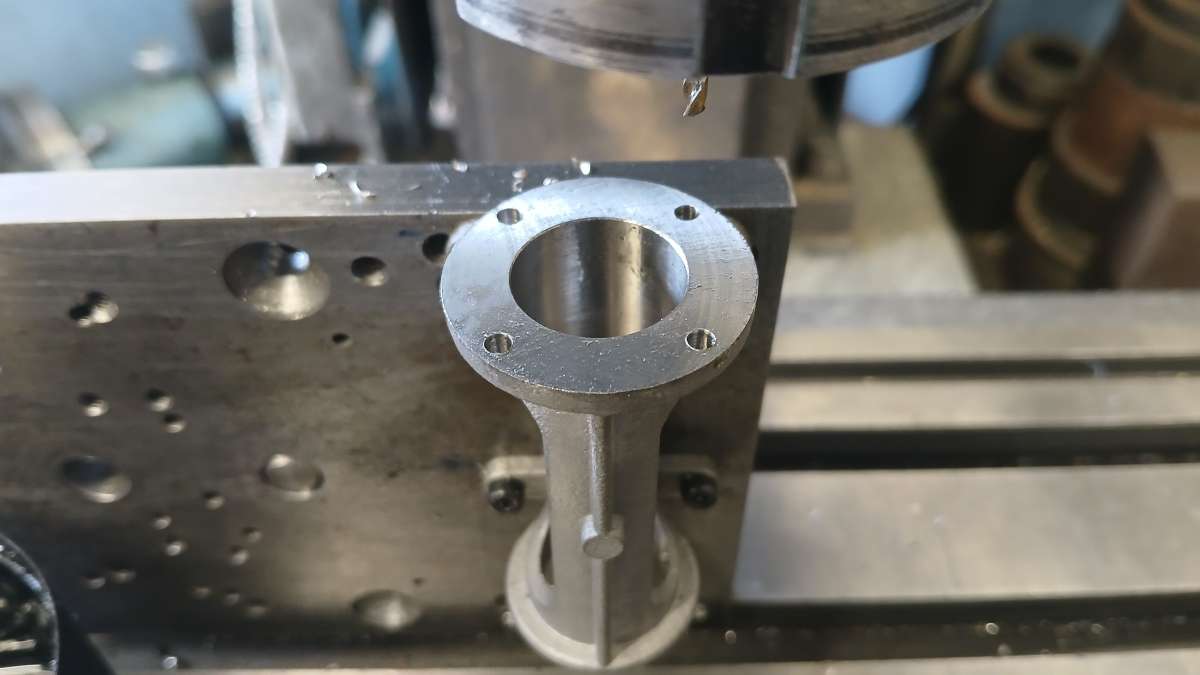

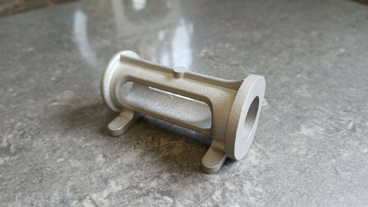

      I’ve been waiting a while for a suitable part to come up that I could get 3D metal printed just to see how it would turn out. The trunk guide for my next engine seemed to fit the bill so an STL file was created from my Alibre 3D CAD model and uploaded to a few online printing sites to see what the costings and options were.
      trunk 3d
      I have seen mention of Craftcloud on a couple of other ME forums and ended up going with them. Stainless Steel 316L along with Aluminium seem to be the most common and cost effective materials and Craftcloud offer several prices for both, they also offer DMLS which is said to have smaller layer height than SLM which most other sites do so I went with a 316L DMLS part, basic sandblasted finish.
      Production was quoted as 3-4 days and a further 3 for delivery and that is what it took. Several update emails to tell me of progress and good tracking all the way via Fedex.
      I’m quite happy with how it turned out, better than most sand castings and as good as many lost wax. There was a tiny depression on the flange but as I had allowed 1mm machining allowance on that, the feet and the bore it was not an issue. I can’t see any layer lines and there is just a hint of a bit of remaining support in a couple of places. For an idea of scale it is 61mm long.
      20250315_120053
      20250315_120115
      Milling (carbide) and boring (HSS) were fine, just a bit more pressure needed when drilling the holes (HSS) so no problems with machining which some of the earlier sintered 3D prints gave problems with.
      20250315_144215
      20250316_082546
      Cost wise it was a bit expensive compared with what I could have fabricated it for or even cut from solid on the CNC. It was a fairly even split between the minimum job cost and postage costing just over £50. However having later looked at the Fedex shipping that postage cost would have covered anything upto 1kg and I could have got more prints done and still been within the minimum so could actually have gotten seven printed for the same cost bringing the individual cost to about £7.50. If using again I would group a few parts together so that they were all covered by the one off job cost as that would be far more economical.

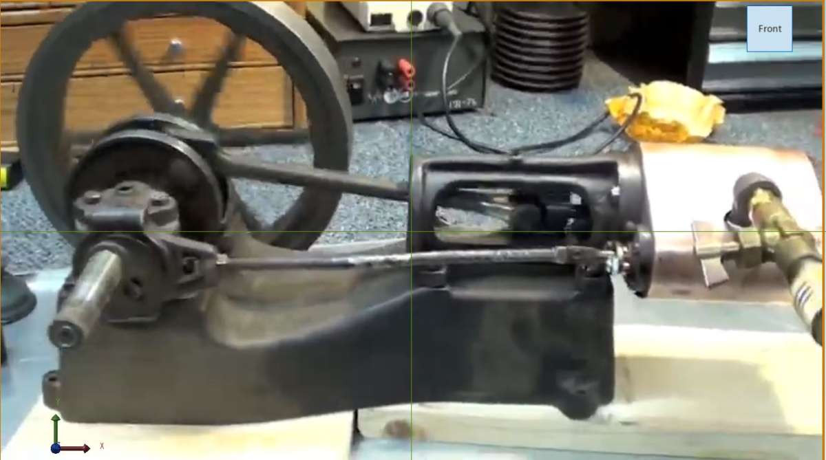

                I suppose Rod is the closest as PM Research do make an oil filed engine as well as their #6 is said to be based on this engine.
                Mine will be a half scale of the 1/4HP A J Weed engine of 1895 that was sold in several sizes from 1/8 to 2 HP by Chas A Strelinger and Co. I’ve not seen the PMR drawings and have just modeled mine from some videos of the restoration of one of the engines, this is a screen shot that I took my sizes from combined with quite a few that are given in the old Strelinger catalogue
                Watch out for a build thread coming to a forum near you soon!

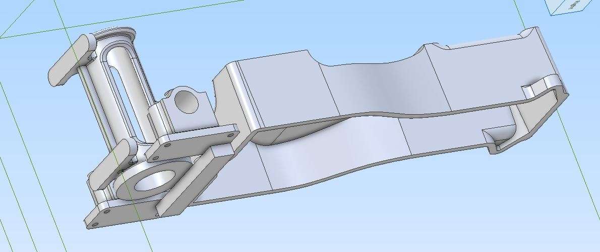

                          In the build thread of this engine Adrian said
                          On 25 March 2025 at 07:22 Adrian R2 Said:
                          Looks more aerospace than Victorian. With what you now know about 3D metal printing, could this base have been economically produced in a batch with the slide, and possibly other parts?
                          So I have had a bit of a play.
                          If printed the bed would be better hollow as you would get on a casting so I used the “Shell” function in Alibre to remove the bottom face and leave all the walls 3mm thick, all holes were deleted. I then created a STEP file to upload and these are the costings, all include taxes and delivery
                          Aluminium SLM Printing
                          1off £75, 2 off £66ea, 5off £59ea and 10off £57ea
                          Aluminium DLMS Printed (same process as the trunk guide above)
                          1Off £135, 2off £107ea, 5off £92ea and 10 off £87ea
                          Aluminum CNC cut from 6062, Did not have the hollowed out underside for this as it would be an unnecessary cost
                          1off £128, 2off £95ea, 5off £87ea and 10off £84ea
                          By way of comparison, the Stuart No8 Sole Plate is about the same size and with VAT and delivery would set you back £90.50. So the SLM would be cheaper and likely to be as good a finish as your average ME casting. paying a bit more for DLMS or CNC is not massively more and if you grouped together with friends or sold on the extras all could be a similar price to a commercial casting.
                          Obtaining the weight from Alibre which came out at 420g for the hollowed out version I could probably get change out of £30 if I made a pattern and had it cast in iron and posted back to me.
                          As for grouping parts together, I tried that with a few linked by a simple sprue
                          group
                          In Aluminium DLMS £132 for one print or in Stainless DLMS £220 again for one print. Quantities would give similar cost savings to the single part. might be cheaper if the trunk guide were horizontal as it would half the number of passes the machine needs to make though I’m sure at the other end they would group several peoples jobs together to get the best productivity out of the machine.
                          So probably not something you would want to use all the time but if the part could not easily be made by other methods it would certainly be worth giving metal printing or even CNC services a go particularly if you could make use of the multiples. Things like castings that would have used complex cores which would not be easy to get at with a milling cuttre or fine fins like you get on an aero engine would be the type of job that this method would suit.

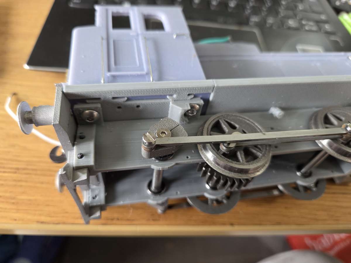

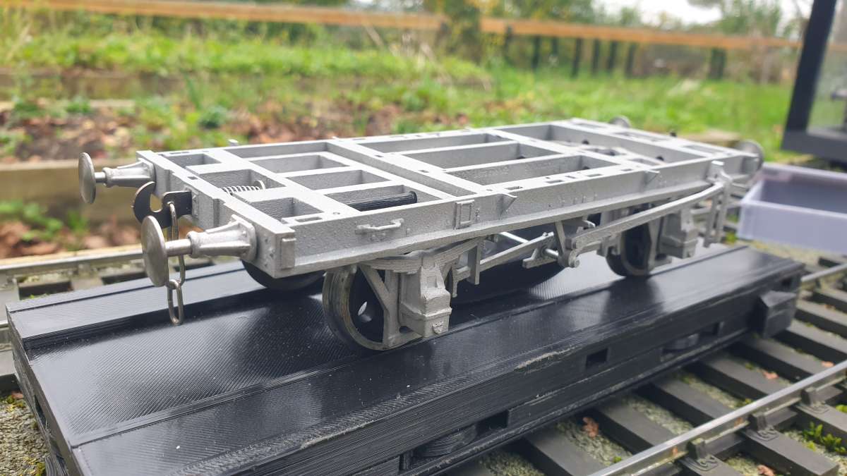

                                Norman Millier
                                  @normanmillier89056

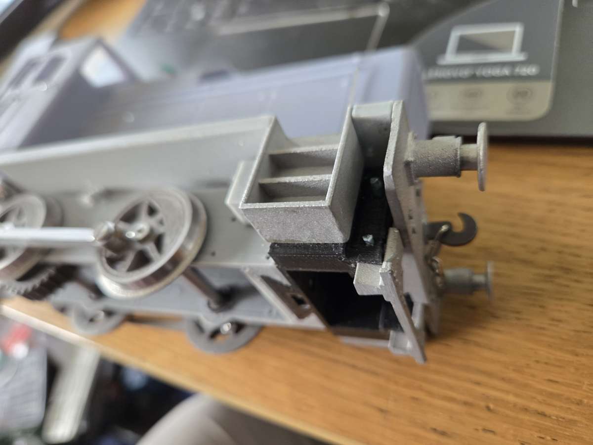

                                  I have had quite a few things printed via CraftCloud now. This is the gauge one class 01 shunter I have been designing for some time. Plastic parts – chassis, bodywork and cab – I print myself, but the wheels and jackshaft weights are printed in stainless steel (wheels have been skimmed in the lathe), while the buffer beams, buffer heads and steps are printed in aluminium.
                                  On CraftCloud the pricing is somewhat odd, for smaller items there must be a minimum price which means that often getting four or five of the same item costs the same as one.  Spruing items together is useful but I understand the detachment and cleaning process is pretty brutal so I make the sprues fairly robust, and I keep the items in similar orientations. When I have tried to have a large number of different items combined into one they have been rejected.
                                  20250419_18015820250419_180150
                                  #794155
                                    They look to have come out well and probably a lot crisper than cast wheels would have.
                                    I like the way that you have dovetailed the frame/buffer beam joints.

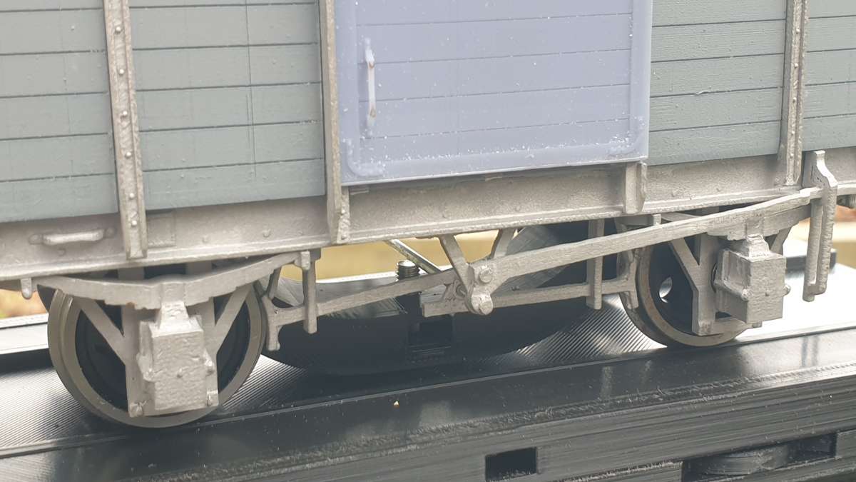

                                      I think the wheels worked out somewhat cheaper than castings would have been, and pretty clean.  The design is a mass of dovetails, which is fine when joining metal to plastic, but I think the surface roughness of the metal prints would make it difficult to rely on dovetails.
                                      Generally I have used metal for parts which seem vulnerable, hence the steps and buffers.
                                      I have done some wagon underframes in aluminium – along with the brake gear, axleboxes, buffer stocks.  They are a lot more satisfying than plastic, and the brake gear is far stronger. Easy to tap and screw together as well.20241102_105858
