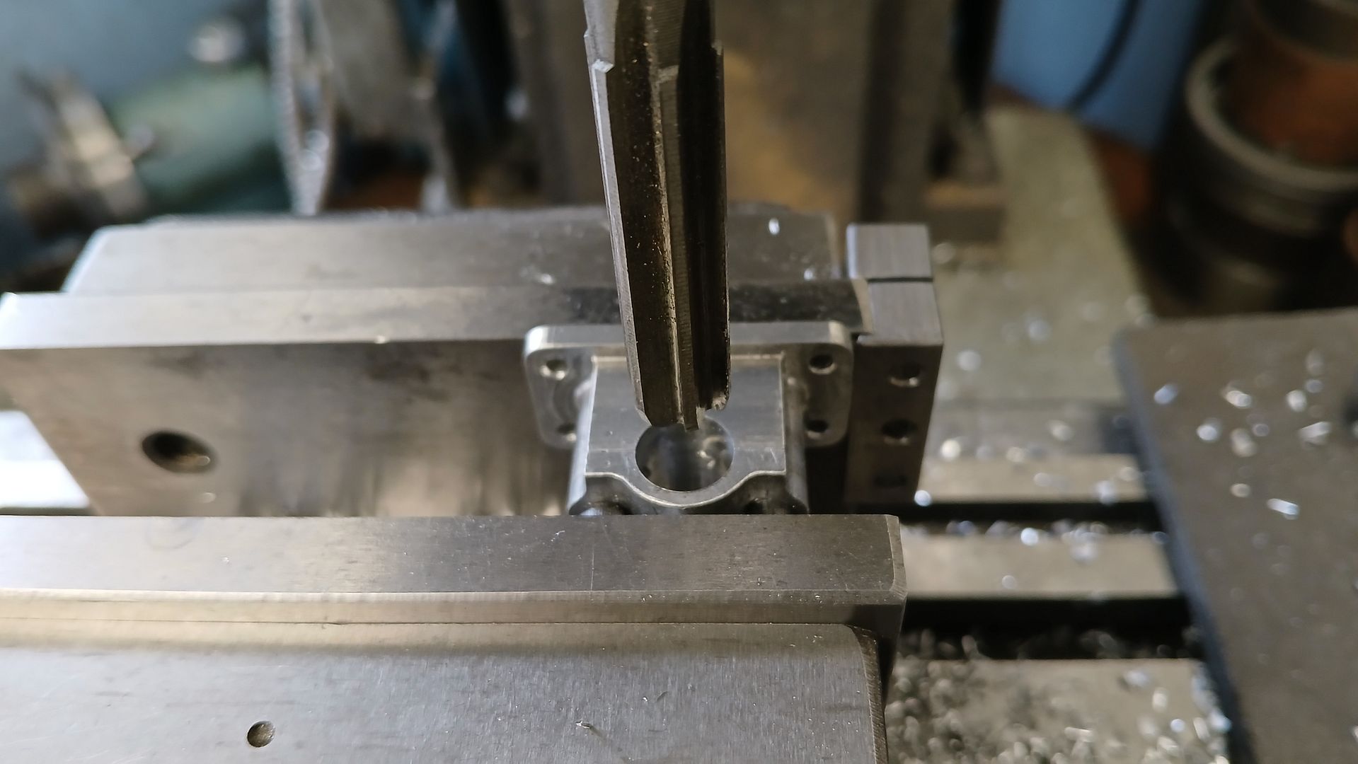

                      For tonights entertainment I will cover the bearing pedestals and their caps. The original I am replicating used Babbit for the bearings but I will turn mine from bronze so the pedestals are a bit narrower to allow for flanges each side of the bearing.
                      Two x two blocks of 6082 were roughed out oversize on the manual mill and then located in the KX-3s vice. First I did the hump back profile and boss of the caps followed (not shown) drilling the clearance holes.
                      The pedestals were then located – I tend to use the top centre of the stock a lot as my datum. The basic shape cut with a 4mm 3-flute ali cutter leaving 0.3mm still to come off. The holes were then drilled and in the case of the top two tapped M3. Canging to a 4mm dia cutter with a 1mm corner radius to leave a fillet around the bottom I contoured the pedestal and then screwed the cap in place an ran the contour again at a different height which ensures all the edges match up and are perfectly flush.
                      Back to the manual mill to remove the excess holding material from the bottom of the pedestalls.
                      Then with the caps in place I drilled and reamed for the bearings. Should say 9.8mm drill and reamed 10mm, it’s the crankshaft that is 8mm! No photos of the bearings as they are just bobbin-shaped bits of bronze

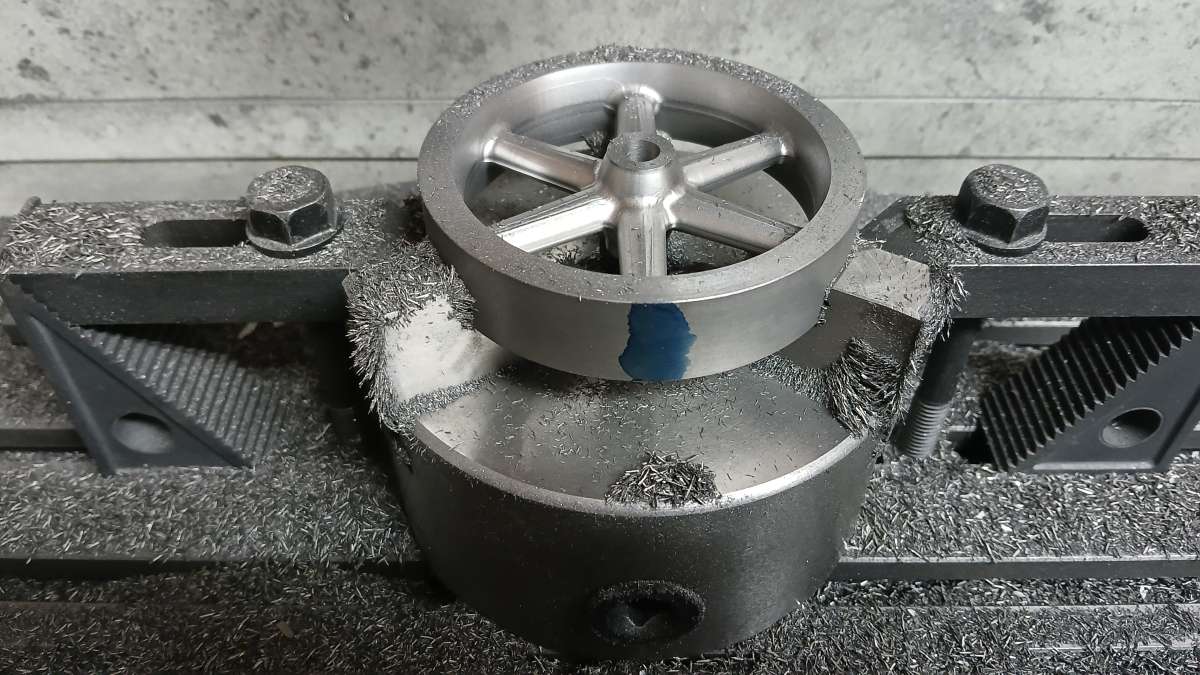

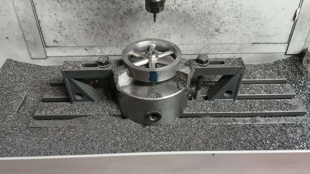

                                    Swarf production continues at a pace. This time it is the flywheel which was cut from a 25mm slice of 95mm dia cast iron bar, in fact m-Machine sent me 28mm so even more swarf! As I usually do I started on the lathe machining the OD, one side and boring to fit the crankshaft then flipped it over to face the other side.
                                    Then over to the CNC to form the spokes. You are probably getting used to this by now but an adaptive tool path was used to remove most of the waste material
                                    Then a scallop path with a 4mm ball-ended cutter to finish it off. The two were repeated for the second side to complete the CNC work.
                                    Those with a fear of getting cast iron swarf on their chucks and machines should look away now as this is what 40% of the bar now looks like with the remaining 60% as swarf. That was just the CNC work, probably more like 25/75% if finished item compared with supplied stock.
                                    After a quick bit of file work and a tickle with the Dremel to remove machining marks and give a bit of “casting” texture this is what the finished flywheel looks like. The engine I am basing mine on did not have the original flywheel so I have gone with something fairly chunky which seems to suit the rest of the engine which was made to do work rather than be looked at.
