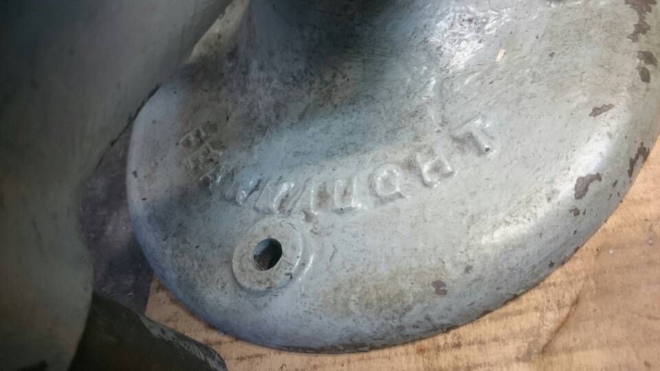

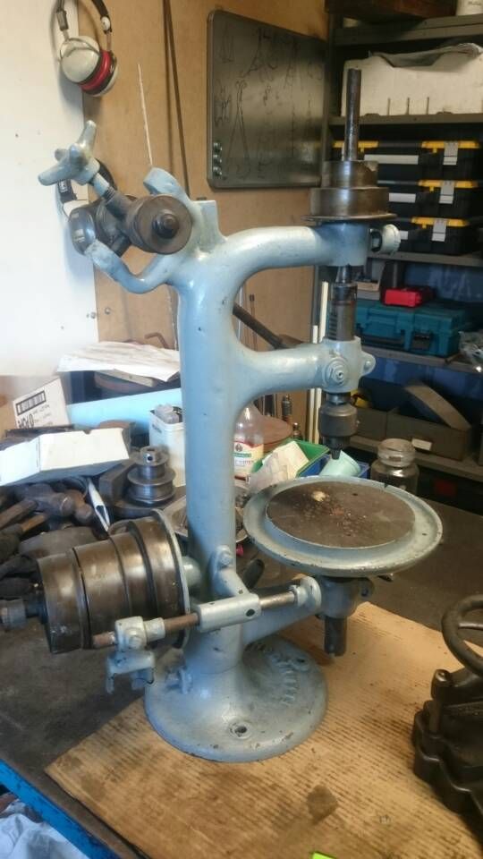

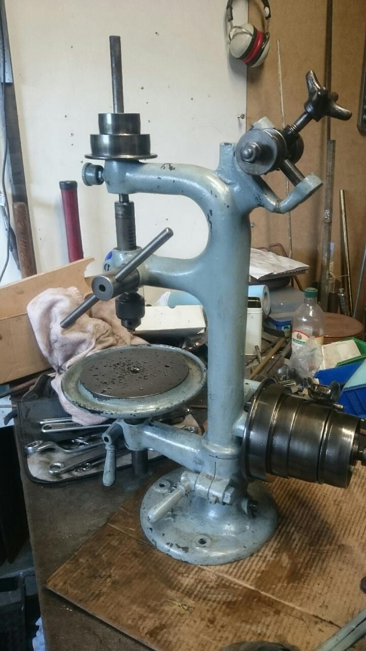

      I'm setting up a line shat to run three of my drills. One of the drills has the embossed lettering "Fearnaught" so far I can't find anything on the maker.
      Fearnaught
      Fearnaught Drill

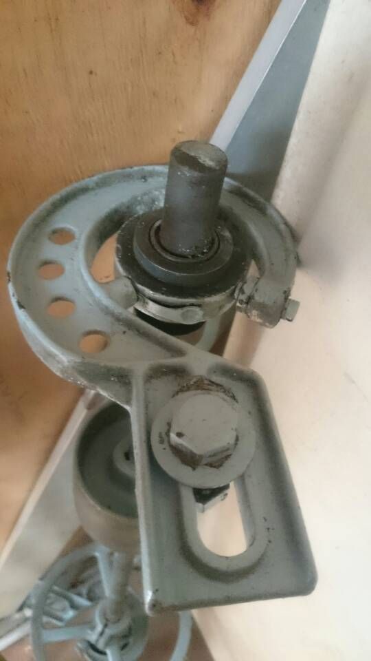

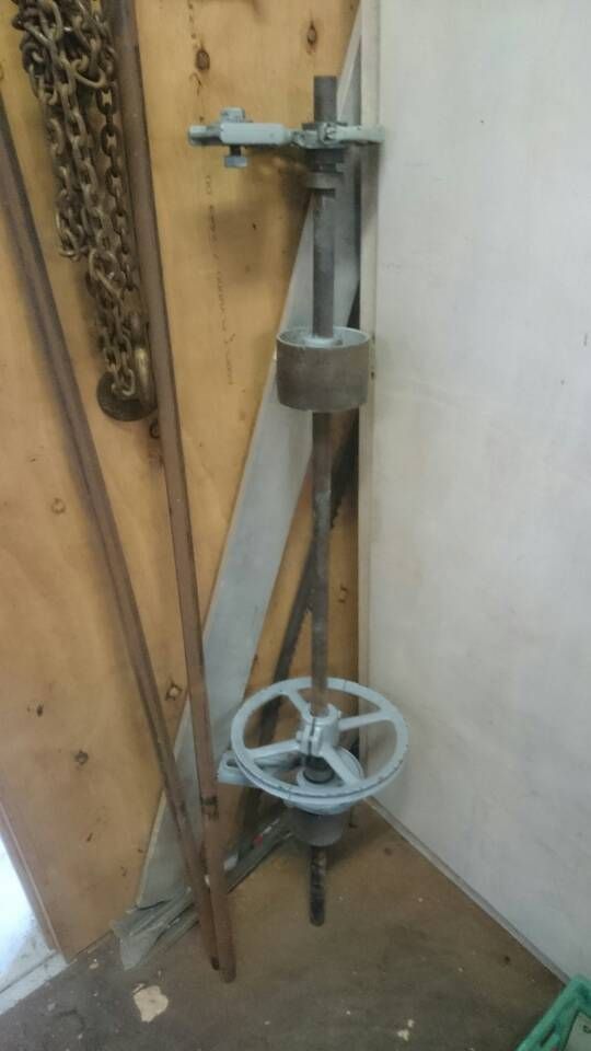

      My line shaft has these hook hangers. Do they normally just get bolted to a roof beam or is there a bracket missing? I haven't seen this style before.
      Hook Hanger
      Line Shaft
      I'd like to get some flat belt, and some more line shaft hangers etc to set up some more line shafts & jack shafts. Sources in Australia?

                                    So does anyone have a picture of what the wall bracket looks like that goes onto the hook hangers??
                                    The hook hangers slide on the brackets to get the levelling of the line shaft.
                                    #202122
                                      I did look at my reprint of the old Strelinger & Co catalogue but none of their brackets would suit your type of plummer block. Most of theirs can use a bracket (slotted) for horizontal adjustment but the vertical is within the actual plumber block.

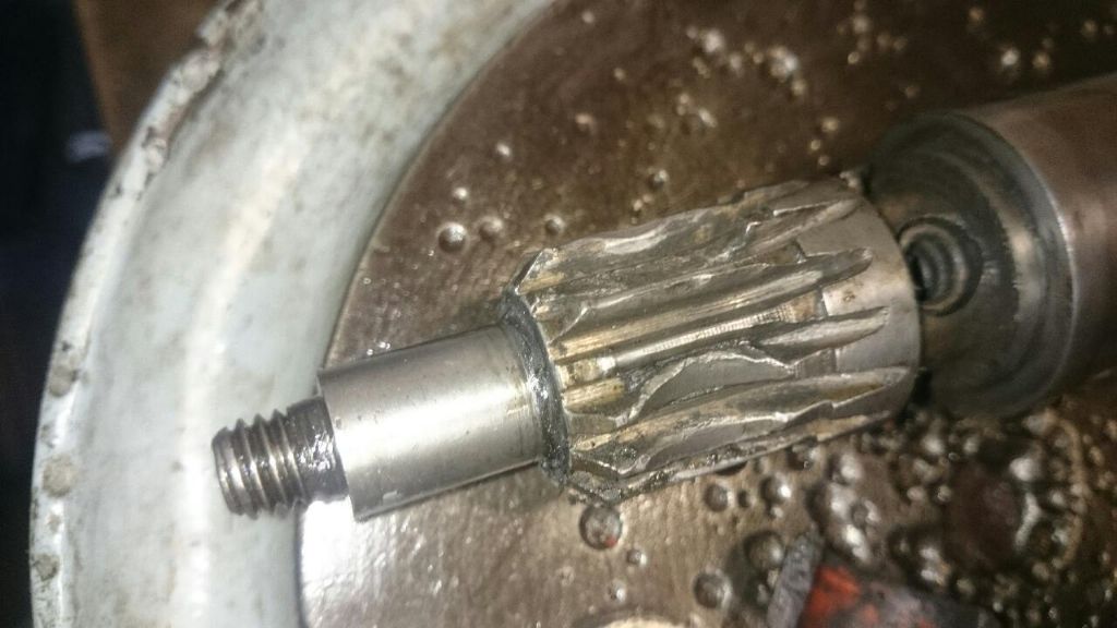

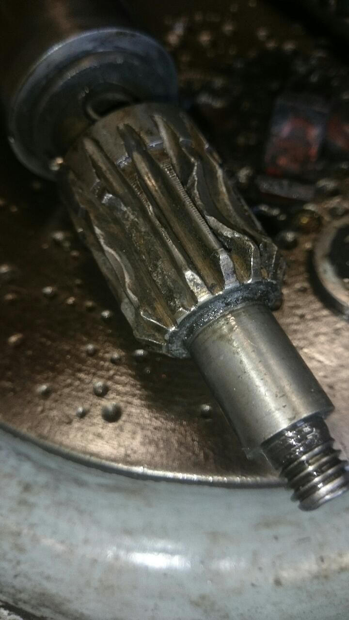

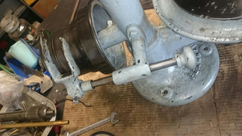

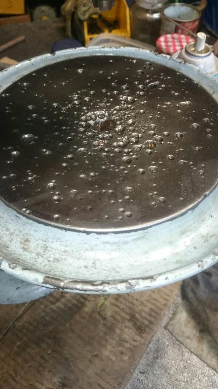

                                              How do you do this to a small drill press?
                                              #202584
                                                surprisecrying
                                                If that's the pinion: what on Earth does the rack look like ?
                                                #202596
                                                Dsel
                                                  @dsel
                                                  Without removing the rack, but sliding it up and down, I can't see any damage. I can only suspect that the rack is hardened the pinion isn't. Other than using the drill as a press I can't see how they did that damage, even then it would have taken some talent to do that.

                                                      I hope you are going to have a proper setup with individual machine fast and loose pulleys for the belts to run on the line shaft.
                                                      In my youth I remember a large press tooling workshop, all manner of punching and forming machines. One I remember had been refurbished in 1911 or so the plate said.
