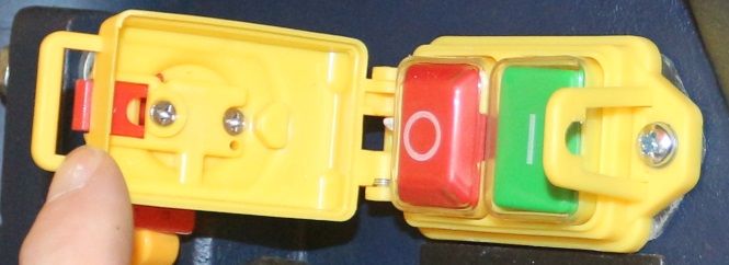

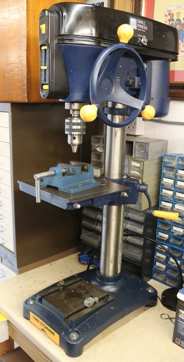

        My second hand bench drill of oriental manufacture has run well since I bought it until earlier this week when it died on me. I suspected the machines on/off switch had gone faulty as it had been playing up for a couple of days so I bypassed the switch and found the machine ran perfectly OK using the mains wall switch as an on/of switch
        I ordered a replacement switch which is identical to the one on the machine right down to the correct part number KJD17B and described as "Start Stop Switch No Volt Release 5pin Switch NVR 2HP/16A with Emergency Stop". The ebay vendor is a business seller who sells lots of these switches.
        The new switch arrived today and using my sketch and photos of originally wired switch I fitted the new one this afternoon.
        The problem now is that the drill will only run while I hold the green start button down, as soon as I let go the drill stops. Have I been sold a faulty switch?

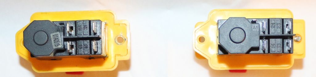

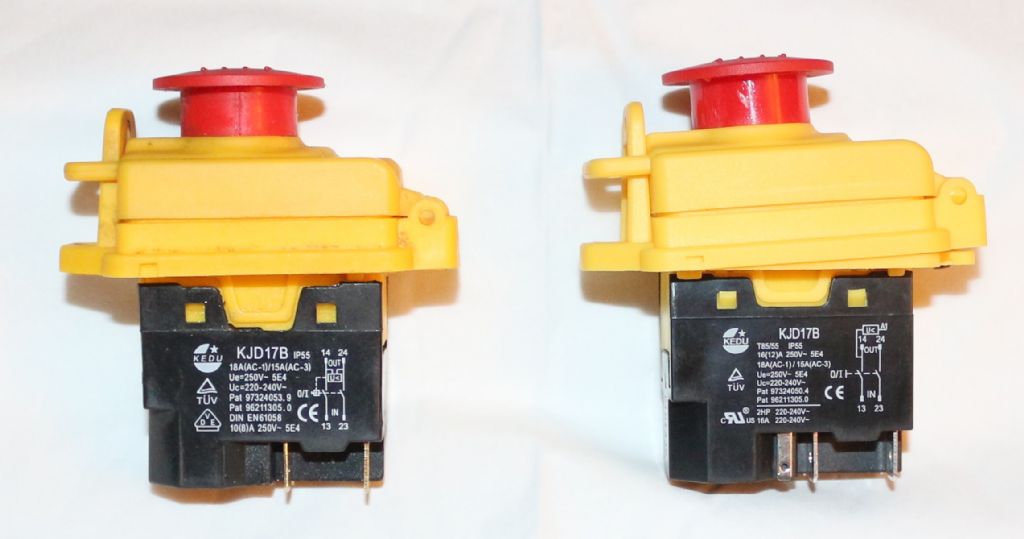

                    I appreciate the help being offered here. Les, sorry but my OP was incorrect. I have been up the workshop and disconnected the new switch . The NEW switch has 5 pins unlike the old switch which had 4 pins. The new pin is labelled A1.
                    In the following two photos as requested the new/replacement switch is on the right.
                    Referring to the numbered pins on the right hand (old) switch the original wiring was 24 blue – 23 blue & white – 14 brown – 13 brown & white where the thinner white piggybacked wires on 13 & 23 probably connect to the laser spotter fitted to the drill.
                    So the odd man out looks like pin A1 on the new switch. Where do I connect A1 to ?

                      On the basis that there are no interlocks fitted and you have no spare wires, the A1 connection needs connecting to 24…..
                      Presing the Go button makes the contacts for the Live and Neutral poles, there is already a connection for the coil made internally connected to the Neutral side. Connecting A1 to 24 completes the circuit for the coil and holds the relay in providing the latching action of the switch.
                      Should the mains be disconnected at the source, the latch drops out requiring a reset by depressing the Go button again……..upon re-instatement of the supply….hence a no volt release function..
                      I'm sure someone will be along to correct any errors I've made……..

                        The diagram I was looking at is the same as your new switch so linking A1 to terminal 24 should solve your problem. (As John has already said.)
                        Les.

                          Many thanks to the experts in the "sparks" section hereabouts. A1 to terminal 24 did the trick and my drill is now back in action. Much grateful.
