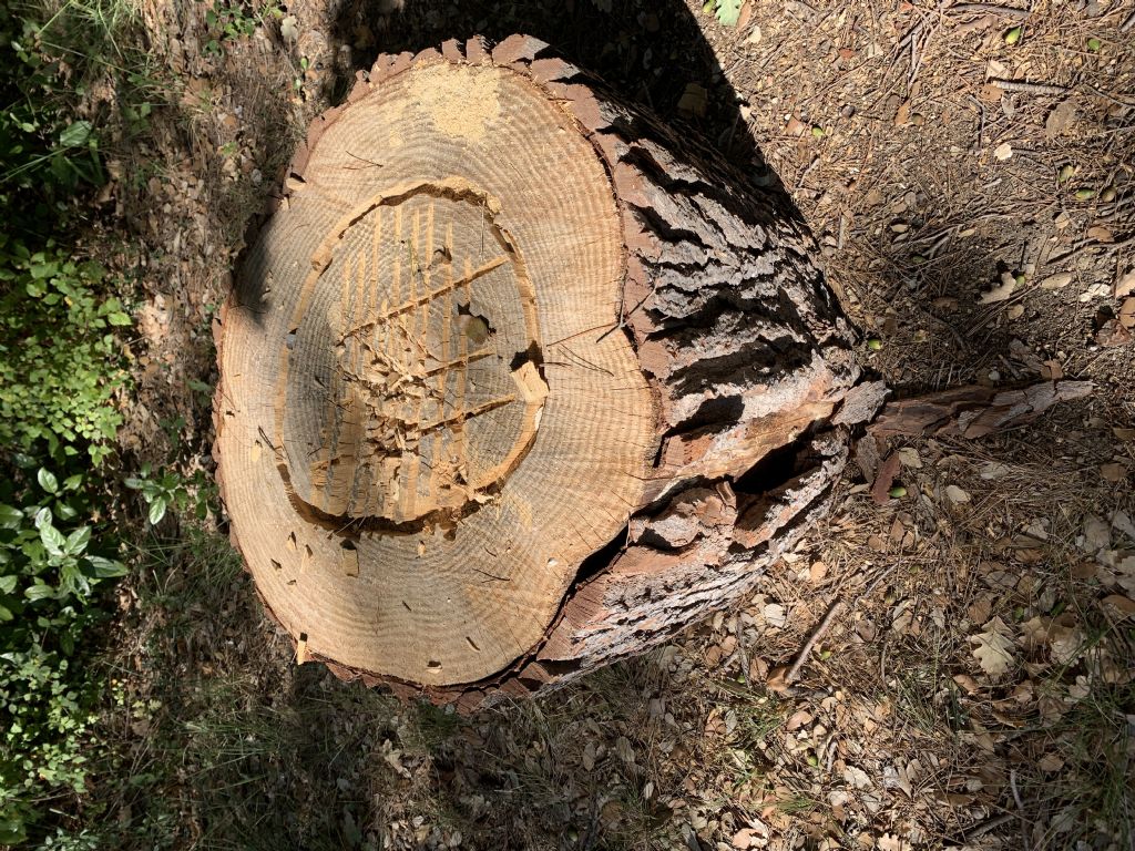

      Earlier this year, we had a large fir tree chopped down and the trunk was sliced into a number of "cheeses", some of which were scattered across the garden on request from Madame.
      The subsequent request is to excavate the cheeses to provide a plant holder surprise.
      The wood is reasonably dry but my attempts with a drill and the largest spade bit I could find are slow and not effective. A router doesn't reach down far enough. My chain saw is only using (dangerously) the tip. I have contelplated a mini tct wood saw blade in an angle grinder but not proceeded any further.
      Faced with a similar problem to similar dimensions (roughly 0.5m across, depth to say 30cm), how would "YOU" proceed…..?
      BTW, once one is completed, I have a further 6 to do…..
      All ideas welcomed!

          You can get wood caring disks for angle grinders. Might be worth a try. Radom example from web:

            A multi tool would get you in there but it would be a long job
            Weaken the hole with a long drill bit making x50 holes then carve it out with the chainsaw?

                    I think a large auger bit would chomp its way through. Use a chain drilling strategy to clear the area and then chisel or burn out what's left.
                    Martin.
                    #619712
                      25mm SDS+ Auger bit and stitch drill a ring around the diameter hole you want. I would go right through probably coming in from each end as it will be quicker and easier than trying to pig out the waste in the middle. If that is not an option then lots of auger holes to remove as much as possible
                      Even with an decent size SDS+ drill you will need to apply a reasonable pressure as the screw point will not draw the bit in to end grain as well as it would side grain.

                        A home-brewed ‘core drill ‘ might do the job.
                        By which I mean :
                        a suitably large diameter steel tube, with slices cut from a TCT circular saw blade welded onto the end.
                        It doesn’t need to be very accurately, or prettily, made

                            Perfect job for an adze, or an arbortech carving disc in an angle grinder.

                                Wood is more difficult to drill into end grain than sideways.
                                A smaller say 1/2 in standard twist drill will do better than a spade or auger bit. The smaller holes will go in quicker than large holes so overall time saving. be careful not to apply bending pressure to the bit.
                                Another approach is a circular saw with a small blade. Tack a stop block over to one edge so the saw is controlled and hold it onto the work at 45 degrees, then lower it into the wood, keep moving round and eventually you get a shallow circular bowl, This gives you a better surface to start drilling outwards at 45 degrees, finally chiselling down wards around the rim.
                                If you can make a starter hole and dry the wood a bit you might be able to start a little fire in the middle and control the burn.

                                    Chainsaw, used carefully. a smaller one will be safer than say a 20" one for this job.

                                        Thanks all for your thoughts and ideas. I think I will proceed with the wood carving route. My afforts to date using drilling methods have proved laborious and slow, hopefully this will allow some more speed.
