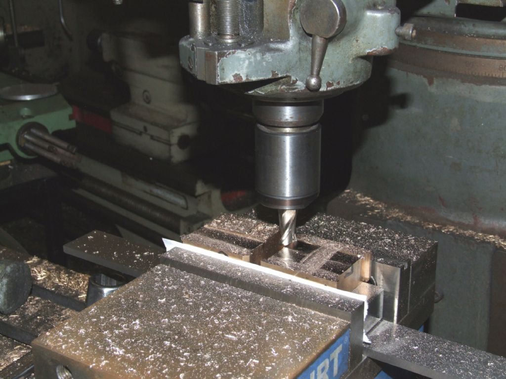

                  Hmmmm, if I’m using a cutter to face a surface I always cut in both directions, on alternate passes. I also use a large stepover, usually about 75-80% of the diameter of the cutter. This is true for both manual and CNC milling. Like this: bearing blocks in gunmetal, 20mm slot drill, depth of cut about 2mm, stepover about 16-17mm, cutting both ways:
                  Ah well, summat else I’m doing all wrong.
                  When using a cutter predominately on its side faces then I’m much more cautious about climb milling; only for materials that take a better finish when climb milling, and then only small depths of cut, say less than 20 thou. That’s for manual mills, for CNC anything goes.
