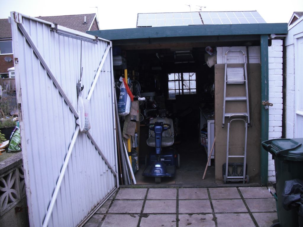

      Hi, my old garage wooden doors are rotted out and need replacement. I have been looking at electric roller doors and have a few questions. I know that carador are good quality and they are only down the road from me. But nearly £4000 for a single door is a bit much. I have seen doors for sale on eBay and Facebook, but think that these are of Chinese origin and any warranty would be worthless if called on. So can anyone point me in the direction of a good quality insulated door for a single garage which they had fitted and they are happy with. Thanks.

                                    When my "UP-and-OVER" door mechanism failed I did a really cheap repair. Works for me!
