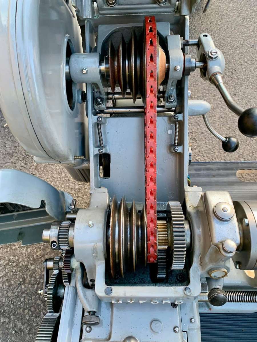

      Hi, I have an early (1955) Myford Super-7 and wish to replace the v-belt on the spindle/counter-shaft.
      The descriptions are pretty clear regarding the spindle disassembly; but I can’t find anything on disassembling the counter-shaft with the early type clutch… does anyone have any pointers?? TIA
      IMG_4223

        You could try the Myfords Lathes group
        H
        #768661
        IanT
          @iant
          PM me with your email and I’ll send you the relevent parts of the Mk1 manual as a PDF
          Regards,
          IanT

            I did this job many years ago and do not remember it causing any problems. I have the identical model S7 as you (SK2142) and used the layshaft cross section shown in the manual (“notes on installation and maintenance” publication No S.709) that Ian T is offering to copy to help. My reason for stripping the shaft apart from wanting to fit new belts was that the needle bearings were beginning to make unwelcome noises. I replaced them with Oilite bushes which is regarded as a retrograde step in some quarters but has worked OK for me for the last 30 years or so.

              ChrisLH… many thanks for your insight, Ian T has indeed copied to me pages from the earlier manual.
              I have a later ‘Super-7’ manual, but it differs in both page & diagram numbering & contains less information regarding the earlier ‘Mk-1’…. so many thanks to all for contributing toward my quest!!
              Elsewhere I had sought this information, and was questioned as to ‘why I would want to go to such lengths; just fit a link-belt’ …. Well my answer is simple; I want to keep my Super-7 as close to original as is practicable, & in taking mine apart I am looking forward to learning allot more about the machine.. 😎🇬🇧👍

                      Only just seen this request so to make clear. The shaft must be removed towards the tailstock as there is a slight shoulder involved. The needle roller bearings had to go on my SK1711 but instead I replaced the lot with a modern clutch many years ago and not looked back.
                      Chris H, you have the correct/original cast iron clutch. Never heard of the moped brake replacement but the original clutch is very troublesome.

                        I believe that the “moped brake drum” adaptation for a clutch is a separate (earlier?) entity from the so called Mk1 clutch comprised of a cast iron horseshoe expanded into a recess bored in the countershaft large pulley.  I have a S7 of the same vintage; this has a worn but usable “horseshoe” clutch which I have adjusted so it doesn’t let go.  In other words I have defeated the clutch operation to achieve a reliable drive from the countershaft.
