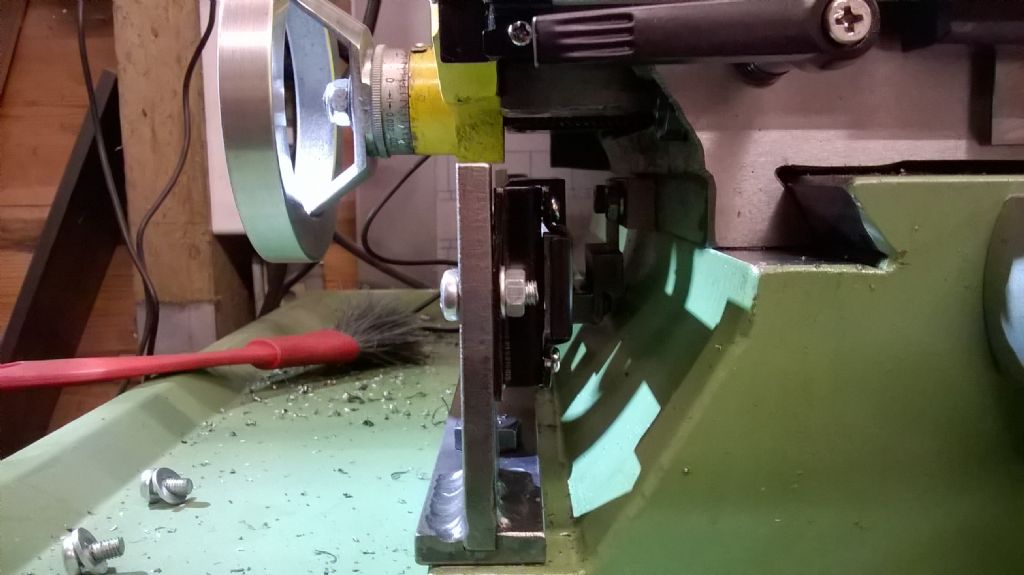

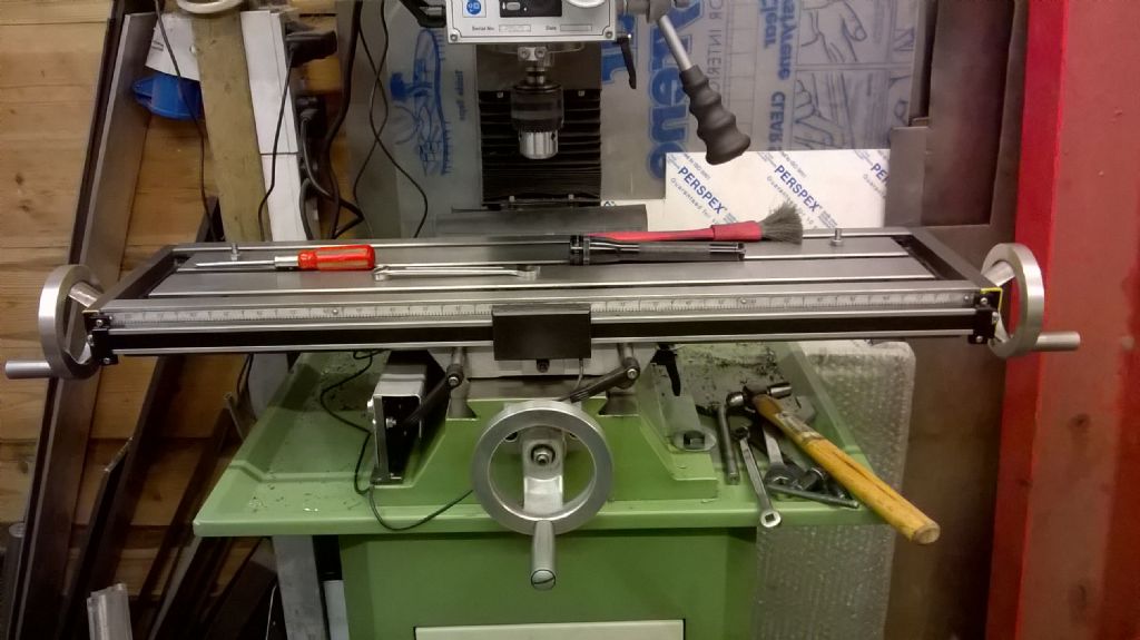

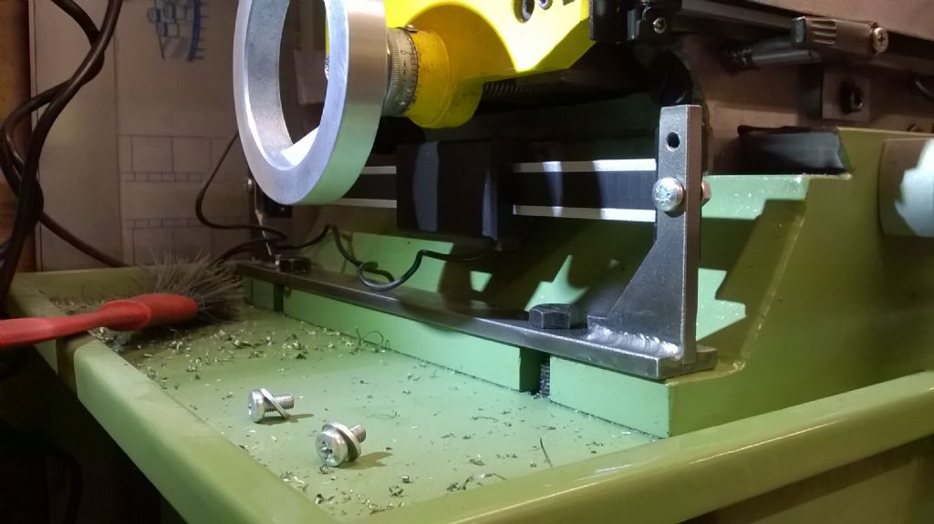

      I have bought a Warco RF-25 Drill / Mill and I bought some Digital Readout with Remote Display from Arceurotrade
      I can see how to fit the X axis but I cannot see how to fit the Y Axis. Has anyone fitted these to this type of Mill and could they post some pictures of how it was fitted.
      I can post pictures if required.

          I have fitted an Arc DRO to my RF25 (Not a Warco but similar) I will try to get some photos and post them later.
          #209308
          Christopher Taylor 1
            @christophertaylor1
            I have fitted a DRO to my Warco WM-16 which may give you some ideas. Photos herewith.

              here are the photos

                  I can see the photos in your album. Thanks for posting them

                    Have a similar set up on my WM 16, look at my album for pics.

                        Thank you all for your help. I will get some material and hopefully get them fitted shortly

                          Once again thank you for your help I now have the Y Axis installed and the X Axis requires 2 longer screws to install it and both will be working.
