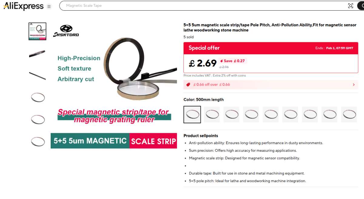

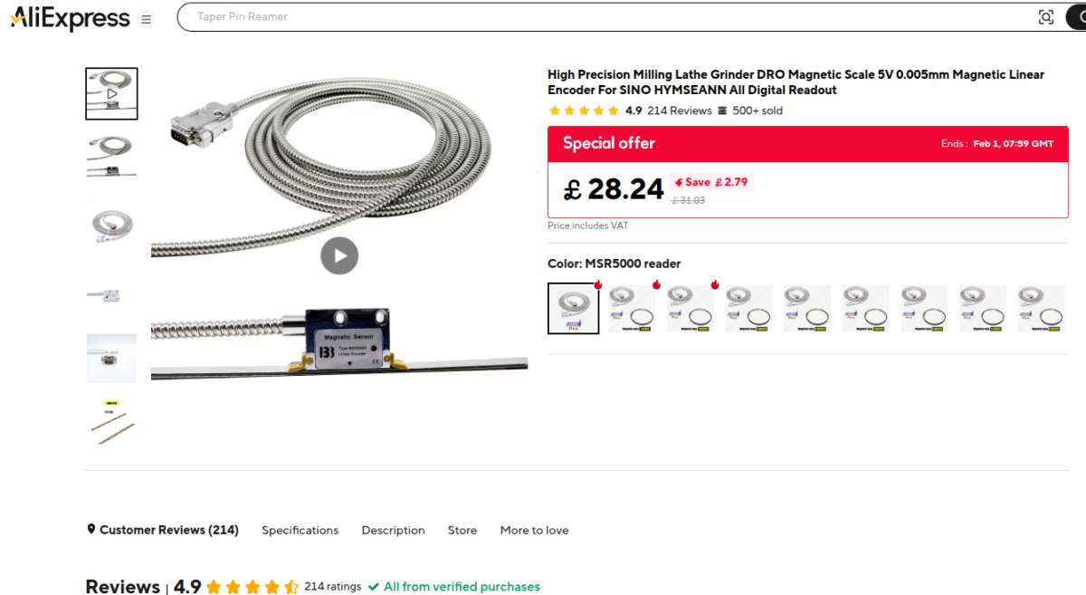

                  re. Magnetic scales, I’ve just fitted one to the cross slide of my lathe (I used a glass scale which I already had for the Z-axis). It was a cheapie from Aliexpress:
                  Screenshot_20260124_204747
                  Screenshot_20260124_204544
                  They claim 5 micron, and that’s seems to be pretty much the case – turning the handwheel rapidly can reduce the accuracy, usually by losing 0.01 to 0.02mm, but slowly moving on, say 0.1, will show it reverting to the correct reading. For me, that’s absolutely fine, and the price is certainly attractive compared to the (presumably) higher quality stuff from Machine-DRO.
