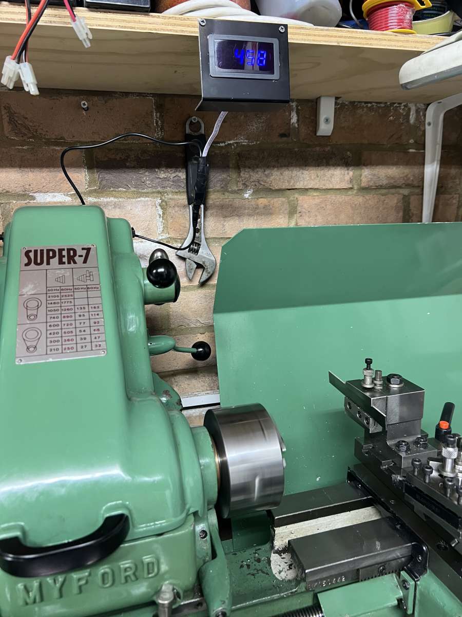

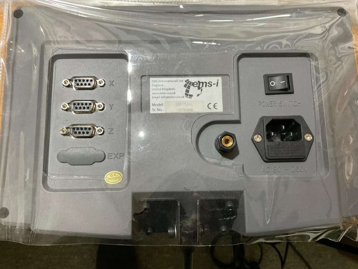

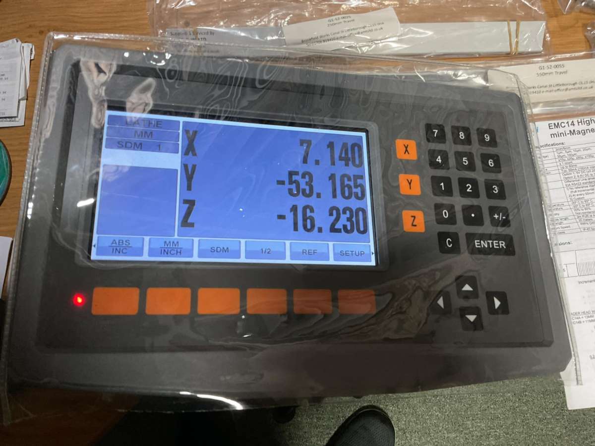

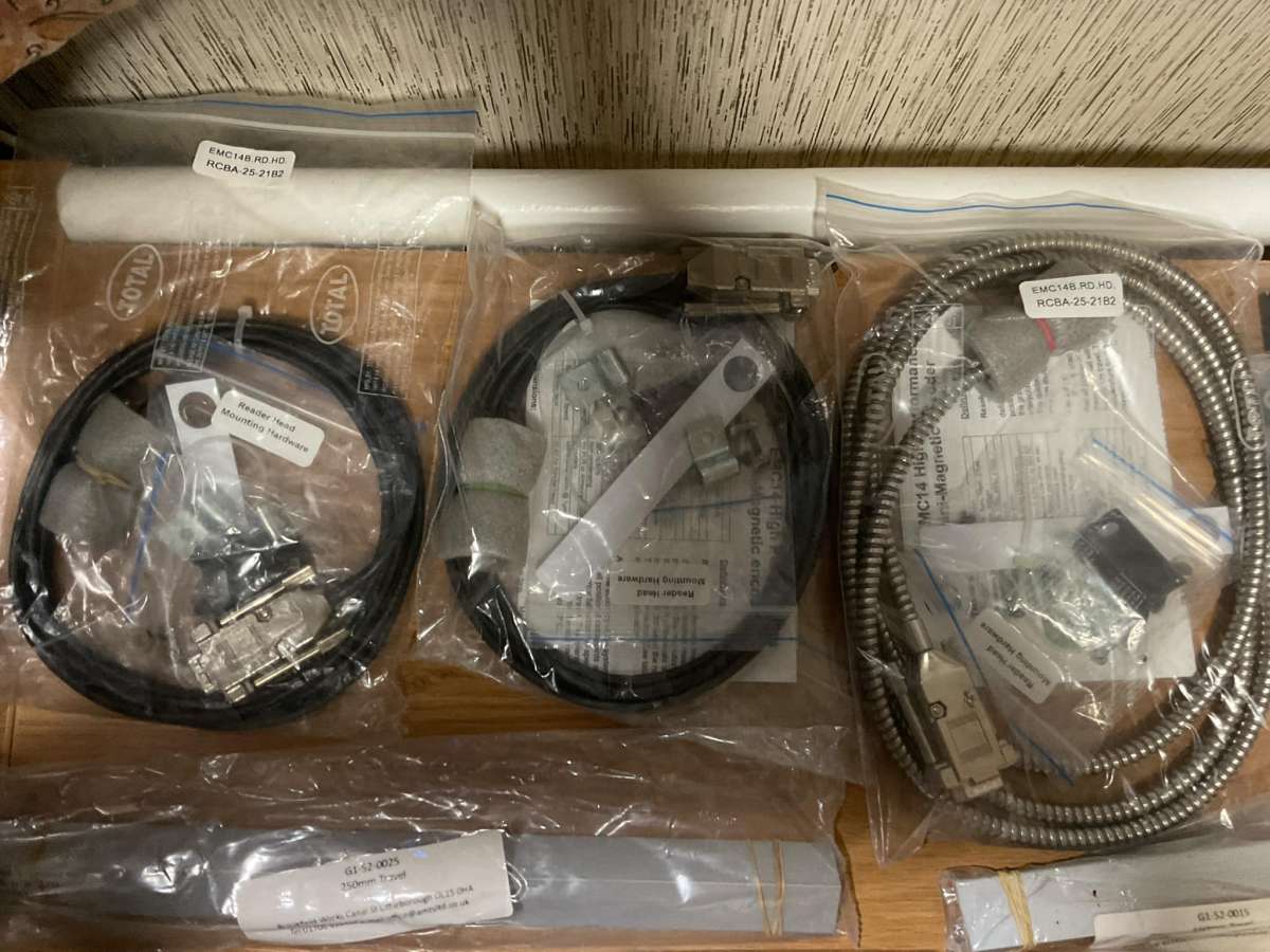

      Hi all I recently purchased from a guy on a Myford Facebook forum a brand new never used EM 750 series DRO by ems international now currently owned by AMTS-NW
      does anyone have experience of owning one of these DRO, and would like to know what they are like
      I want to install it on my Myford super7 and want to embed the optical slide on the underside of my cross feed slide if this is possible by milling a channel out, any info would be greatly appreciated

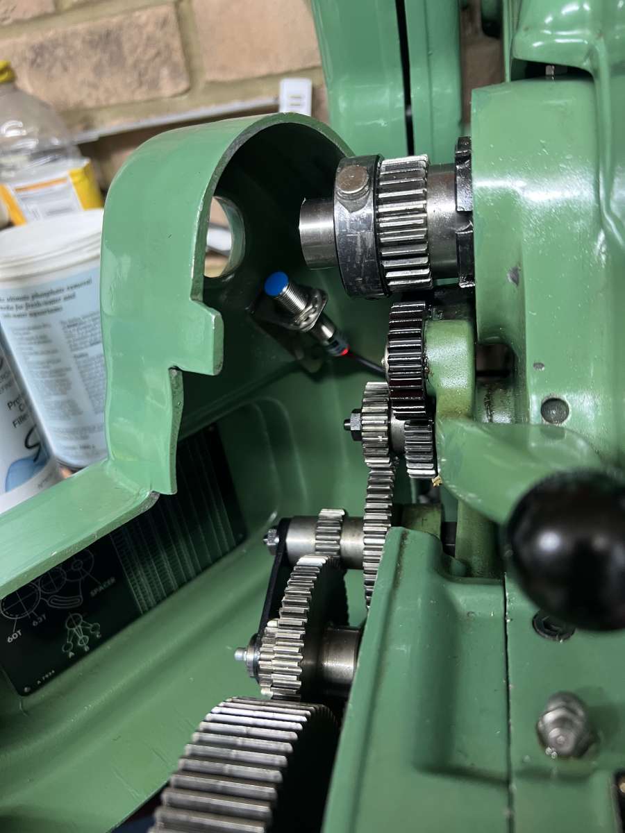

      i recently installed a tachometer which seems to work great, now I’ve just got to learn how to use the lathe properly haha IMG_4806IMG_4805IMG_4804IMG_4801IMG_4802IMG_4803

        There is not enough height to have a glass scale under the cross slide. The best you could do, is to make an extension for  the back of the cross slide and have it all extended out the back of the machine. Otherwise it will be installed on the tailstock side of the cross slide. I would avoid installing on the chuck side of the cross slide. I put in the magnetic type with the reader on the back of the saddle and the magnetic strip is also on an extension, like the MDRO one.

            Its not a glass scale it’s a magnetic one
            #761238
              Have a look here at the fully internal option, should give you an idea where the mag strips can be fitted although you may need to alter a bit as I suspect your read heads are a bit larger.

                    The DRO and it’s maker Electronica Mechatronic Systems are new to me.  Not the usual Chinese fare – EMS are an Indian company.    A quick look at the Manual suggests the DRO is feature-rich, which made me wonder if it’s over the top for a lathe?
                    It’s a 3 axis DRO, when a lathe only needs 2.  Though it will work fine on a lathe with only 2-axes connected, this DRO delivers full value on a milling machine or grinder.  As Graham has said the lathe is new to him, I assume he’s not got a mill yet?  If a milling machine is on the cards, and I recommend one should be, then a better strategy is to fit this DRO to the mill.
                    In the meantime, I suggest putting a temporary hold on gadget fitting.  More important, I suggest, to learn how to drive the lathe in basic form than for a beginner to start by fitting go-faster accessories.
                    • No harm in fitting a tachometer to a Super7 as supplied by Myford, except it has 14 fixed speeds of: 27, 39, 54, 77, 95, 135, 210, 300, 420, 600, 740, 1050, 1480 and 2105 rpm determined by the belts and backgear. As it’s not difficult to know how fast the lathe is spinning, a tachometer doesn’t add much value, so fitting one may have been a time-waster!   Tachometers are valuable on lathes with continuously variable speed control; maybe Graham’s Super 7 has been upgraded with a 3-phase motor and VFD, in which case his tachometer is useful.
                    • Whilst fitting a DRO to a mill is a no-brainer, they’re less obviously value for money on a lathe.   For example, in my workshop the dials are good enough.  Depends on what the lathe is used for though!  A DRO advantage is their ability to switch between metric and imperial on the fly, but this conversion feature is low value to me because I work almost entirely in metric. My rare need to work in Imperial is satisfied with a calculator.  On the other hand, a workshop obliged to constantly mix Imperial and Metric would save a lot of time and avoid mistakes by fitting a DRO.

                      EMSi used to be at several of the Ali Pally shows and ran an advert in ME at some time. I seem to think they provided the DROs that were fitted to some of the “new” Myfords again hidden ones.
                      Their read heads went smaller than those sold by Machine DRO and would have been the supplier I would have used had I got round to fitting a DRO to my lathe as I wanted to hide the cross slide and have summing of the topslide & carriage which their consols did.
