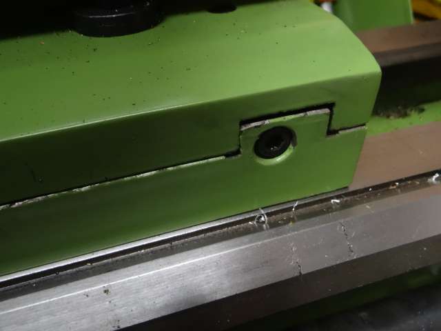

        The tailstock is adjustable so you can turn tapers.  Sounds like it needs centring.  On my 280 there are two opposing allen head adjusters on the lower rear of the base:
        DSC06971
        They’re turned in opposition to swivel the top of the tailstock.

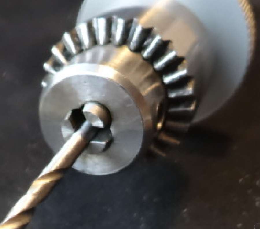

                    By coincidence I managed this blunder this morning:  nipping a drill off centre in the chuck.
                    nippedDrill
                    The photo is staged to highlight the mistake – in real life the error wasn’t so obvious.
                    Don’t trust anything, check.  Some twist drills I bought at a show were bent.
