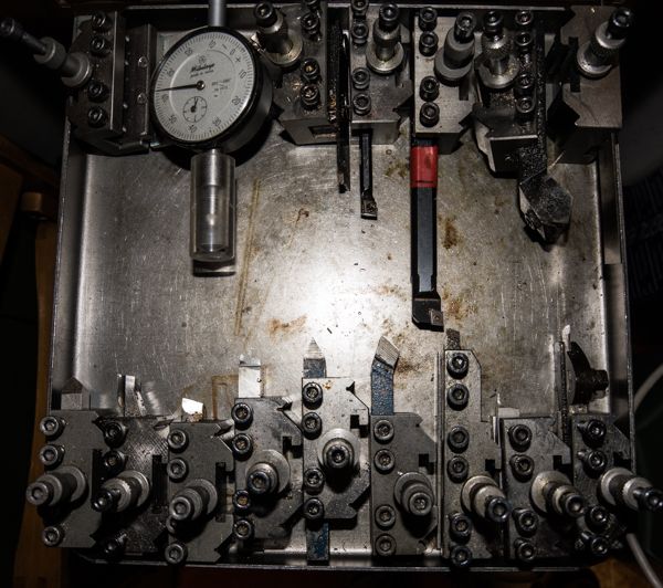

                                              You are right Vic in that the tangential tool is very easy to adjust for height. The essence the QCTP however is in the C hange part. Whilst I use the tangential tool for much of the time other tools are more tricky to get right. Once the boats are set up then tool changes are quick and easy.
                                              Here is my little selection:-
                                              Cheers
                                              Norman
                                              #171238
                                              Vic
                                                @vic
                                                Yes quite right, once set up you're only limited by the number of Toolholders you have. Nice selection Norman!
