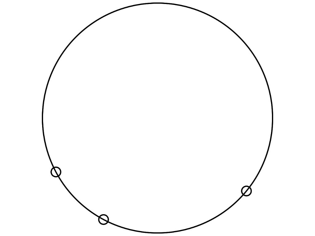

      Hi all
      I'm wanting to drill 3 holes in a triangular fashion on my mill with the PCD function I've already set up the work piece with the quill in the centre, The centre of the holes are 65mm equally distant apart from each other. Question is how do I calculate the diameter of the circle needed? I could do it on paper with a compass etc but I want it more accurate than that. I've had a look at the machinery's manual but cannot seem to find anything.
      thanks in advance for any help
      regards
      Paul

                                    Nick's excellent solution is for the simple case ie a circle defined by three points of an equilateral triangle. What's the solution when the circle is defined by 3 randomly placed points?
                                    A mathematical solution must be possible: I drew the example above with QCAD, but most other CAD packages can draw circles specified by three points.
                                    Please be gentle – maths doesn't come naturally to me…

                                        Posted by SillyOldDuffer on 11/10/2019 09:06:46:
                                        Simples!
                                        The Equation of a circle has three unknowns. Three unique points give you three indpendent equations. Three equations and three unknowns allows a unique solution for the centre and radius, with a bit of algebraic manipulation.
                                        Andrew

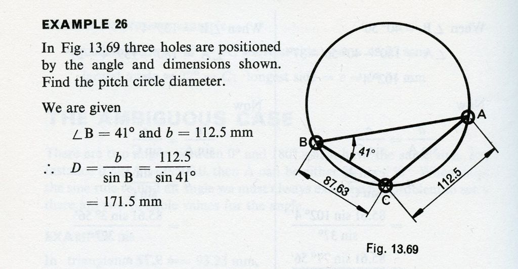

                                        #432788
                                        Nicholas Farr
                                          @nicholasfarr14254
                                          Hi S.O.D., I've found this in one of my books, but it does give a couple of dimensions and an angle, but you've asking about random placed points and I suspected it would involve Algebra as Andrew has said. However I could never get to grips with Algebra, which seems that MichealG's search is full of.
                                          Regards Nick.
                                          #432789
                                          Kiwi Bloke
                                            @kiwibloke62605
                                            I'd do it using co-ordinate geometry. Not sure if this is what Andrew is suggesting. I'm a lousy mathematician, and I bet there's a far easier way (no, not CAD).
                                            The perpendicular bisectors of two chords intersect at the circle's centre. You can easily find the co-ordinates of the mid-point of a chord and its slope. The equation of the bisector of the chord follows, straightforwardly. It's then a few small steps to solve the two equations of the two chord bisectors, to get the co-ordinates of the centre. The diameter is the distance from the centre to any of the three points. The equation for the circle follows.
                                            Incidentally, the radius of the circumcircle of a triangle, R = a / 2 * sin A, where a is the length of the chord opposite the angle (vertex) A. Sometimes useful…
                                            Oh, Nick just beat me to it…

                                              #432805
                                                Posted by Nicholas Farr on 11/10/2019 10:05:06:
                                                Regards Nick.
                                                This simple example has left me in the dust! I've confirmed it works by drawing it with QCAD but why is the diameter of the circle given by dividing distance AC by sin( 41° ) ?
                                                I don't understand the method. The calculation isn't solving the triangle ABC, or calculating the length of line AB.
                                                I can do trigonometry on right angled triangles, but ABC isn't right angled.

                                                  Dave (S.O.D), look up 'sine formula'. Not all trig needs right-angled triangles…
