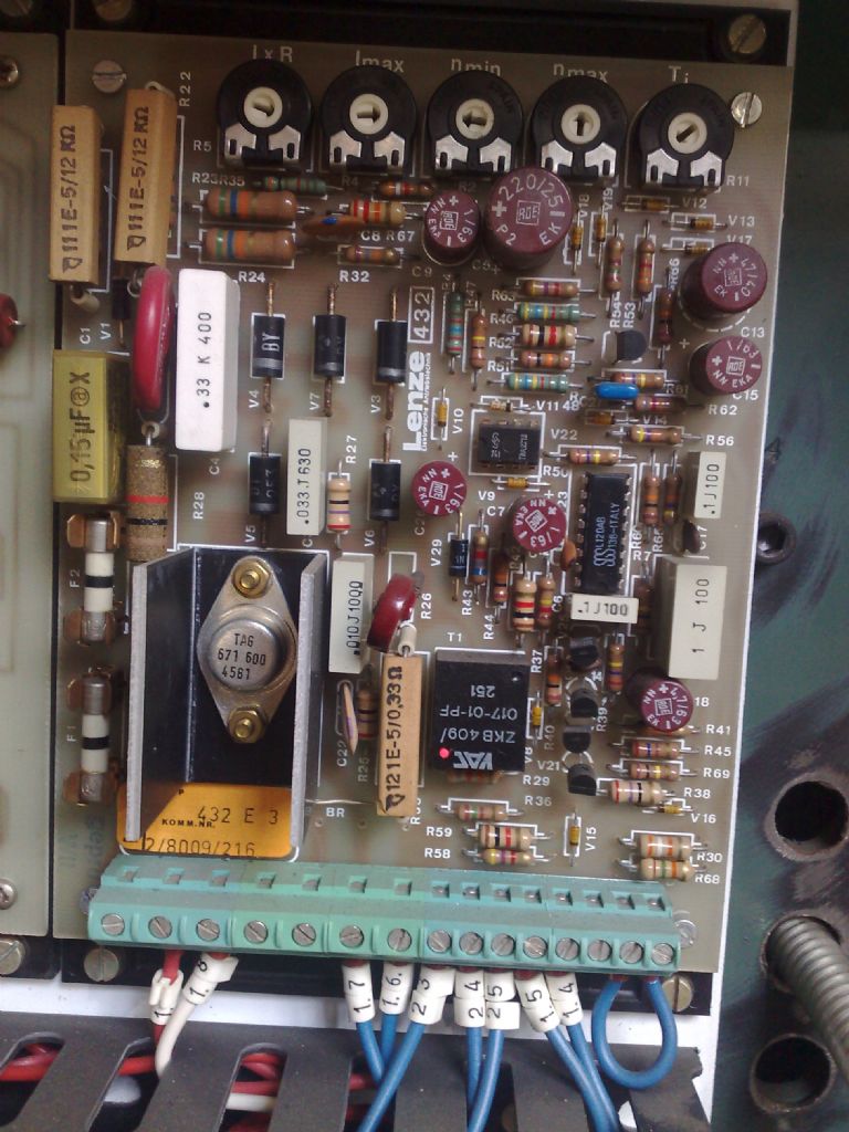

        My tom senior mill has a dc motor with reduction gearbox at one end of the table to provide power feed in the x-axis. Ever since i bought the mill a few years ago, when using the power feed, especially with a heavy cut, there was a strong smell of something electrical burning and copious smoke from the electrical box on the base of the machine.
        I know its nothing to do with the main motor drive as i removed the drive pcb to make room for a vfd to power the main motor. All i left was the pcb that powers the dc motor. I have examined the board and cannot see anything burnt, and i do not have access to a thermal imaging camera to see whats getting hot. The best thing i can do at this stage is buy a new dc board so i can once again use the power feed, getting tired cranking the handle.
        Does anyone know of a company that makes or supplies drive boards for this type of application ?

                Despite that board having clearly come from the Ark, there's nothing on it that looks as if it's even got warm, so I doubt the smoke is actually coming from the board. Have you checked the connections and wiring? As Gordon says, see where it's coming from. "Let it develop".
                The only date code visible is on the TO-66 metal can device (1981 week 45). I see a manual still available from Lenze dated 1979, so that sounds about right.

                  I agree with you that if the fault was bad enough to produce smoke then I would expect the board to be marked. I suspect that the photo may have been taken some time ago before the fault occured as Ronan has a number of pictures of the mill in his album. It would have been wise for him to investigate the cause of the smoke when it occured.  I found a site that claims to have a schematic but they want an email address and I do not trust sites like that.

                    Two things that may be worthwhile checking, has oil/coolant got into the electrical box and if so is there a component getting hot enough to vaporise it and cause the smoke and secondly adjacent to the circuit board there is a transformer, albeit only 12V at 12VA but is this getting hot for some reason.

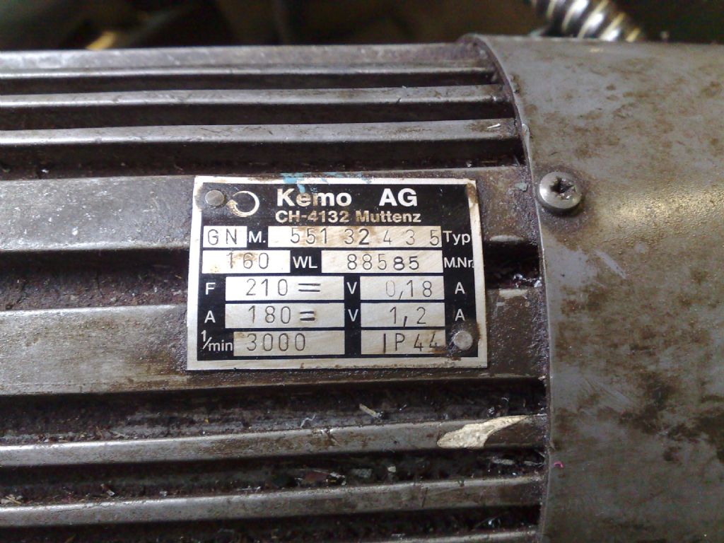

                        Thanks for the replies everyone. I have contacted lenze via email and requested a manual, hopefully they will have one on pdf. The fact there is nothing obviously charred is confusing to me too, but as someone said the machine is from 1981/82 so something is getting tired. With the brief bit of research i have done on this board, it appears to have been around for a long time and been used widely, so it must be reasonably reliable. The motor is a swiss kemo unit, but there is no voltage info on it, just amperages.

                        John Rudd
                          @johnrudd16576
                          Ronan,
                          if you read the label again…….the field winding is 210v dc and is rated to draw 0.18 A, the armature is depicted below…….
                          HTH…….
                          #184368
                          ronan walsh
                            @ronanwalsh98054
                            Yes John, i just copped that.

                              Before replacing the board I suggest that you check that the motor is OK first. Check that the field winding resistance is about 1200 ohms (210/0.18 = 1167) Check that the brushes look OK Check the resistance between the armature connections and turn the shaft a few degrees at a time. The resistance should be about the same in all positions of the shaft and much less than the field resistance. (I would guess is should be less than 50 ohms) If these readings are as expected and you have a DC power supply of between about 50 and 150 volts try the motor on this. (Connect the field and armature in parallel to the supply.) If the motor runs OK like this then the fault must be the board. If you cannot obtain (Or repair) the original board then a KBIC-240 board would probably work, There is one of these on ebay in the UK on sale at the moment and several on sale in the US.
