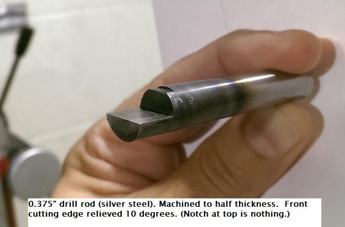

                      Sorry, I should have given more information. The hole will be 0.250" deep and will receive a pressed-in magnet.
                      I've done this before with other magnets, but with those I made the hole deeper and used a 0.374" reamer. With this one I need the magnet seated firmly at the bottom of the 0.250" hole (and without thread locking compound).
                      I have this, but it's the wrong diameter and don't remember if it worked well. If I make one of the right diameter will it give me an accurate hole?

                        Hi Mike, that D bit looks about right but you really should hone the cutting edge after heat treatment as the heating tends to blunt sharp corners. Oh and it wants to be slightly thicker than half thickness by a few %.

                            chris: Yes, the cutting edge for that bit was honed with a diamond hone. It may look dull, but it's actually quite sharp. I didn't know about milling to greater than 0.5 x diameter. Thanks.

                              If you want a dead size hole, don't machine/grind all the way to the half-way point, stop just short. This will ensure the d-bit only cuts on the end. leave the end flat across to half way., then angle it. This reduces the tendency to cut oversize and reduces the width of the chip. A very shallow (1mm) drill hole helps get a d-bit started accurately.

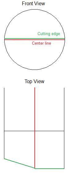

                                Like this? I wasn't sure if the cutting edge should be relieved in two planes so the top view or the side view may be wrong.
                                #204576
                                  Not quite, the green line should be straight – you need a slightly larger than half-circle to make sure a D-bit cannot cut on the edges.

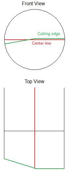

                                    Okay, like this. What's a good angle to relieve half of the cutting edge?

                                      Hi Mike, I see you have got the shape now but reading your reply to my note, I would have put it as mill to less than half diameter not greater.
                                      I think you will find the idea of having greater than half Dia is to stop the tool bit chattering, or otherwise moving about, and therefore cutting a larger hole than itself. If for instance the flat is less than half thickness it could move about as the cutting edge is less than its diameter. If the D is greater than half, the cutting edge is also less than Dia but it now has support.
                                      The better shape would be to have only a quarter or third section removed, which would give far better support, and this is indeed one of the commercial shapes for gun drill and the like.

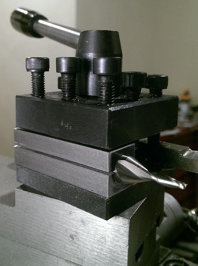

                                          I decided to take the advice to use an end mill as a boring bar. Since I didn't have a way to hold the end mill securely, I made this tonight:
