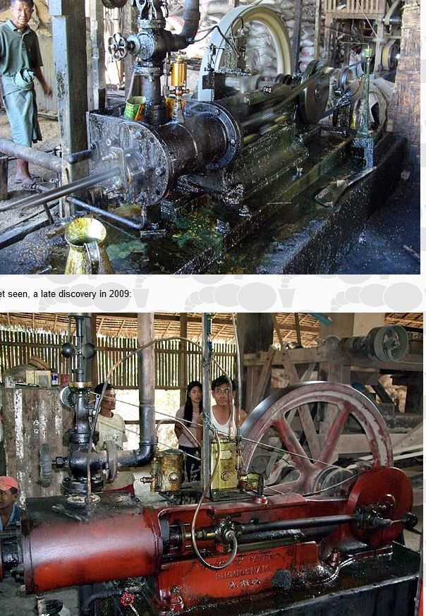

              I knew I had the photos, top shows a similar one to what I describe above and the lower being fed from a mechanical lubricator.
              We have had similar discussions about the Clarkson twin/compound and it's 4 bearings on here before, I have redesigned that to reduce the distance between the two "halves of the engine and therefore shorten the crankshaft and up the size of the outer bearings but probably more than you want to do at this stage.

                    The photos came from here, you can right click and copy the image URL to view but they don't seem to be showing up on the page for me. Lots of other interesting old engines on that site, this page is a good start.
