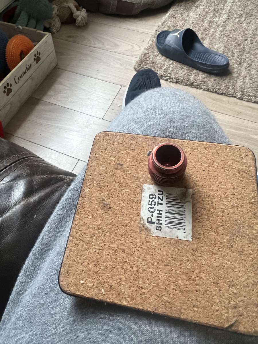

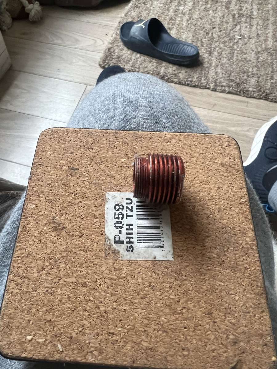

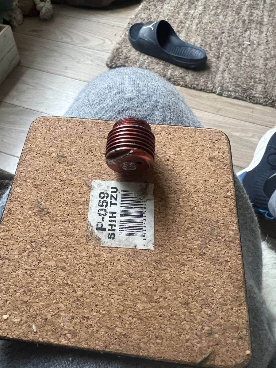

      Could any one tell me if it is possible to have a new one of these made { does not have to be red} ,it is a cylinder head of a .75 cc model plane engine .
      classed as a diesel engine the hole in centre should only be 5 BA little hole 10 BA ,or would it be possible to fill with alloy solder drilled and re tapped .
      It is off an engine from when I was 12 (66) now so it’s old
      cheers in advance

        Not quite sure what the 5BA and 10 BA refer to. It sounds as though the threaded hole in the (red?) cooling jacket has worn badly. I assume it is the threaded hole for the tommy bar / compression screw.
        Soldering would need special solder for aluminium. I would simply drill it out and make up a compression screw with a larger diameter thread.
        It would suggest that the contra piston is too tight in the bore. This seems to be the most common reason for the compression screw, threaded hole, to wear. It is a simple job to ease the contra piston to give a better fit. If you have a lathe then this is a straightforward, but messy, job.

          It should be possible to repair ! one way would be an oversize threaded bush and tap to size needed. Another would be to make an oversize contra piston thread and same in head. Good luck.  Noel.

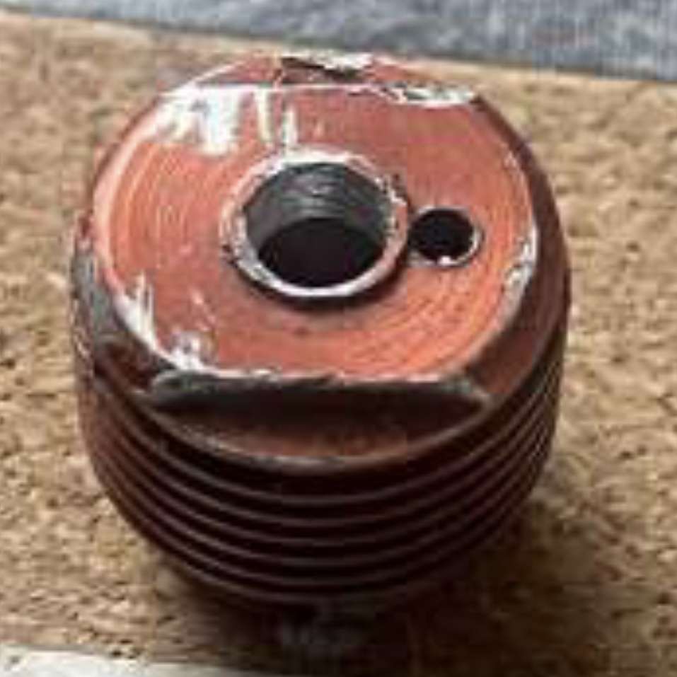

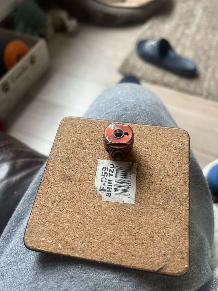

            The 5 BA is for the contra piston 10 BA for limited stop pin on head 5 BA is stripped ,tried to re thread failed miserably now it has a 1 BA hole ,( yes tried a few times I’m no engineer 😀
            don’t have a lathe wondered if anyone on here could make a replacement .IMG_1013IMG_1014IMG_1012IMG_1011

              In my oppinion remaking the whole head is overkill and way more difficult than putting a new oversize thread in the head for a new compression screw.
              If the contra piston is too tight now is the time to get it out give the rim a LIGHT buff up with Brasso to ensure it moves smoothly.
              fitting a bush or a helicoil are also possible alternatives.

                There does not look to be much metal left between the now 1BA hole and that for the pin. At a minimum you are likely to have to go upto 0BA or M6 maybe a bit more to 1/4 x 32 to get a full depth thread and they could all break into the smaller hole.

                  The head looks as though it is from a DC Sabre. The later models had a pin stop to limit the amount of compression that beginners could use. If you needed a smaller higher revving prop, then often the stop pin would prevent you from getting the optimum compression ratio. IMHO the pin is best left off the cylinder head.
                  Andrew.
                  P.S. Looks as though the head could do with re anodising.

                    At 0.75cc is it not a Merlin?
                    The flats have been a bit chewed up in the past too.

                      No it’s not the Merlin it is the super Merlin , red head and red prop spinner both were .76 cc the sabre was 1.5 cc the spitfire blue head 1cc and the rear induction 2,5cc Rapier .
                      That engine is 54 years old with bits missing , but I got it running till compression lever stripped’
                      I have no means of repairing it

                          Expanding on Michael’s idea, is there space inside for a small lip on the insert? That should stop it blowing out if the Loctite isn’t up to the job.

                            <p style=”text-align: left;”>Probably too hot for loctite unless just a cosmetic non runner, but a headed bush pressed in from underneath might work. Without a lathe the OP is going to struggle.</p>

                                But it would be difficult to put the head into the lathe to clean up the hole sufficient to get a half decent surface, might manage with a drill to make the bush. I also feel temps will be too high even for something like 648 so to get a suitable press fit the OP would need to be handy with the drill and graver.

                                    Well thanks for the interest , seems a bit scary to me, nearest thing I have done is sharpen my chainsaw blade.
                                    Not sure what I’ll do could go on eBay buy another for spares etc .

                                        Yes, a threaded repair bushing with a ‘top hat’ lip shouldered up against the underside of the aluminium head/cooling jacket would work ok. The only problem for the OP is he doesn’t have a lathe or a milling machine to accurately ream the stripped thread hole square with the top of the head and to a good tolerance fit for a bushing….I’m sure that could be salvaged but it isn’t something I would tackle without a lathe or a mill.
                                        I think the high temperature Loctite retaining compounds would cope with the heat of on of these little diesels aero engines….I know I have to get components that have been bonded with high temp retaining compound a lot hotter than one of these motors run at to disassemble the parts.
