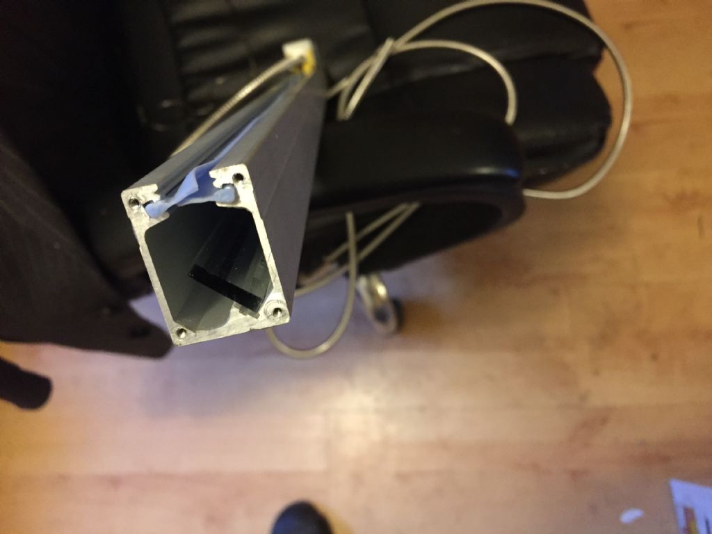

                    Thanks – reassuring for the most part! I realised after posting that the nay-sayers I'd come across in my searches were either vendors, who obviously can't recommend this sort of thing, or folk who hadn't actually tried it but had heard from 'someone' that the glass is tempered and would shatter to smithereens at the first touch of a cutter. Which seems to be a myth.
                    The scale in the encoder I have looks like it's glued to the ali extrusion along its whole length:
                    so I can't get it out and cut on the bench. I have spare length, so shall make practice cuts with discs I have – I think I need to go through metal and glass with one setup to get a square end to refit the end cap. Squareness won't happen with a hacksaw in my hands!
                    Robin

                      Robin, IIRC my glass was held in with 1/2inch long 1/16th rubber strips which came out with a small pick.Take a picture before removing as I think there was an offset against the reading head. The ends had a dab of glue holding them in the end caps.Of course the wiper seals pull out permitting better access.
                      I would not be confident of the glass remaining intact if the glass were to be cut in situ. I have seen it done on YT but….

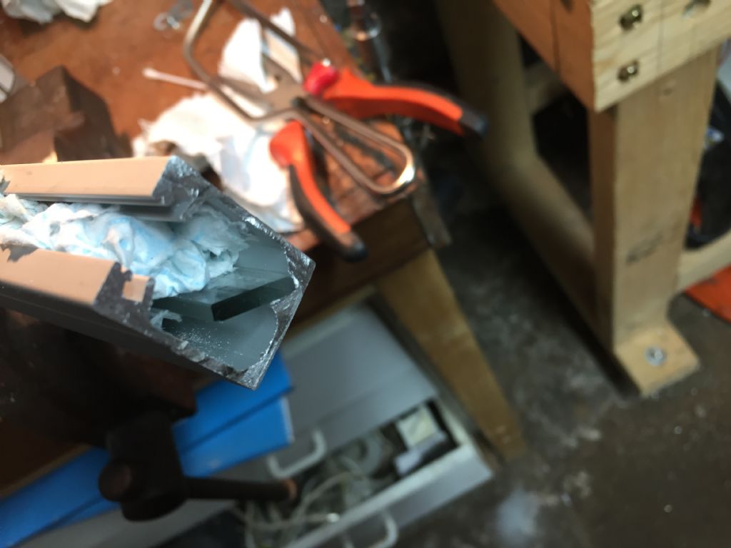

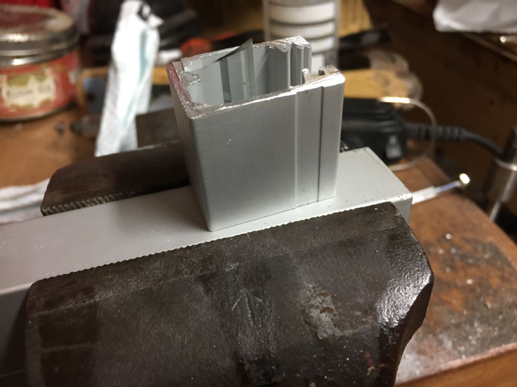

                              Some measure of success. First attempt wasn't good – this is the test cut-off piece:
                              I cut the case as near to the glass as I could with a junior hacksaw, then tried to open the kerf with a carbide hacksaw blade (the red bit) with the intention of working round to get the blade flat on the glass and at least make a score line. The grit on the blade was far too coarse and it all broke apart before the blade got to the glass.
                              On the plus side, (a) if that had been the final cut it wouldn't really have mattered because the read head doesn't get that close to the end, and (b) the glass didn't shatter. On the minus side – well, it's not nice.
                              Attempt two – this time I cut as before, but went went into the kerf with a diamond wheel on a Dremel type tool , nicked the glass, and with my heart in my mouth and my bowels in my trousers I snapped the end off:
                              Result!
                              Robin

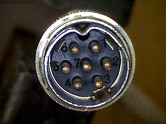

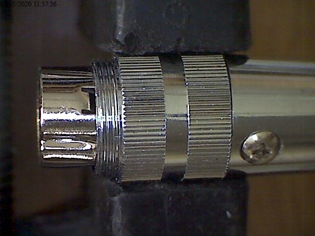

                                  Hi Robin,
                                  Thanks for the reply. I am now wondering if the connector on your scale is different to mine as the pin layout is different to a DIN connector.
                                  Here are pictures of my plug.
                                  Looking an the Farnell website I think I have identified the connector as a Binder 680 series connector.
                                  This is the Farnell web page for the sockets.
                                  **LINK**
                                  I have also found a chasis mounting socket on ebay eBay item number: 362709678935
                                  They are quite expensive so I think I wil try to make some kind of connector to test the scale. When I know it is OK I will fit a different connector to the scale.

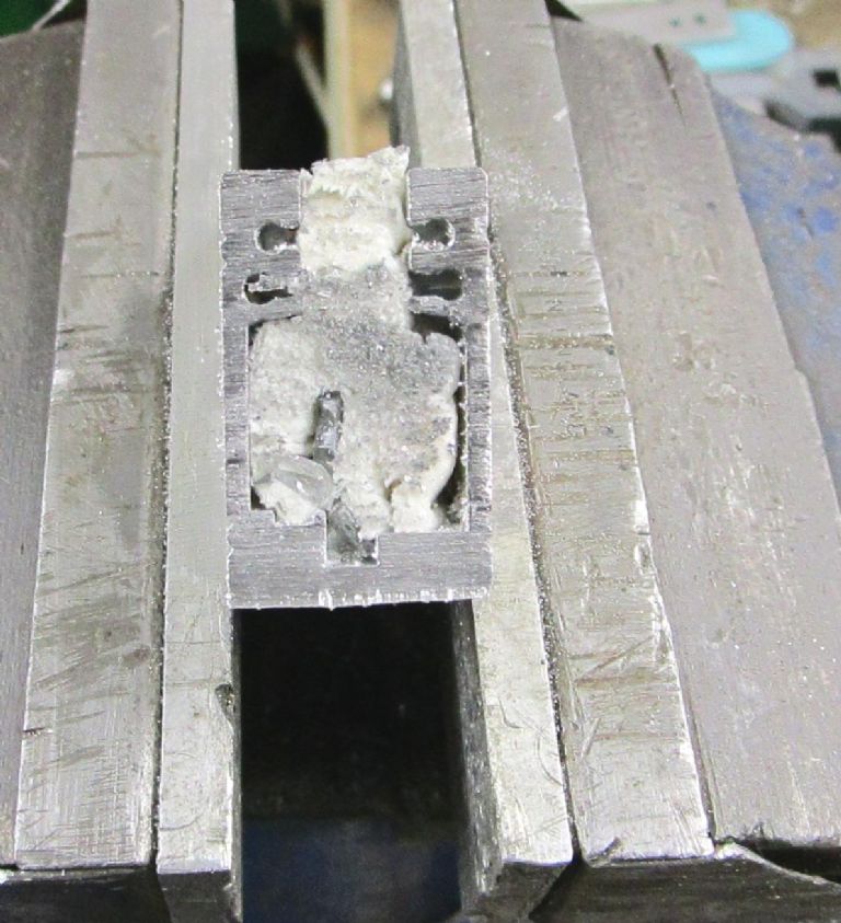

                                    Hi Robin,

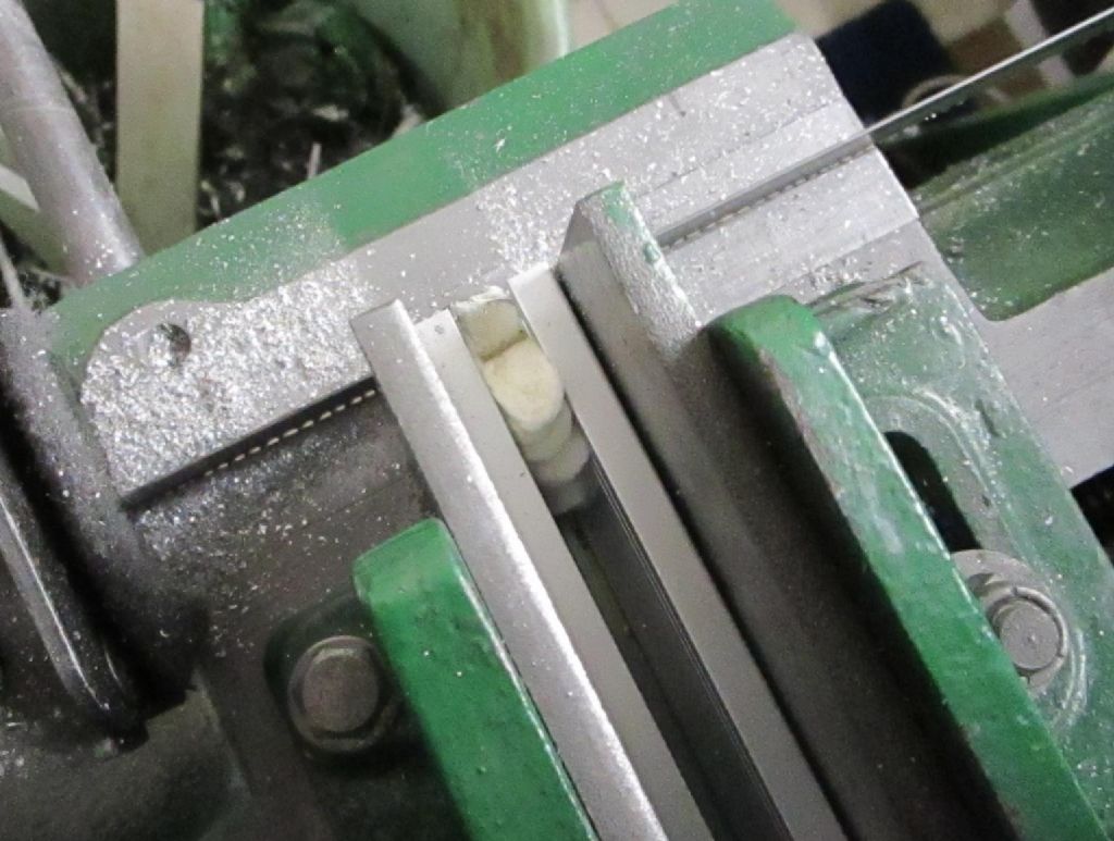

                                    I cut my glass scales using the bandsaw, 14 tooth blade, without any issues. The trick is to pack the glass scale inside the extrusion so that it cannot move. I used paper towel damped with water and packed it as tight as I could. The bandsaw cut it easily with only very slight chipping of the edge of the glass. I removed the paper packing with a dental pick.
                                    Good Luck.
                                    As can be seen in this picture the chipping was only slight !
