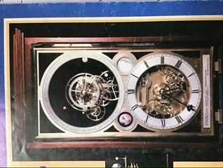

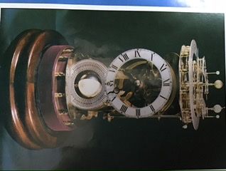

                                          #483615
                                          Old School
                                            @oldschool
                                            These were the clocks my father made towards the end of his working life.
                                            These were made in batches of five each batch was different..
                                            This was the last orrery he made. After that he made a few clocks for pleasure.
                                            His workshop was half a double garage only room for one person everything for the clocks was produced in the workshop. My mother made him keep four clocks one for each of their children mine is a long case clock.
                                            Will someone please turn the picture the right way round please.
