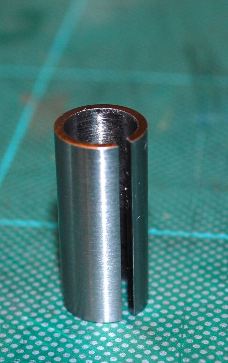

          Hi Brian
          Just in case it may be of use – I made one of these but I was holding 5/16" stainless for threading at the time – so maybe this is not suitable unless you can cut the small diameter needed for your job. I have used similar for smaller though – but not down to 2 – 3mm.. It's never left a mark on the work..

            I would use an ER collet chuck in the lathe. This would hold it true and tight. I doubt a standard three jaw chuck would hold it without marking the outside diameter.
