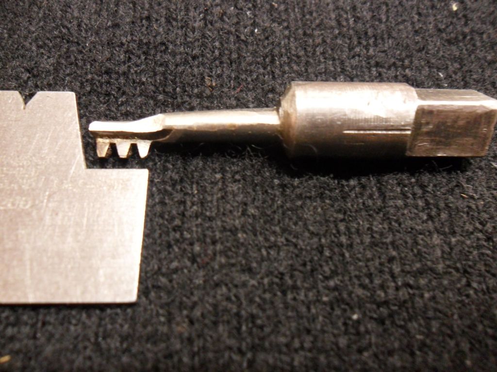

                                          Nobby
                                            @nobby
                                            HI guys
                                            When restoring my S7 Mk1 I made the x slide nut out of brass & the acme thread leaadscrew out of
                                            mild steel. the tap was made from H&T S.S
                                            Nobby

                                                  #113265
                                                  Nobby
                                                    @nobby
                                                    As I said before I made a tap with ss h&t . when using again it broke so what I done after a resharpen put it in the toolpost like a boring bar and srewcut the next nut I made . to make a cutt not under power I  used a mandrel handle having retracting the tool after first cut just reversed the lathe by hand with the handle . with half nut still closed and put the next cut on using the x slide etc It was a good question Phil thats how we all learn from each other on this forum .
                                                    Nobby
                                                    Edited By Nobby on 27/02/2013 16:44:08
                                                    Edited By Nobby on 27/02/2013 16:44:58
                                                    #113272
                                                    Nobby
                                                      @nobby
                                                      Hi Again
                                                      Here is the tool from broken tap for 3/8" x 10 tpi acme form Its a bit worn now
                                                      NobbyH&T  S.S acme form
