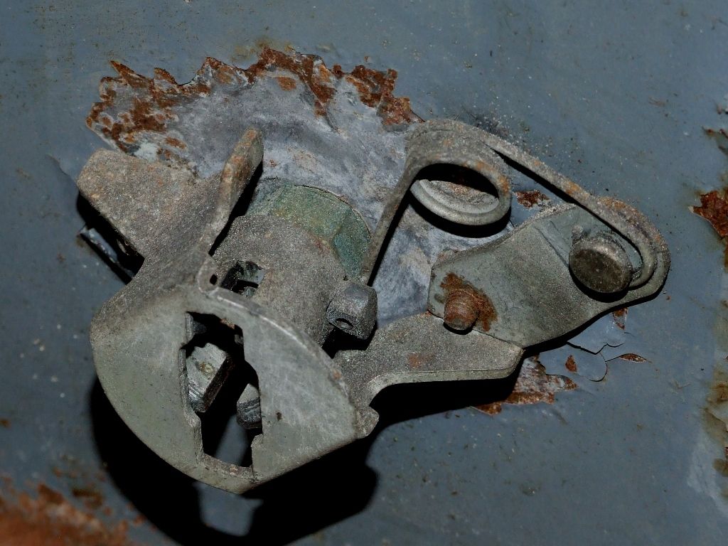

      Can anyone help with pictures of the fitment of the bias spring on a Crabtree machine isolation switch? Mine is fitted to a Myford MG12 cylindrical grinder and is situated at the bottom of the door, with the function of precluding you having a mostly live machine with the door open.
      The spring should return the lever to the 'off' position with the door open, so it engages with the switch when the door is closed.

            It is the mechanism on the door. One end of the spring is tethered to the through door fastening screw, the second is somehow connected to the barrel in the centre- that is what I'm looking to understand.
            I'd mail a picture, but haven't worked out how to append one here yet. Not sure if the forum software likes Firefox

              Pictures of the lever and spring, in the OFF position:
              And the ON position:
              The spring is pretty weak, wouldn't pull the skin of a rice pudding. The geometry is such that the spring tends to move the lever to whichever setting is selected. It certainly won't return a lever in the ON position to the OFF position. Given that you can't open the door with the lever ON I can't see why you'd want the spring to return the lever to OFF?

                That is perfect!
                My set up has been abused prior to me opening the door. It is missing the lug that the spring locates in.
                That lug, whilst logical, is new news to me
                I think my logic is with the door open the main switch is 'Off' biasing the knob/lever on the front door to 'Off' also means when you shut the door, the pin on the switch and the mating groove in the barrel line up.

                          At first thought, I imagined that the item I call the barrel was missing a lug, and that had been snapped off. On inspection there is no sign of damage on mine. I suspect the part that looks like a lug is also where I have a drive recess.
                          Do your photographs actually depict a headed pin with a hole in it?

                            The lug is part of a serrated pin that holds the shaft on the lever to a collar with slots in it to drive the contactor. If that's not clear I can take pictures, or create a sketch.

                              Again, thanks. I removed (what was left of ) the pin to see a crystalline fracture point where the head shown in your picture should have been.
                              All clear to me know. Next a small turning job.
