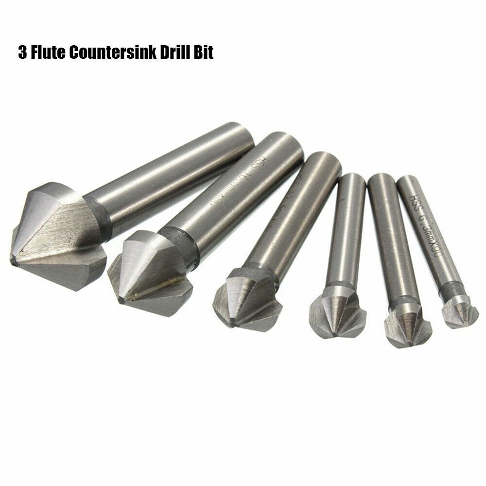

                            I googled 82 degree countersink and got lots of hits. Five flute countersinks were easy to get hold of and would be my choice. Practice on a spare piece of brass to get the optimum speed which should be slow to minimise chatter.

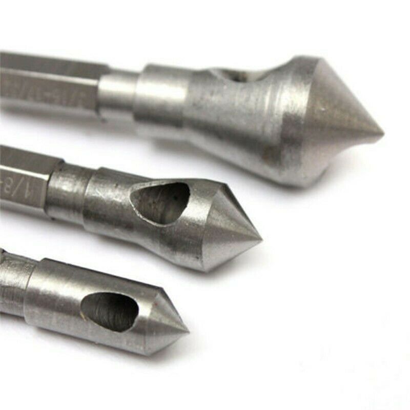

                                    Using a larger 2 flute drill bit to centre on the hole does not always work because it sometimes digs in more on one side than the other (both flutes have to be ground exactly the same to cut equally), producing an offset chamfer. Even worse with a long slender drill that can flex. Using a rigid cutter, held on centre with the hole is a better option. Or a cutter with 3 or more flutes if held by hand.
                                    This type on the left works well, as it has a large flat area for locating on centre with the hole. For larger holes I use the type with a hole thru the side. (these are easy to sharpen by grinding the cone end)
