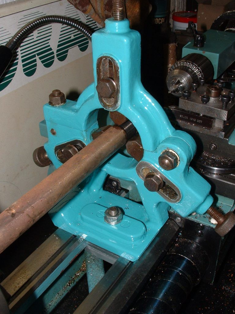

                        Another substantial fixed steady on a Denford Orac, modified base to suit this lathe, very sturdy.
                        Emgee.

                                This is my steady, from Arc. It works just like the one on the Denford except it doesn't open up, and probably has even more meat in it..
                                This (from Machine Mart) is the steady for the Cl500M which I think is equivalent to the Chester B Super Multi.
                                It has screws to remove any play in the fingers. The locking mechanism looks OK to me, but it sounds like Martyn is running out of adjustment before it locks? Or maybe, as Jason suggests, paint needs to be removed from underneath.
                                Other possibility would be a high spot on the contact surface, which should be easy to correct with a bit of blue.
