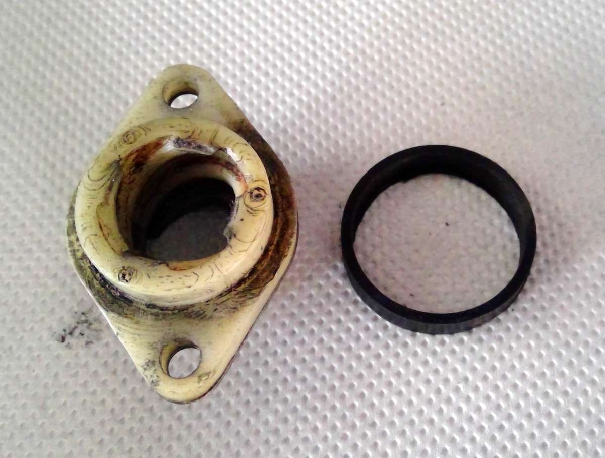

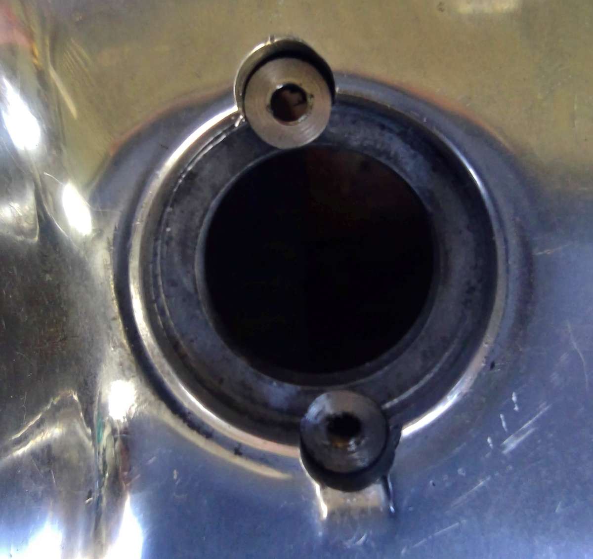

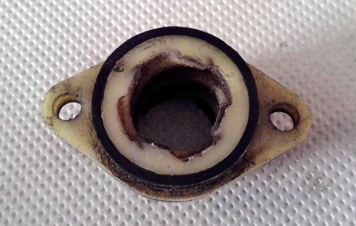

      The master cylinder I bought for the hydraulic clutch came from China, the only one I could find of the right size that didn’t cost a bomb.
      The ad said it was for mineral oil, so, that’s what I used.  Unfortunately, the ad was wrong and the mineral oil swelled the seals inside the master locking it up.  I managed to free it up, but the seals were ripped and swollen to twice their original size.
      I searched and searched but couldn’t find any replacement seals, not even from the manufacturer, so the master went in the bin and I converted it back to cable operation.  The only other option was a Brembo unit, but I’m not prepared to spend that sort of money on a master cylinder.  One day i may buy another cheap Chinese master and fit that.  For now, all that was left was to convert it back to cable.
      The reason I converted to hydraulic was to make the clutch pull easier on my arthritic hands.  But there’s more than one way to do that.

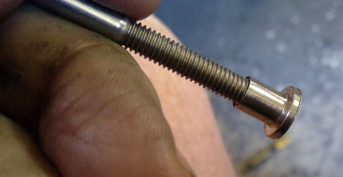

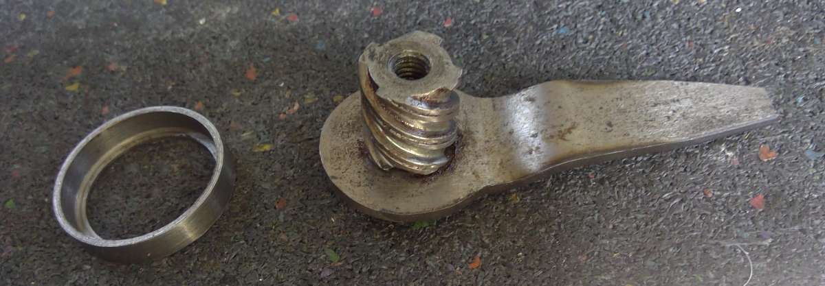

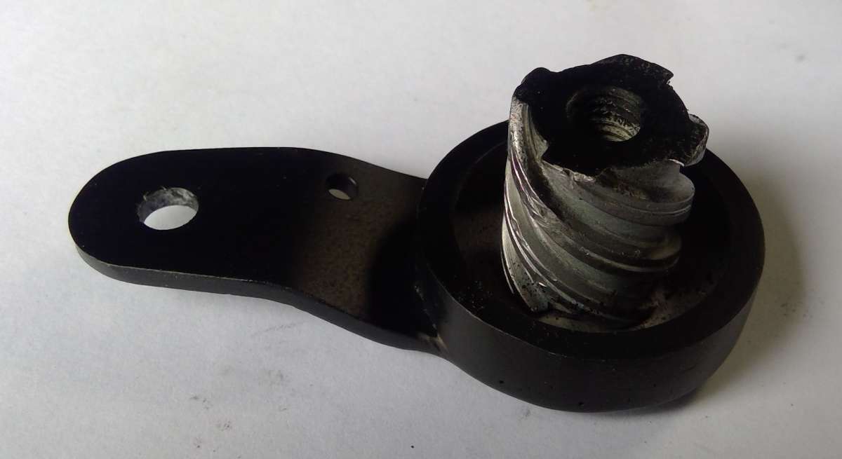

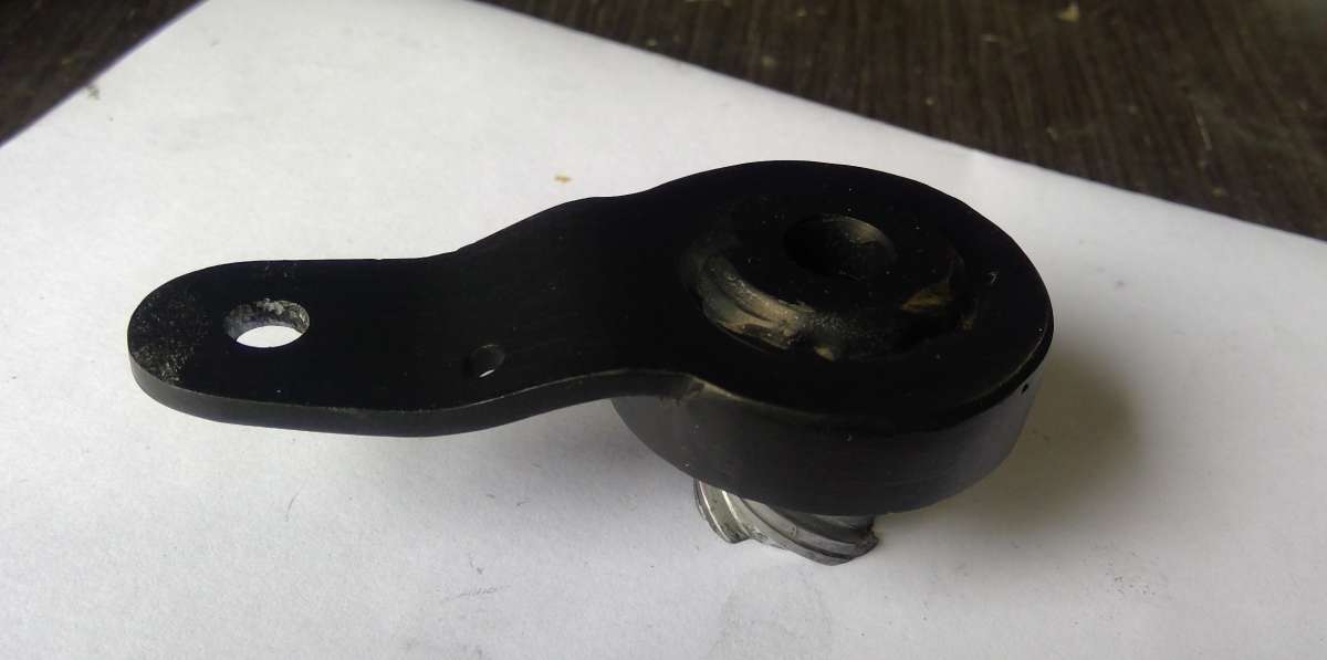

      So, in converting back to cable and make it easier on my hands, I cut the lever off the original screw acuator and fabricated a slightly longer one.  I also turned up a seal retainer and welded that and the extended lever back onto the screw.  The lever is around 8mm longer that the original from memory.

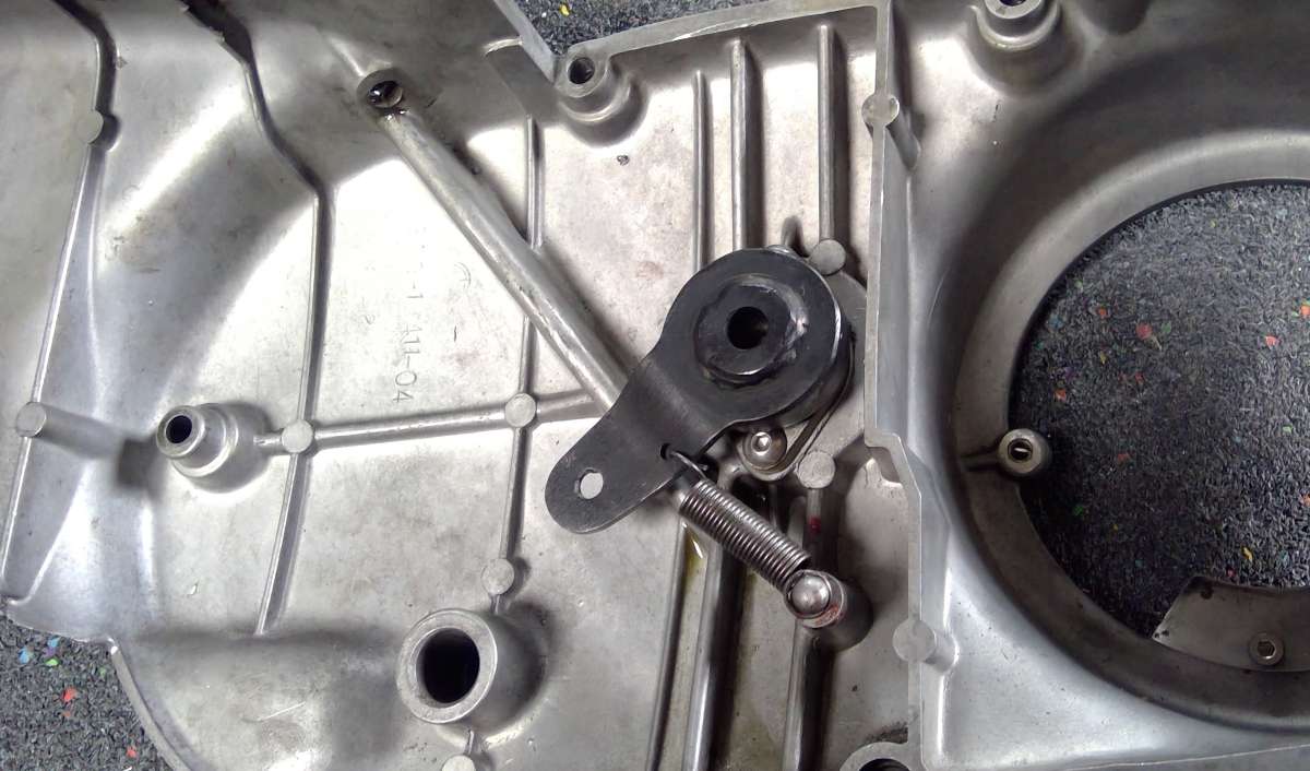

      Next I had to modify the cover to return it back to it’s original configeration.  To do that, I turned up two stainless M5 threaded T nuts with an outside measurement of 6.06mm, then pressed them into the side cover.  With the screw actuator refitted, I was left with a slight gap between the actuator body and the hole in the side cover, a simple Delrin bush I turned up on the lathe fixed that.
      So it’s back to the original cable operated clutch.  If I come across another master, that I can get seals for, the slave can be refitted quite easily. 4678WIN_20240305_13_51_36_ProWIN_20240305_13_58_53_ScanWIN_20240305_14_46_16_ScanWIN_20240305_14_49_03_Scan

          IF they still exist Allseals at Norwich may be able to help with seals but it is vital that you tell them it is for DOT 3 or 4 brake fluid. Noel.

              Try cleaning both parts of the four start thread, then lubricate with molygrease. If you are lucky, you will find a considerable reduction in operating force.

                Not sure how expensive, but I know some seals companies will custom machine seals to your drawing.  Often used to produce seals to suit slightly worn parts, but also useful for replacing obsolete or otherwise difficult to source seals.
