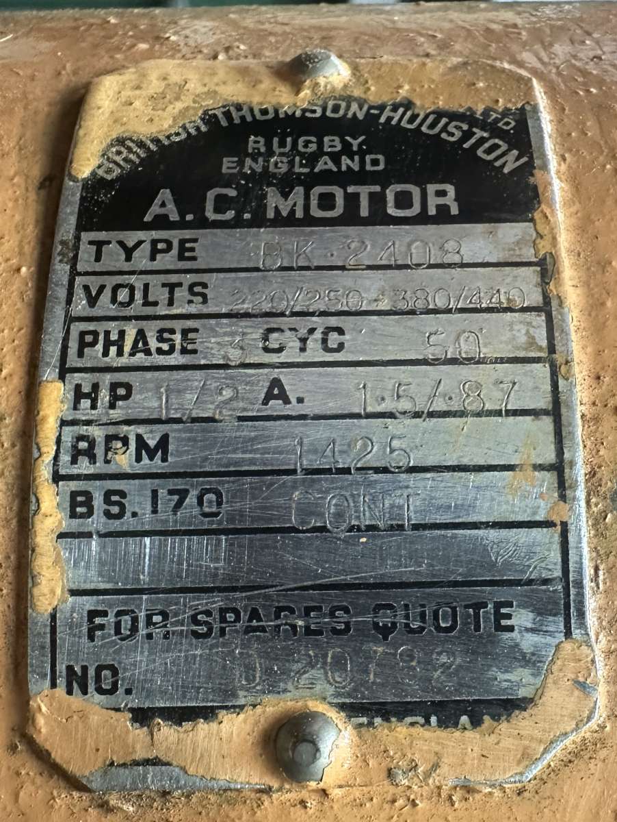

      • I have a bench top drill which is currently 3 phase. I would like it converted to single phase and son in law will have it. Can this motor be run as a single phase. The picture below shows the motor plate. IMG_6556Many thanks and Merry Christmas to all.

        It can with a VFD or fixed speed single to 3 phase converter.

          You can (probably) run your three phase motor by building a module with relays and run capacitors, which I still have on a couple of machines.  They run OK, bit lumpier than proper 3 phase, and occasionally I’ve had the relays stick (needing a good wack to free them).
          But, as Robert says, a VFD is definitely the way to go now.

            Don’t bother to try to run it as single phase is my advice.  Converters are expensive and VFDs are cheap.  Both options use a single phase supply to produce three phase output.  VFDs are programmable for several optional settings.
            It is more likely that the motor will be configured for ‘star’ operation.
            It would definitely need to be ‘star’ for operation via the converter.
            With a 220V output VFD, It would run in star but at lower power, so needs to be configured as ‘delta’ for full power output.
            415V output VFDs are available – but too pricey to be a sensible option.
            The connections, for each, should be shown under the terminal cover.

              A VFD and running the motor in star configuration will certainly work. Just a word of caution, the motor is probably around 70 years old and the insulation will not be up to modern standards. Running it on a VFD just may give you problems with the insulation breaking down. Probably be perfectly OK if you don’t use the drill at maximum power for long periods.
              Depends a lot on whether you have a good electric / electronics knowledge. If not, then the simplest option is to replace the 3 phase motor with a single phase 1/2 HP motor  A good second hand one or even a new one would not cost a great deal more than a basic VFD, by the time the VFD has been safely installed in an enclosure and stop / start buttons installed the single phase motor option would likely work out cheaper. Before everyone weighs in with ” A 3 phase motor runs more smoothly and you don’t have to worry about start windings overheating, with a lot of stop / start use” etc etc. Just realise that the OP may not have the knowledge to rewire the motor and install a VFD safely. If that is the case then a single phase moor is a safer and better bet.

                To run that motor off a basic 1 phase in 3 phase out VFD on 230V mains the motor will have to be connected in DELTA (220 -230 V phase to phase) not star.
                From the data plate it is connectable for either configuration. If running off 3 phase mains it will be currently wired as star (380-440 V).
                Robert.

                  Robert you are quite correct, not reading what I had written is my excuse! Delta connected is the correct answer!! Have probably imbibed too much of the Christmas spirit.

                        Colins motor is dual voltage so no need to go digging for the star point just strap it for 250.
                        Fulmen’s Steinmetz capacitor is how some people convert a suds pump to single phase. It might work for a drill with low mass to start.
