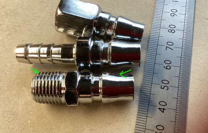

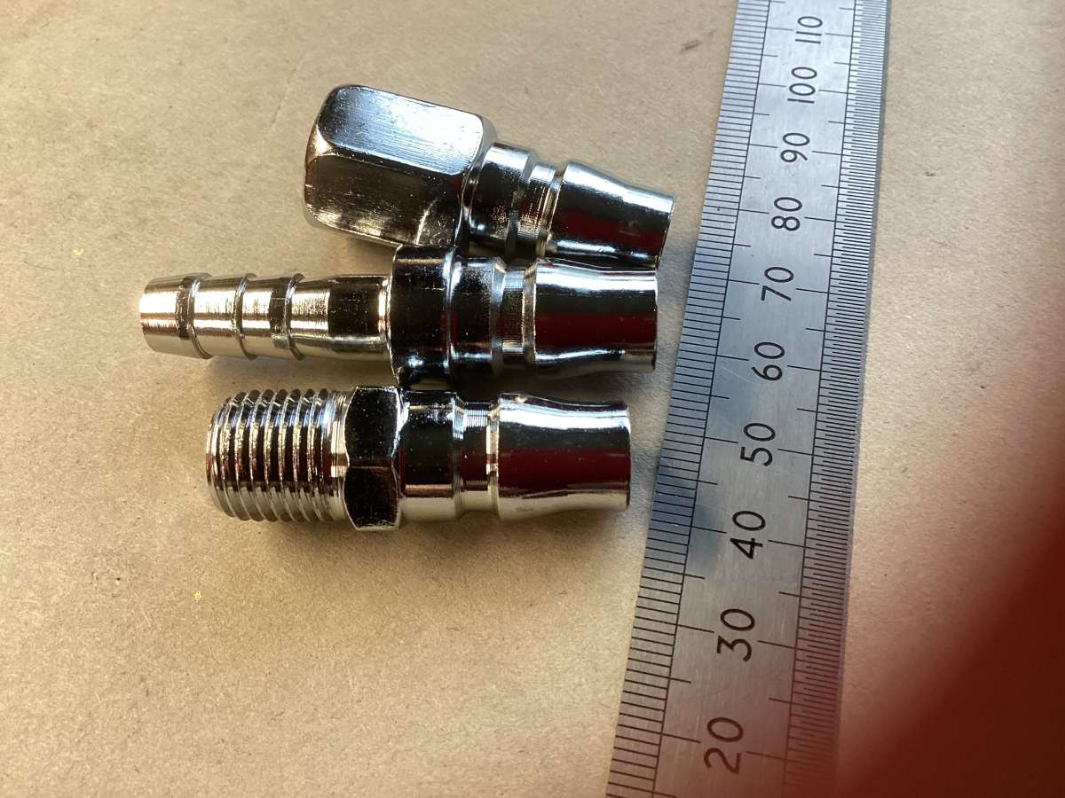

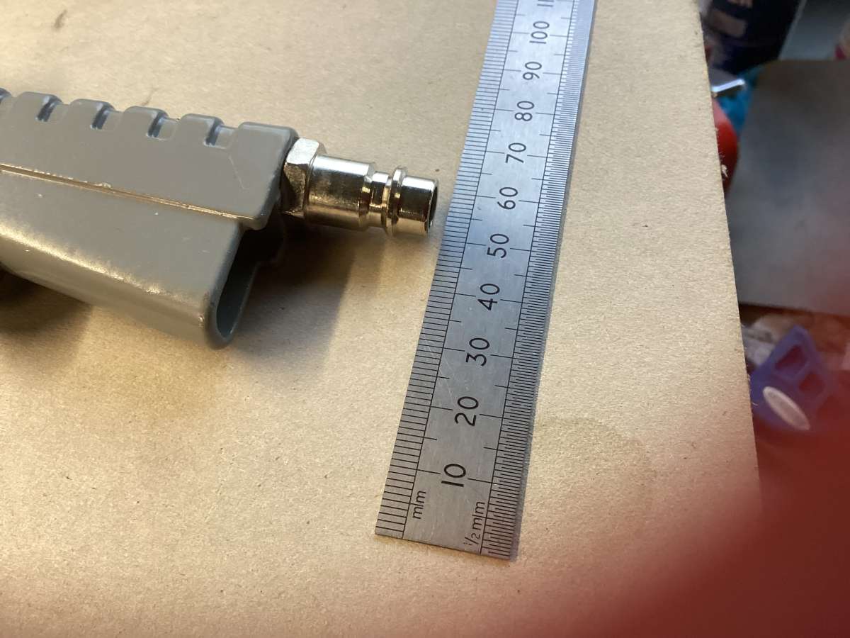

      I’m planning to buy a compressor – probably either the 24L or 50L from the Hyundai ‘“Super Silent” range.
      My understanding was that these have Euro couplings.
      In preparation I bought a pack of couplings off Amazon that were described as “Euro hose fittings”.
      They have arrived, and you can see three of them together in one of the photos below. My understanding is what they are in fact are PM20 fittings (they do have a 1/4” BSPT thread). I don’t know how common PM20 fittings are and in which countries, but they don’t appear to be that common in the UK, which seems to use mainly either PCL Standard or EURO fittings.
      My understanding is that a Euro fitting is what you can see on the end of my tyre inflator (from a cheap and hideously loud Aldi compressor).
      Could someone confirm what I’m saying or put me right?
      Lastly, is there any difference between a EURO fitting and a EURO XL fitting or do they describe the same thing? The AI I’ve consulted says they are different but non-AI sources I’ve consulted suggest otherwise.

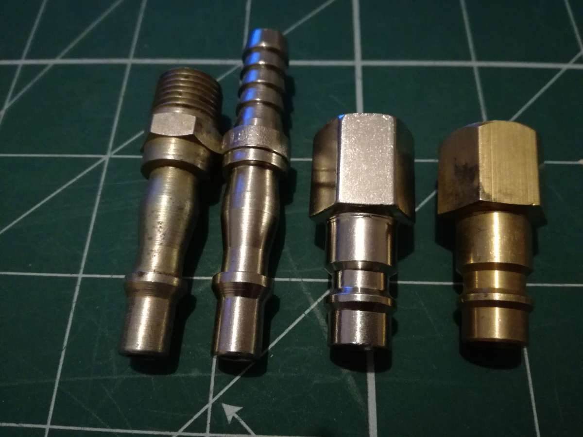

        I would also know this as a Rectus fitting. Many brand names make their own product line, called by its own proprietary name, which are dimensionally identical.
        See this thread, which may also have a name for the group of three:
        https://www.mig-welding.co.uk/forum/threads/what-are-these-air-fittings.147365/

            #833337
            Clive Foster
              @clivefoster55965
              If still within the Amazon returns window best to send them back. Obviously not Euro and, if so described by the maker/supplier, they clearly don’t know what they are selling so no telling what they actually are. Assuming they are to a recognised standard at all.
              I’ve been asked to identify nicely finished “China Inc” parts and failed miserably. Looked the part but not quite right and would not have connected properly. Still got one very similar to your second picture floating around somewhere. As I recall things the taper and parallel part at the end were mis-proportioned.
              Frankly PCL is still the safest low cost purchase even though economy range kit tends to be Euro now. I’ve yet to find a PCL that didn’t fit well. Some of the security latched ones fit too darn well actually! PCL doesn’t flow as well as Euro style tho’.
              Economy Euro style can be a lottery. No name Amazon, E-Bay et al varies from very decent to “how does it hang on”. The LiDL ones I hoovered up a while back in preparation for switching to all Euro style from a mix of Euro & PCL were uniformly excellent at half brand name price. (Predictably the switch over got no further than getting the parts!)
              I think best option right now for Euro is the PCL-XF range sold by Screwfix at an attractive price. Usefully less flow resistance than standard Euro, about 20% I think, for no more money than standard from many suppliers and a known brand. In the quantities a normal Model Engineer / Home Workshop person is likely to need the extra cost relative to uber economy Amazon / E-Bay et al is hardly significant.

                Go with and stick with PCL ! What you have looks like a cheap, plated diecast unit. Available at most good motor factors Etc.  Noel.

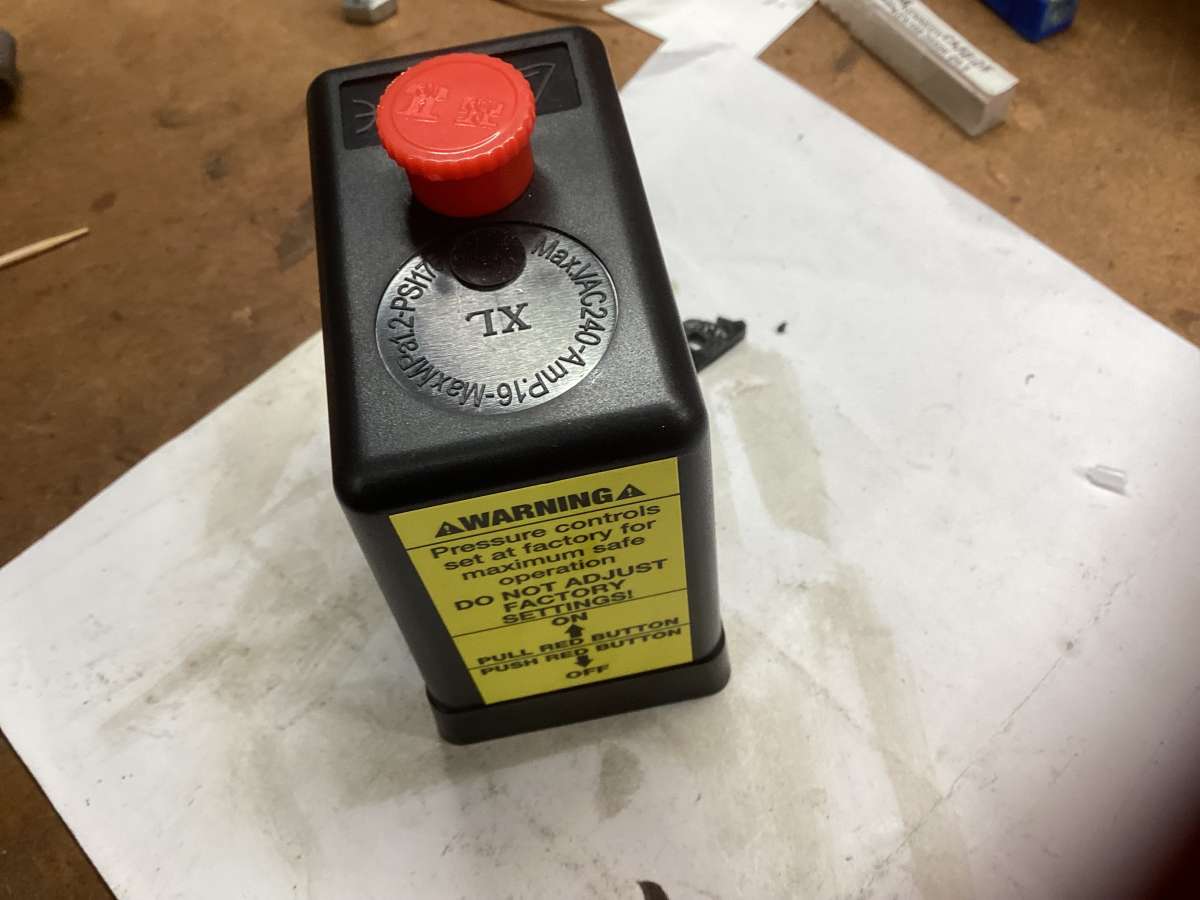

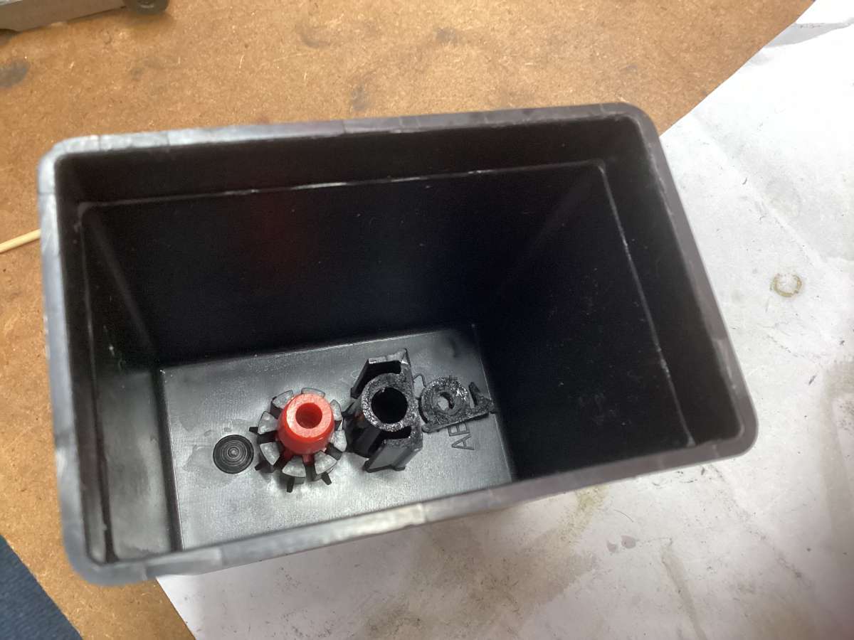

                                        Bill Phinn
                                          @billphinn90025
                                          Bit of an update on the Hyundai compressor I said I was buying. I received a 50l one a couple of days ago in a very distressed and torn open box. Fortunately the only damage that appears to be done is the plastic switch cover/actuator that the manual says you are to use to turn the machine on and off with. This was sheared off in transit and the result can be seen in the phots.
                                          I’ve asked for a replacement part to be sent out. They replied that they haven’t got a replacement part in stock and I’ll have to package machine up, be in for a collection and then be in for a re-delivery of a replacement machine.
                                          Problem is, the box was virtually destroyed by the courier, incl. the polystyrene inside, and the machine would almost certainly not be protected properly if it was sent back in that box. I’m also very reluctant to take two more days off work to be in for two more courier visits. I’ve pointed all this out to them. Waiting for an answer.
                                          Under the circumstances is it unreasonable of me to ask that they take the affected part off a new machine and send me that? Problem would then be resolved. Once the part is in stock they can put that on the new machine and sell it as intended.
                                          What would you want or ask for? The machine seems to work fine in spite of the absence of the flimsy non-functioning plastic part and the inconvenience of having to turn it on and off at the wall.
                                          IMG_1768IMG_1769
