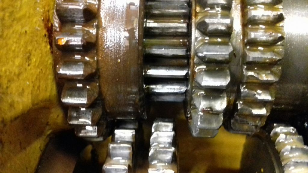

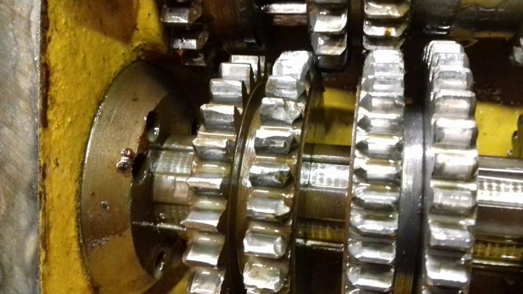

                  I removed the lower gearbox cover – there is damage to teeth on some of the gears. This will account for some noise. I don't know how worried to be about this – I've not looked inside the screwcutting gearbox on a lathe before but assume that some damage is not uncommon, particularly on hobby / training type machines. I put it back together and it's certainly quieter with fresh oil in.

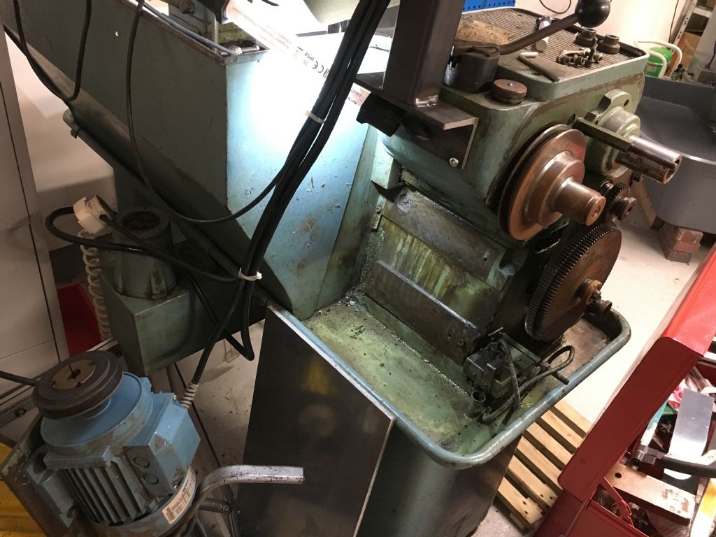

                    I've just had my motor off to fit a brake linkage mechanism which was missing on my machine. The linkage came from Bede Tools in Newcastle who had broken a Bantam for parts. However, I believe most of those parts had been sold and that was 2-3 years ago. But keep your eyes open and you may see another one being broken on ebay etc.

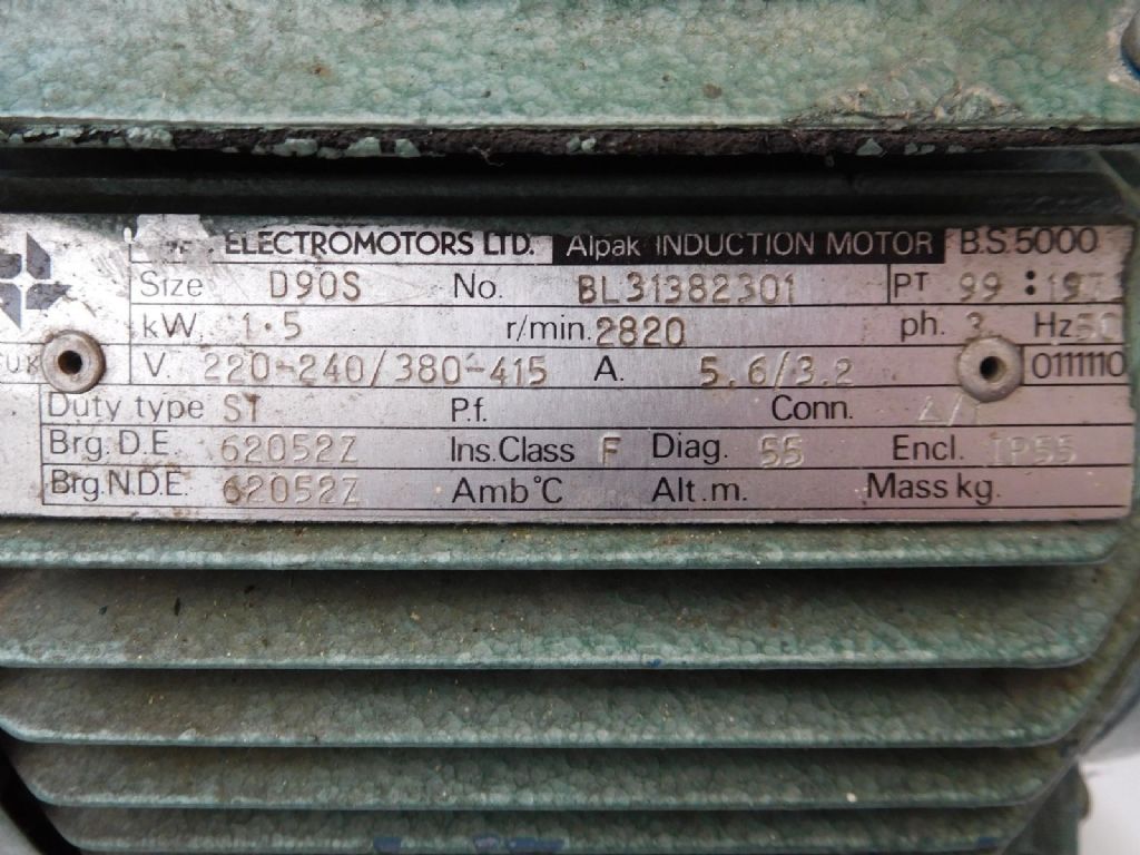

                        Would this motor be a good option with a VFD?

                          When you say the gearbox gears are damaged, do they have teeth missing or are they just a bit worn or slightly chipped?
                          If the gears are intact enough to run together simply stoning off any raised burrs might be enough to avoid having to organise expensive replacement.

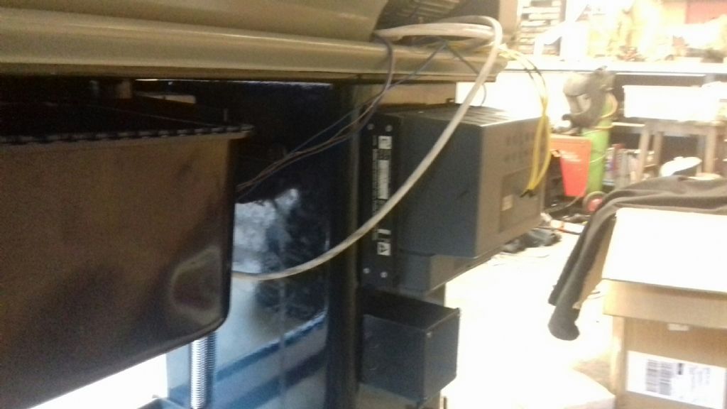

                            That looks pretty good. You will be able to connect it in delta so it runs on the 220-240V range. Then it will do the 2820rpm at 1.5kW. It's a modern totally enclosed fan cooled (TEFC) motor, which is good. I assume it's foot mount?
                            Of course, you will need a single phase to three phase VFD but these aren't expensive. Either get a proper one or take your chances on a Huanyang Xmas cracker. Or get lucky on ebay?
                            What do you mean about the broken gears? Could you show some pics? As Neil says, chips can be repaired but broken teeth are another matter. Also, you be able to use some ratios but not others. There are 3 basic ranges and 6 sub ratios.
                            The main gears you need are the 30t (output / bottom) and 35t (input / top), plus the 120 to span the gap. The 127t gear is what you need for metric ideally.
                            I had my motor off yesterday to fit the brake pedal mechanism. As you can see, there's plenty of room if you pull the machine out to give yourself plenty of room. You can also see the coolant pump which just sort of hangs on the rear lip of the chip tray

                              20180121_151953_resized.jpgThere are no teeth missing – mostly wear and a few chips – the worst are shown here:

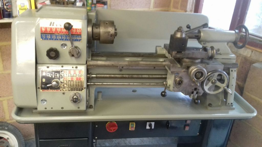

                                #344907
                                mtrehy mtrehy
                                  @mtrehymtrehy33968
                                  #344908
                                  mtrehy mtrehy
                                    @mtrehymtrehy33968
                                    #344909
                                    mtrehy mtrehy
                                      @mtrehymtrehy33968

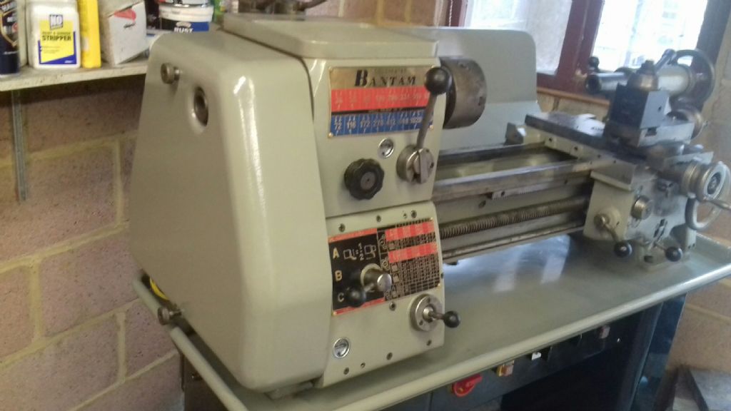

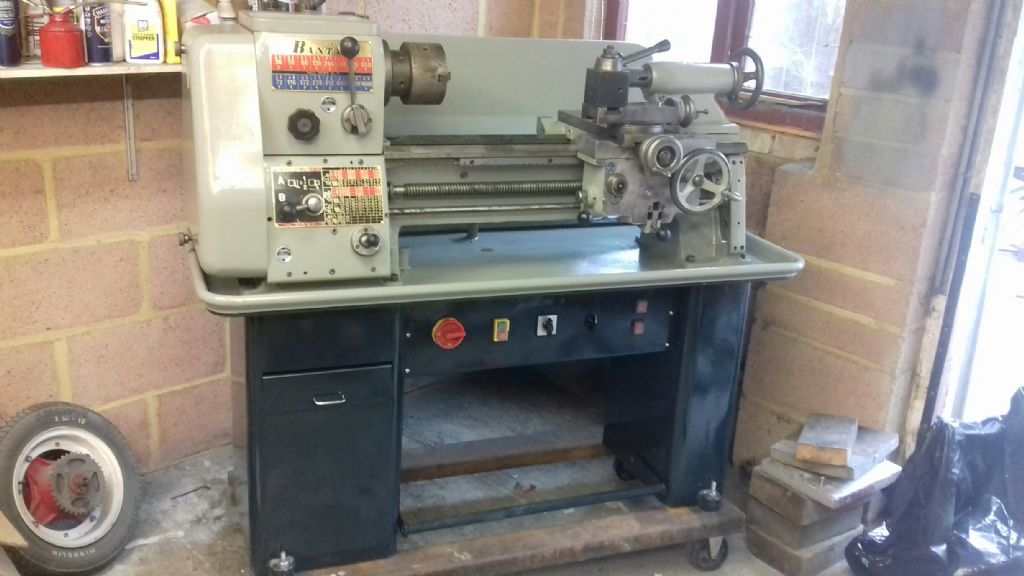

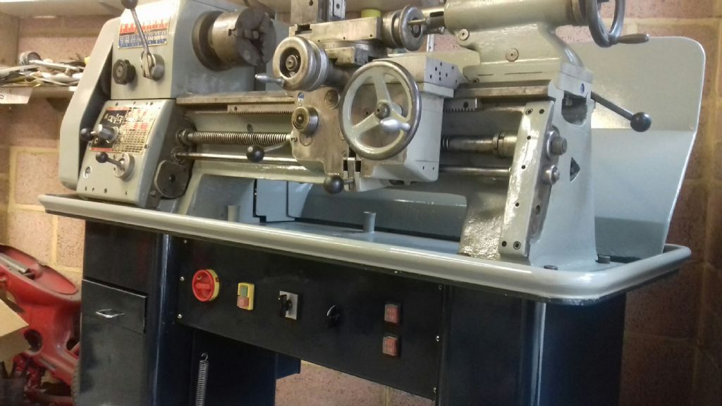

                                      Pretty much complete. Done quite cheap but lots of time spent!
                                      New motor was about £25 and the used VFD about the same. I spent £40 on a 10L parts washer that will be the coolant system. A few quid on switchgear and sight glasses etc.
                                      About 50 hours work I think – was stripped completely into component parts and bare metalled. Added a drawer to the stand and will add a large draw under the electrical panel when I get some time

                                              #344919
                                              Muzzer
                                                @muzzer
                                                Looking good!. Like mine, the bottom shaft that runs along the front of the machine is missing. That would have had a lever on it at the apron to start and stop the machine.
                                                Have you got all the manuals etc now? Now you have to start collecting all the other accessories for it. Keep your eyes open on ebay, homeworkshop etc!
