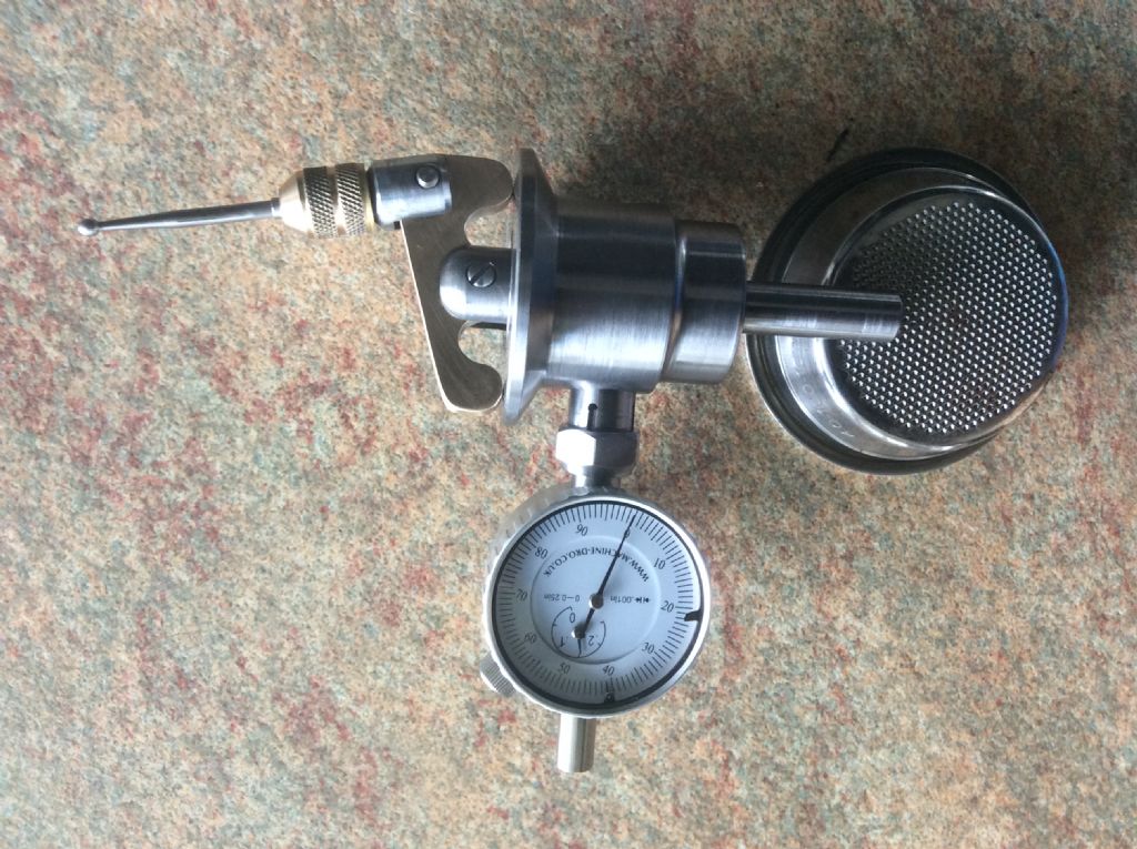

                      bernard towers
                        @bernardtowers37738
                        6dbf7fcb-cf00-40ff-a368-f4334e879ac6.jpegb9906cbc-1406-4979-9b6f-c532f5aa3709.jpegAs I have a small mill (raglan) commercial coax indicators are far too long so made my own. The first one is my own design and the second is from an image from the net. Both work really well and making them fit close to the machine spindle saving even more space
