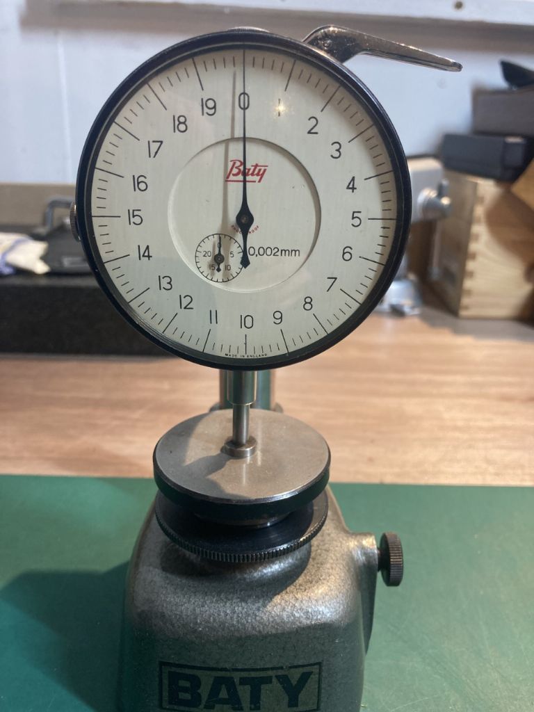

                            Just stumbled on this thread and it prompted me to check out paper thickness using my comparator.

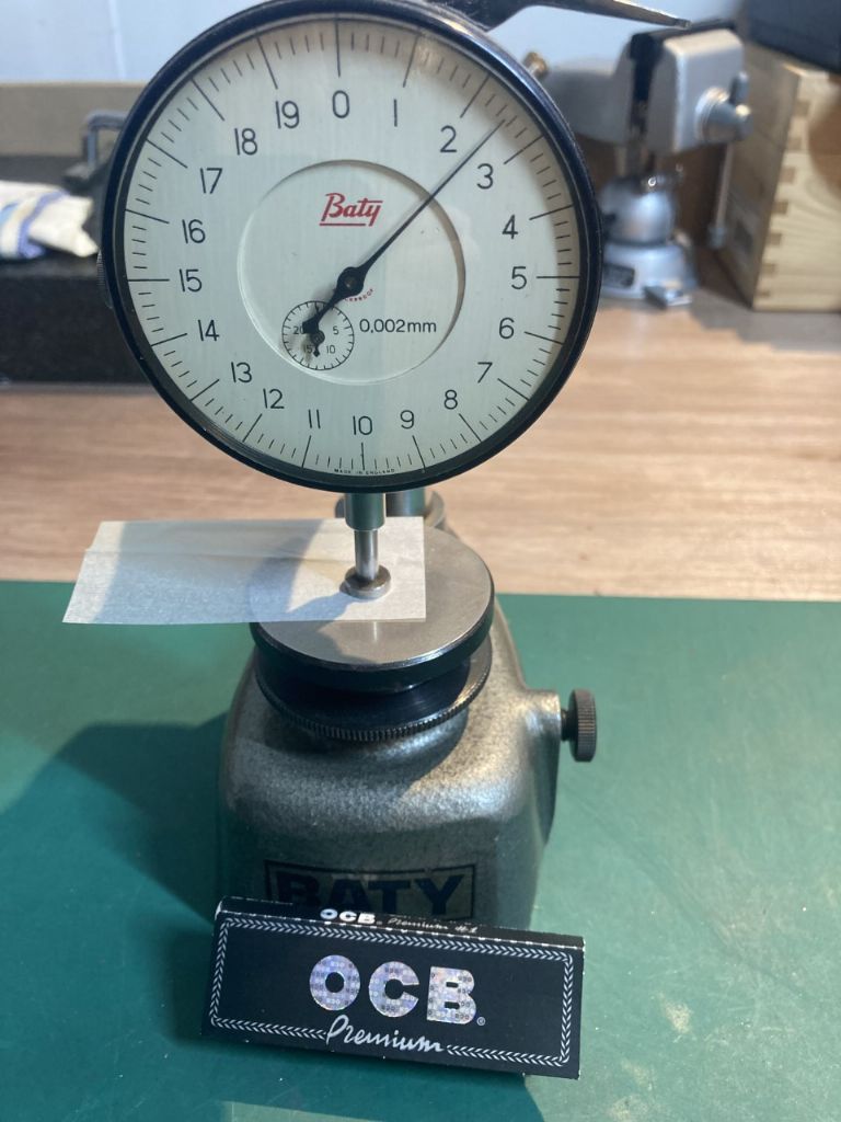

                            I use black OC papers for smoking and workshop use as they seem the thinnest and don't burn down as quick.
                            These appear to be just over 25 microns, handy if you're working in Imperial.

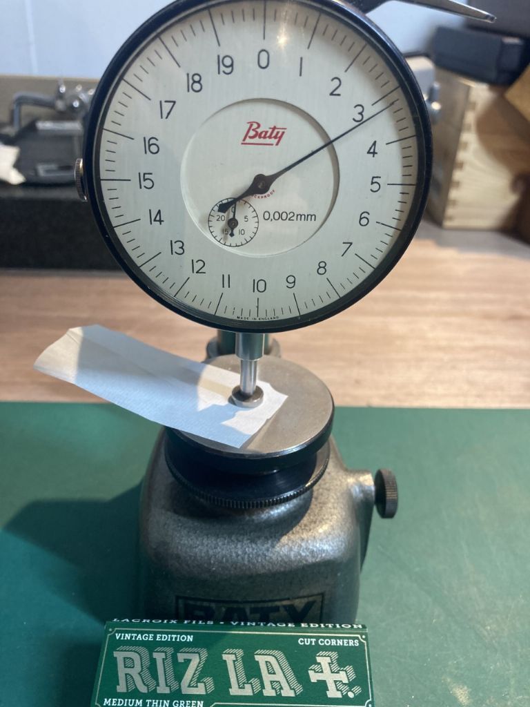

                            The most common rolling paper, the green Rizla, is slightly thicker at 32 microns.
                            I knew I'd find a use for the comparator one day!
