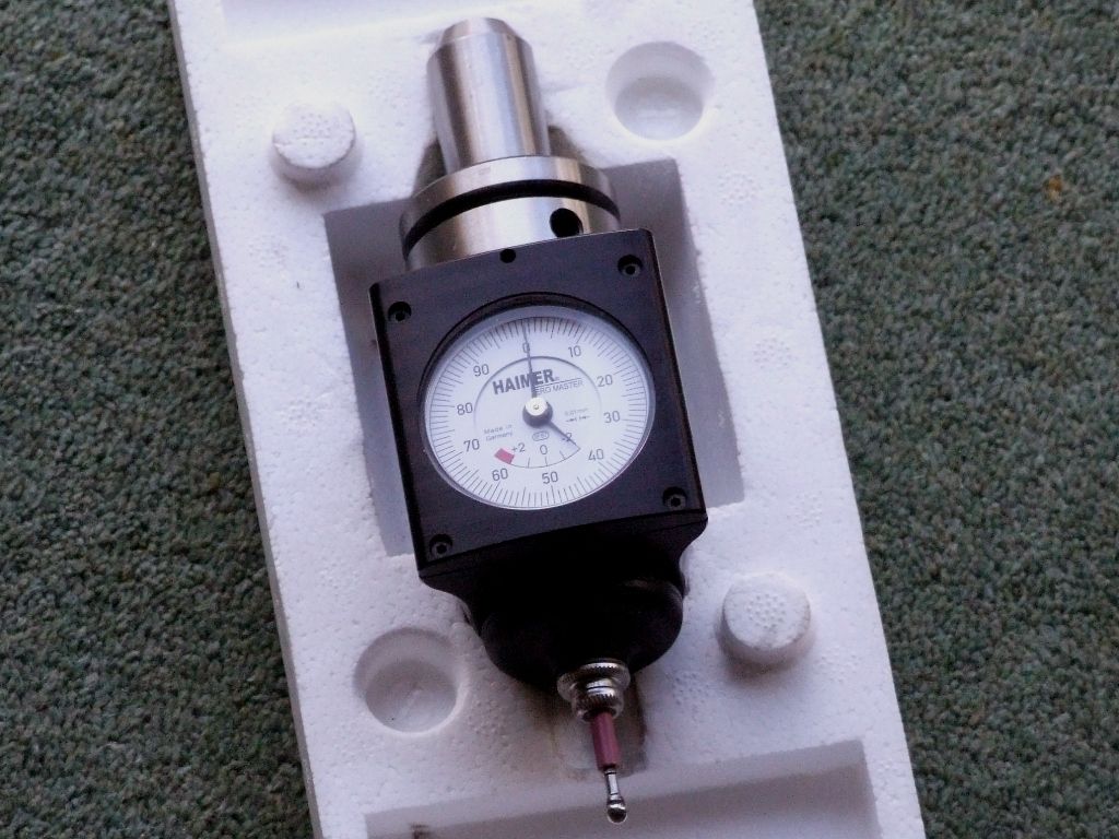

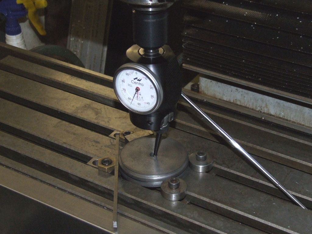

                      I use blue papers, which measure 1 thou thick to the width of the line on the micrometer. I use them for quick 'n' dirty setups on the mills and lathe. For most work on the mills I use this:
                      And this:
