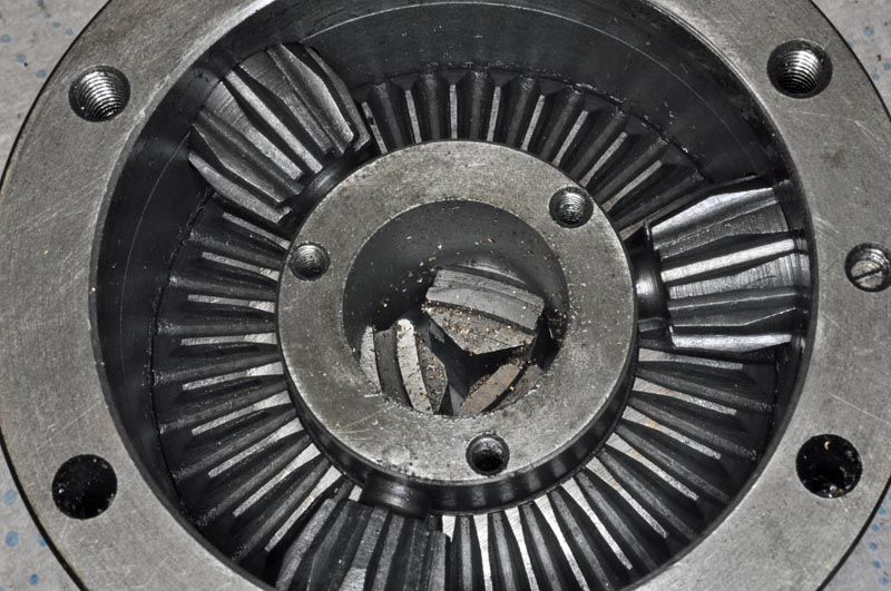

                                              #128181
                                              Roderick Jenkins
                                                @roderickjenkins93242
                                                Prompted by this thread and reminded that Tubal Cain dismantled his chucks every year I thought I'd do the same to my 3 Jaw – the first time I've done this in my 25 odd years of ownership. So, this is the result on opening it up:
                                                Absolutley pristine! No sign of anything having got into the reverse of the scroll or pinions. I think I'll leave it to the next owner to do it again 25 years time.
                                                cheers,
                                                Rod
                                                #128193
                                                roy entwistle
                                                  @royentwistle24699
                                                  Rod No sign of any grease either This could be a contributary factor
                                                  Last time I stripped mine it was clean and I don't grease mine
                                                  Roy
                                                  #128199
                                                  Roderick Jenkins
                                                    I think the cutting fluid finds it's way in but as I use Cutmax 50:50 with paraffin there's no residue. There's an oiler button on the front face so I don't think it was ever greased.
                                                    Rod
