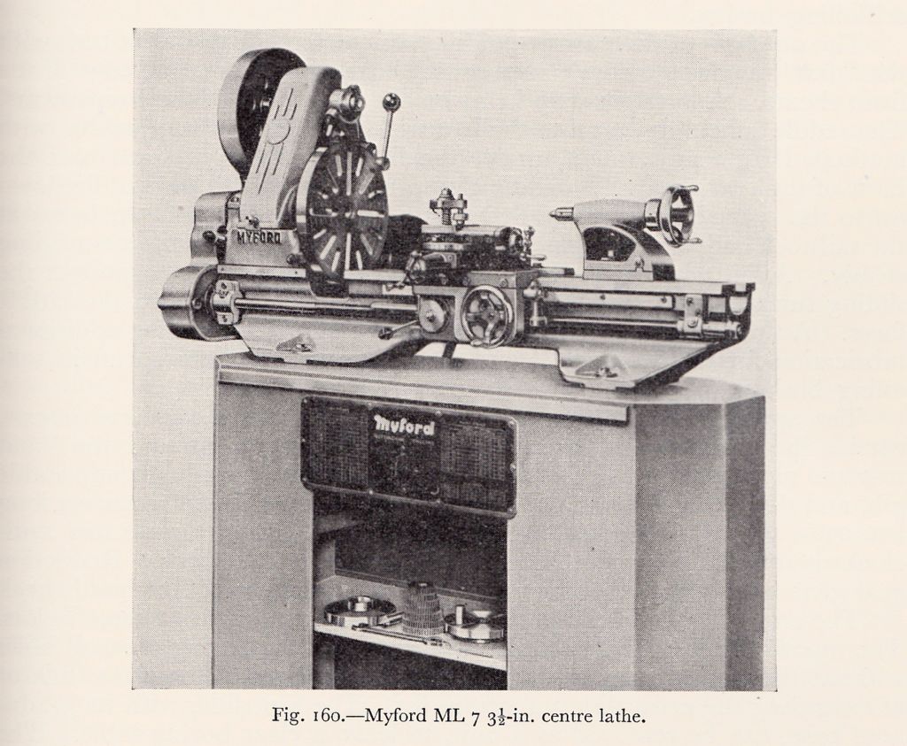

                                                The Merry Miller
                                                  @themerrymiller
                                                  Hi all,
                                                  Below is a text extract and a picture from my one of my Toolmaker's textbook's from 1953.
                                                  The book clearly sets out what equipment etc. would normally be found in the toolroom and I was delighted to see the Myford ML7 noted as an essential toolroom lathe.
                                                  Note the statement in the text that it is "designed for heavy duty"
                                                  I do appreciate that in those days, "heavy duty" in the toolroom would have been a lot different than "heavy duty" on the production line.
                                                  It says a lot about how much it was favoured in the early 1950's as it is even now.
                                                  Len. P.
