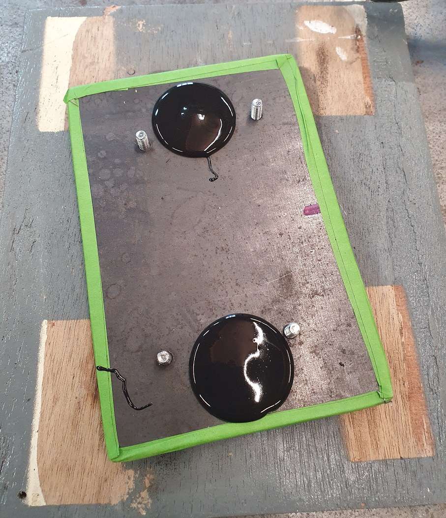

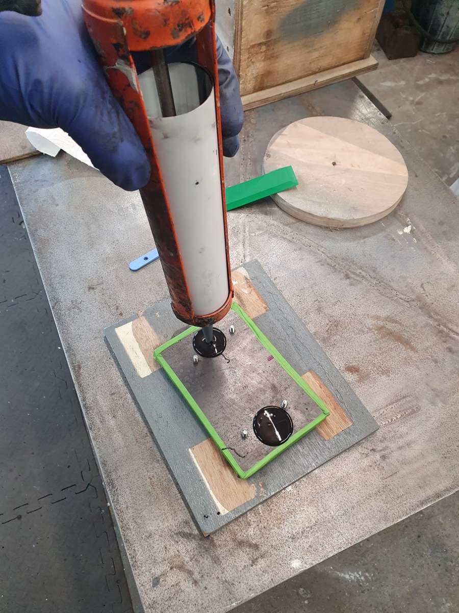

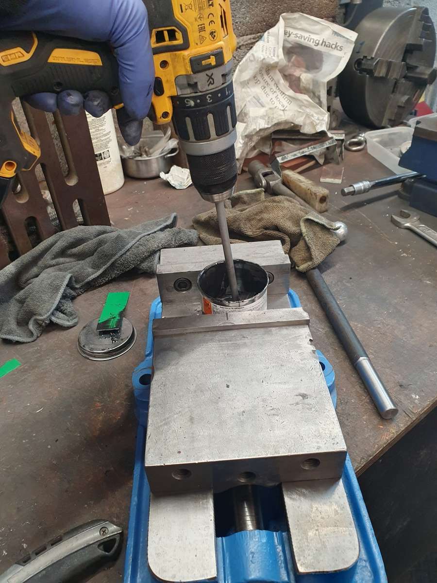

            The resin test.

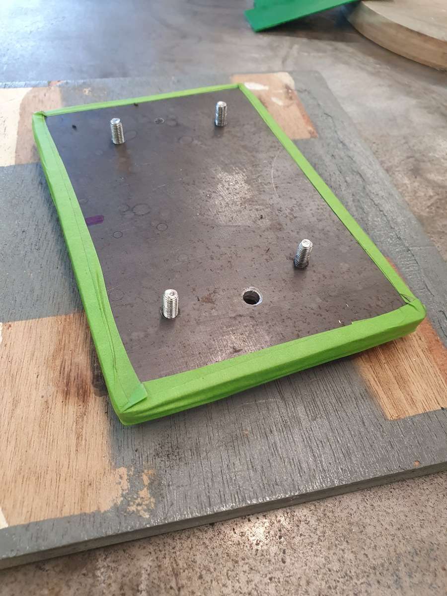

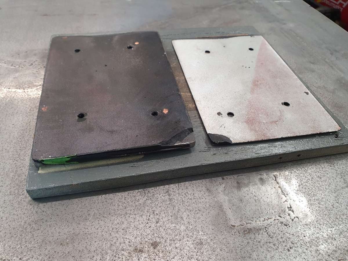

            I placed the resin tins on their edges between a couple of stops and then after a minute or so rotated them all 180 deg to see if they rolled back to first position, reducing the time I left them each time (bare with me!).. I soon found 1 tin that was somewhat less fluid than the others so this would be the test pot. The others seemed pretty good.

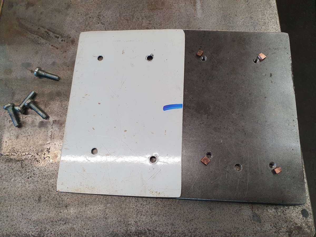

            I made up a pair of test plates, same spacers & gap, same injection point size & vent.
            Resin_Injection_Test_1
            Fixed them together after rubbing some silicone grease onto one of them so I could get it apart after and taped the edges.
            Resin_Injection_Test_2
            I had opened up the pot as instructed and mixed it the day before. To say the solids had separated out was something of an understatement. They needed breaking up and then a freshly turned piece of 4/4 bar began to crush them into submission. Having watched the application video the solids need some serious mixing but this really did. Once broken up I used the supplied paddle mixer in the drill on low speed and that soon learned them, with a little patience I soon had a lovely smooth relatively liquid compound.
            Back to now, opened up the tin, back in with the paddle mixer and once smooth added the hardener. This made it surprisingly runny so the worry about being able to inject it subsided! after a thorough mixing as per instructions, I poured it onto the cartridge, insert a thin steel tig filler rod as a vent and pushed the plunger in. Withdraw the filler rod once all the air was out and set to injecting it.
            Resin_Injection_Test_3  Once it was showing at the vent hole I used a scalpel to just prick the tape at various points around the edge (corners mainly) to vent it and all bar 1 corner was already full of resin, the other corner showed resin almost straight away after pricking the tape there. SUCCESS!
            One thing I did notice was that as the resin came into contact with the cold steel it thickened up considerably. More on that later 😟
            I left a little excess over the holes and left it to cure.
            Resin_Injection_Test_4
            It took longer than expected but then it is old stuff so no bother. On day 3 the bit I left on a piece of board to check curing was rock hard to I separated the plates and here is the result.
            Resin_Injection_Test_5
            Full coverage and proper hard. Not bad.. ready for the main event!

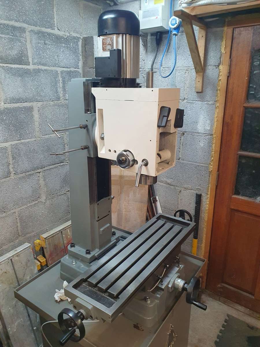

              Morning All..!

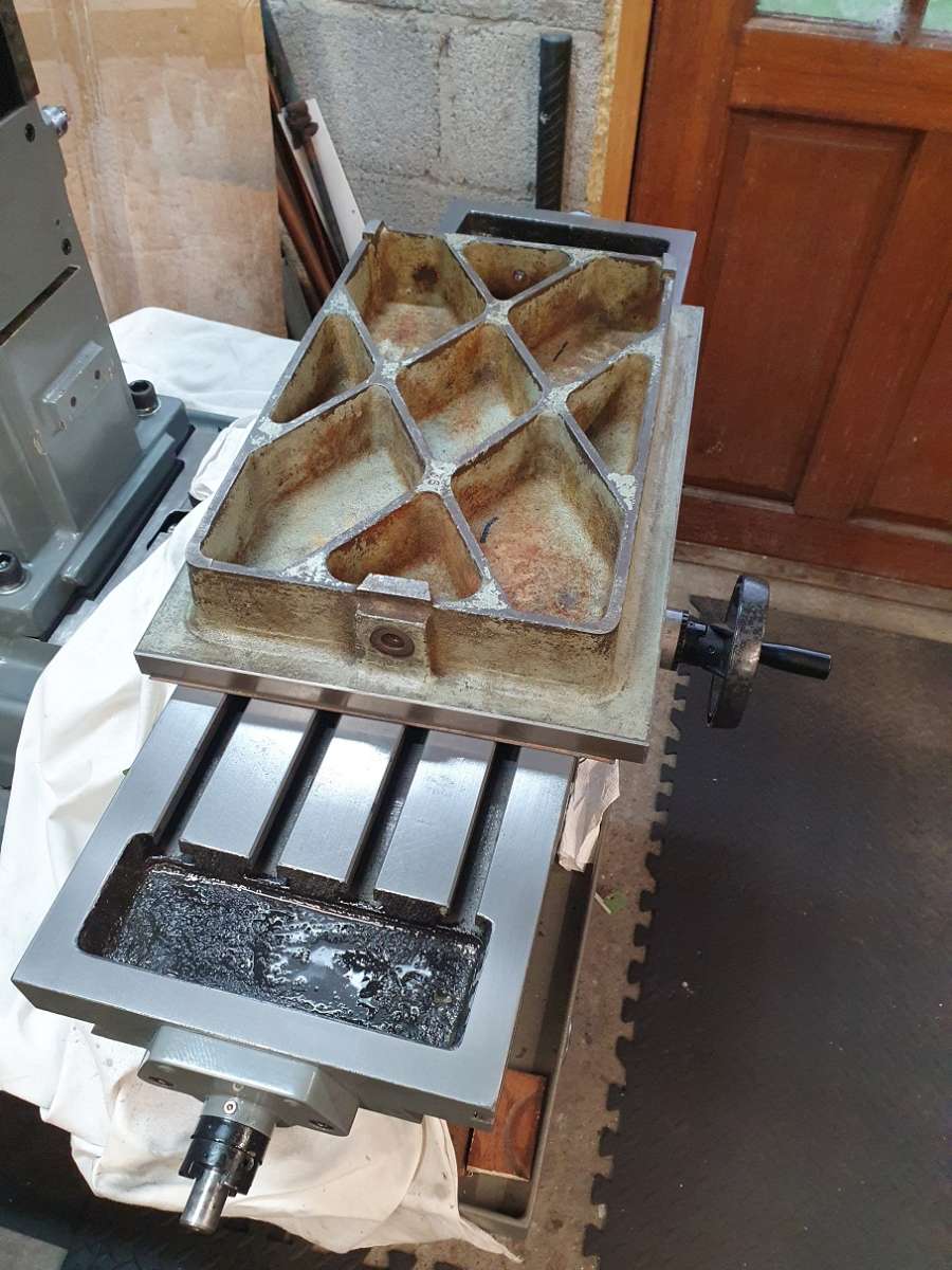

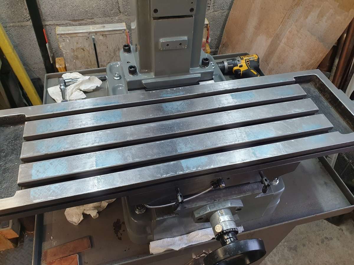

              With the mill now reasonably assembled – i.e. pretty much all the heavy stuff it was time to true up the column.
              Mounting_Column_9
              Aligning_Column_1
              And here comes the next issue.

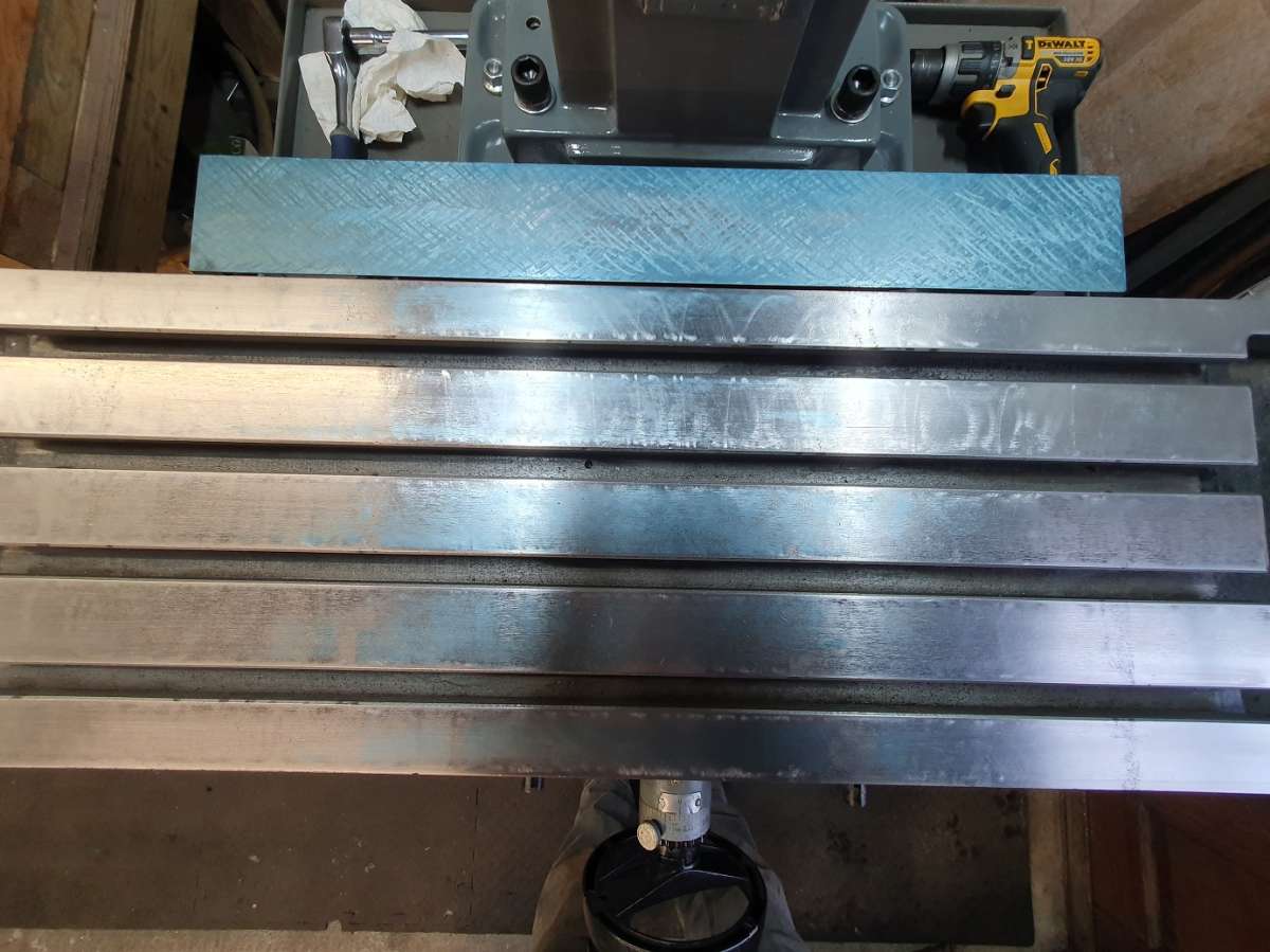

              When I was sorting the table ways, the table upside down on the surface plate there was no rock, the firm tap on each corner produced no ‘clearance sound’, going round with a 1 thou shim revealed no gap but a half thou shim would just about slide in in random places. Perfectly decent I thought, they have something right!
              However, that was purely the outside edge. Every time I took a set of measurements round the table (left front, middle, left rear, right rear .. etc etc) they were different, square on long edge or short edge. I was moving the square around like this in the hope of finding something repeatable as when I just did middle with the square facing each way to prove the measurement, it was always different and a thou out over the shorter base would obviously give a much larger error in the vertical.
              Time for the straight edge.
              Table_Flat_1
              Its hollow in the middle (dam it emoji)
              But it is also ever so slightly bowed down at the ends!
              Table_Flat_2
              To be fair, it really is only a tiny amount but using the square like I was to check it was really showing up on the vertical.
              Not long since, a neighbour offered me a couple of toys in exchange for beer (Jolly decent chap!) .. a cast iron surface plate and a very large square. Both need some cosmetic attention. Once cleaned up I went over the surface plate with a surface gauge and a tenths indicator sticking out about 5 inches and could not believe what I was seeing. it’s only real variation was the remains of the original scraping marks! Everywhere round the plate the indicator showed no more than a couple of tenths difference!
              As that was the only flat thing I had I though I’d treat the table to a bit of lapping. some decent 120 then 240 wet n dry paper (If you need to, do NOT buy the budget pack stuff from Toolstation or the likes, it’s rubbish and falls apart, use a decent motor factors), bit of white spirit for the wet and, thanks to the gantry hoist to move the thing onto the table, a lot of sliding around..
              Table_Flat_3
              It worked a treat (if somewhat time consuming!).
              Back to truing up the column.
              After a it of faffing about, it is within 0.015 left to right (X)and less than 0.01 front to back(Y) -it shows 0 but not sure I believe it! I tried various positions for the square and moved the table around and it still shows the same, also placed the square on my larger steel fairly thick square so it was fully across the table – same results and the same along the table for more contact spread.
              At Last!!

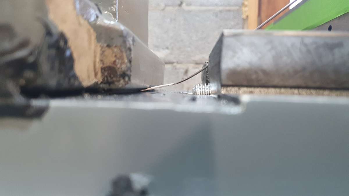

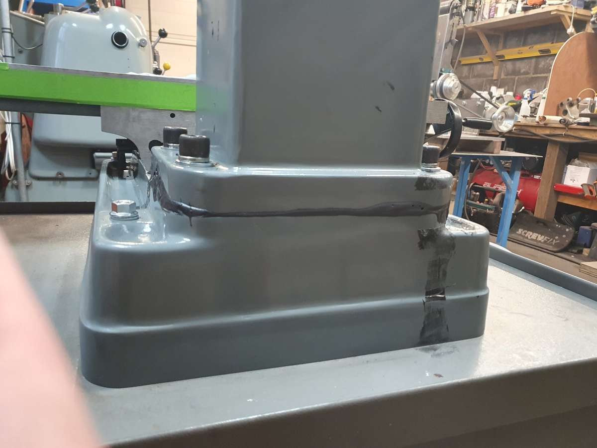

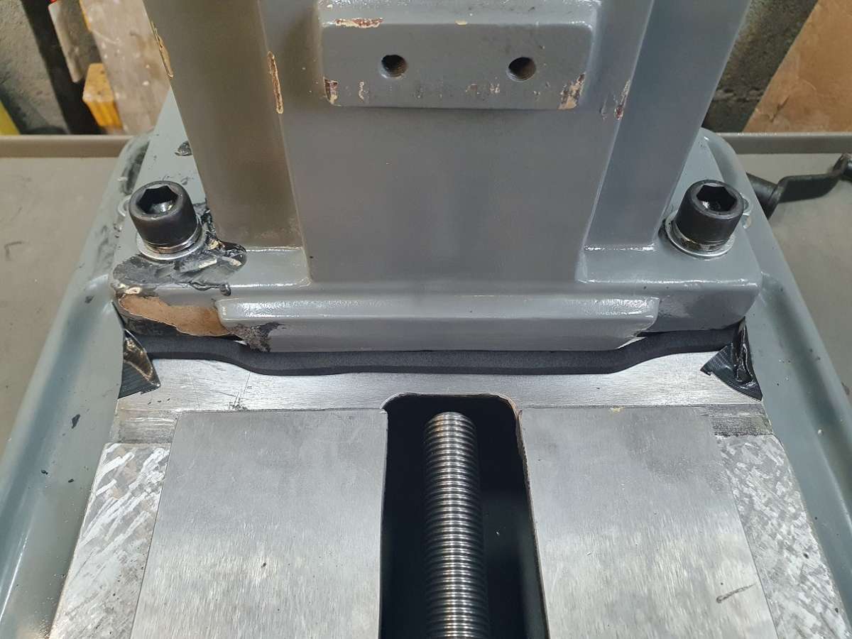

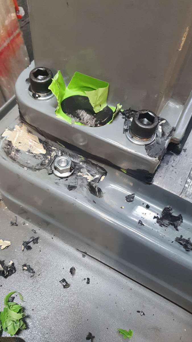

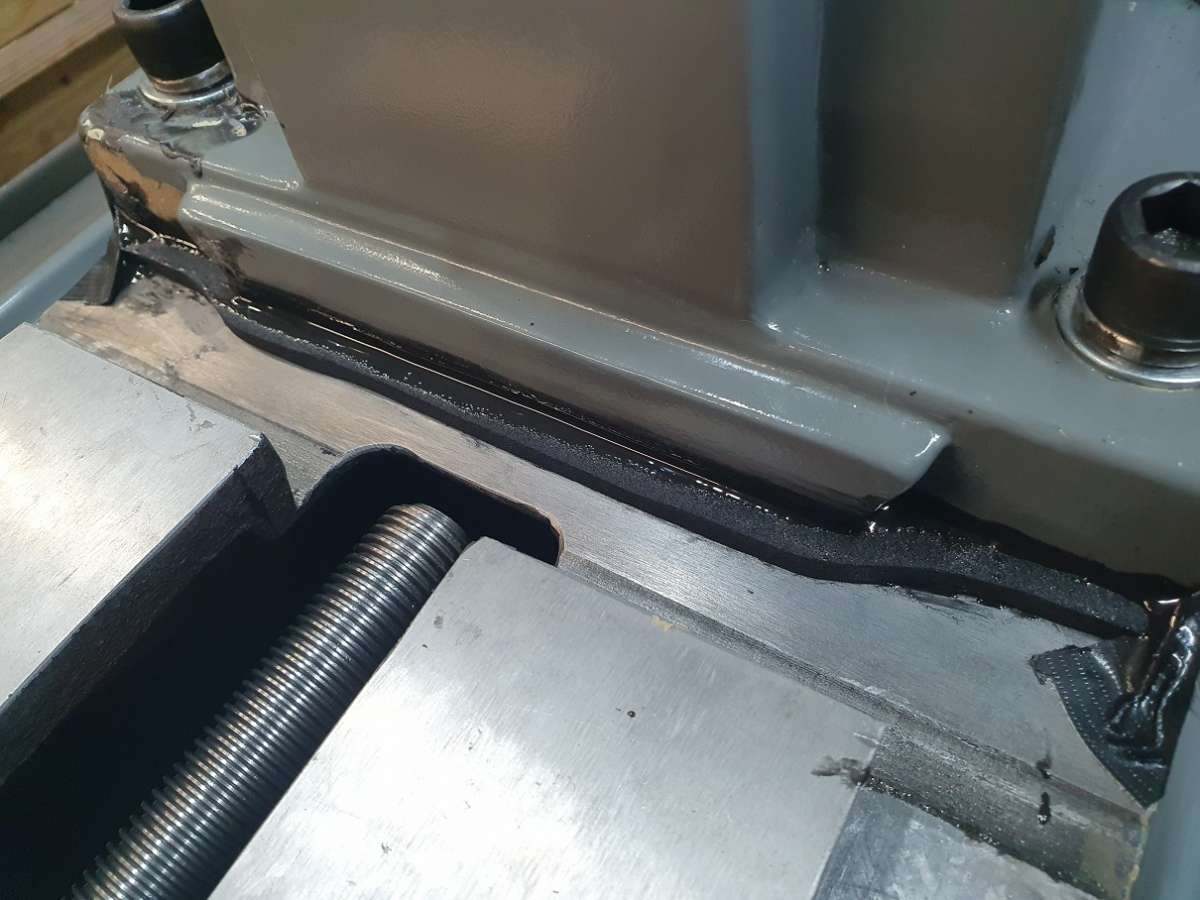

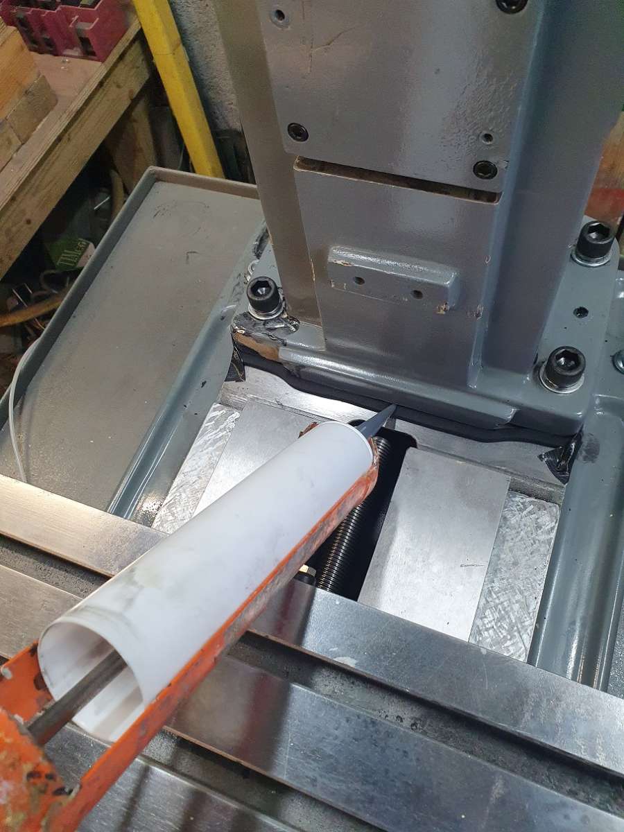

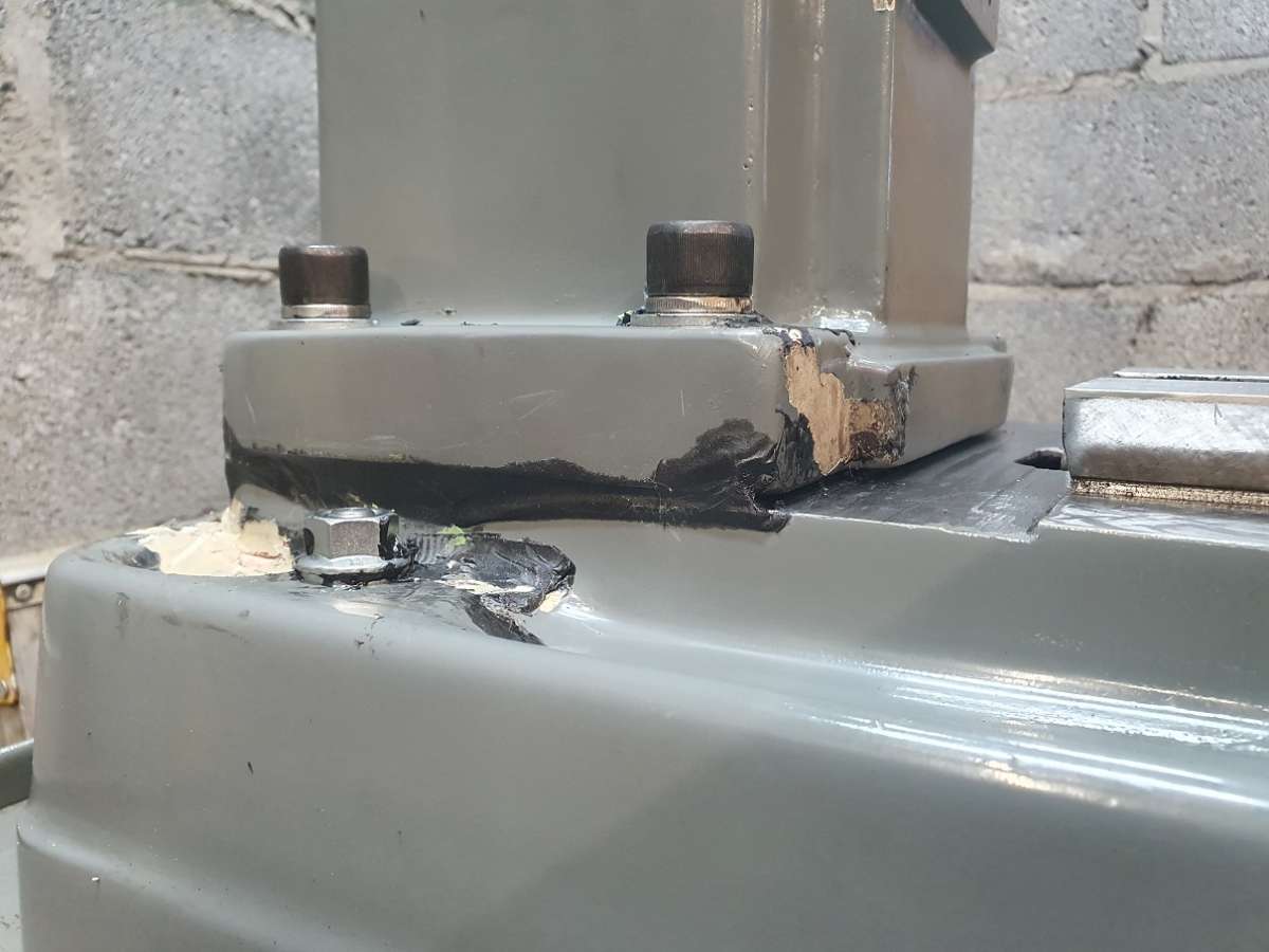

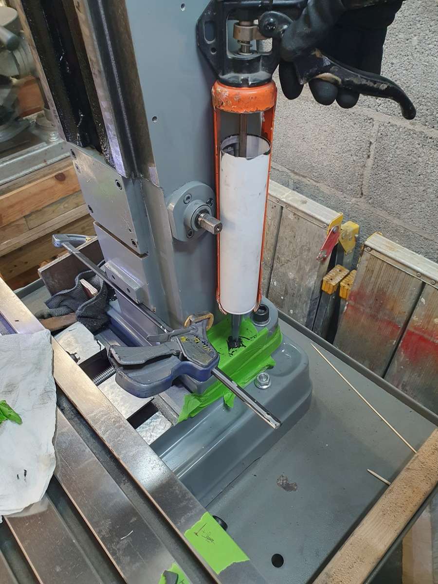

                Finally injecting the resin.
                Now for a bit of an apology.. a friend of mine came down to give me a hand with the resin injection as my lack of a working right hand would really make this go wonky. So trying to get this done in the workable time of the resin I didn’t get much in the way of photo’s but there are a couple.
                The next pot of resin was much easier to mix up and again was thoroughly mixed the day before.
                We taped up the sides and rear – and there was Booboo No1. Not enough / strong enough tape, I think just a coupe more layers to stiffen up the tape would have been the way to go.
                Mixed up the shmoo and poured it into the cartridge.
                (This is a small pot that I used after but there was only 1 pic from the main event!)
                Resin_Injection_6
                Booboo No2 – When I mixed the test pot I was surprised how hot it got and remembered Martin had told me that the reason for the main mixing the day or so before was so too much heat wouldn’t be introduced into the stuff when mixing the hardener in.
                I also remember the cooling effect of the steel on the viscosity of the resin.
                So I didn’t mix this pot as vigorously as the first pot and behold it didn’t get as hot (still pourable though).
                I then failed to realise that the significantly larger cooling effect of a large ish mass of cast iron on the already cooler resin would have fairly disastrous consequences!
                The pic below was after recovering some of the spilling resin back into a cartridge, opening out the vent hole and injecting via that as well!
                Resin_Injection_1
                As you can see on the far side of the column, a rag jammed in with some wood and held with a clamp, the table pushing a small piece of ply on another piece of ply against a leak.
                Once the leading edge of the resin stiffened up too much, the still warm stuff at the injection point thought it great fun to find it’s way out where ever is could. Up through the bolt holes, bulged out the tape so giving it a way to start it’s outward journey from there etc Funnily not from where the foam was across the front edge though. What a mess.
                But.. injecting from the vent hole and pre-venting the tape with pin pricks at the point where the resin had already reached had the desired effect. Resin emerging at all vent points round the taped edge and when poking the foam down a little it was all across the front too. Success!
                Resin_Injection_10
                Resin_Injection_4
                Resin_Injection_3
                Resin_Injection_2

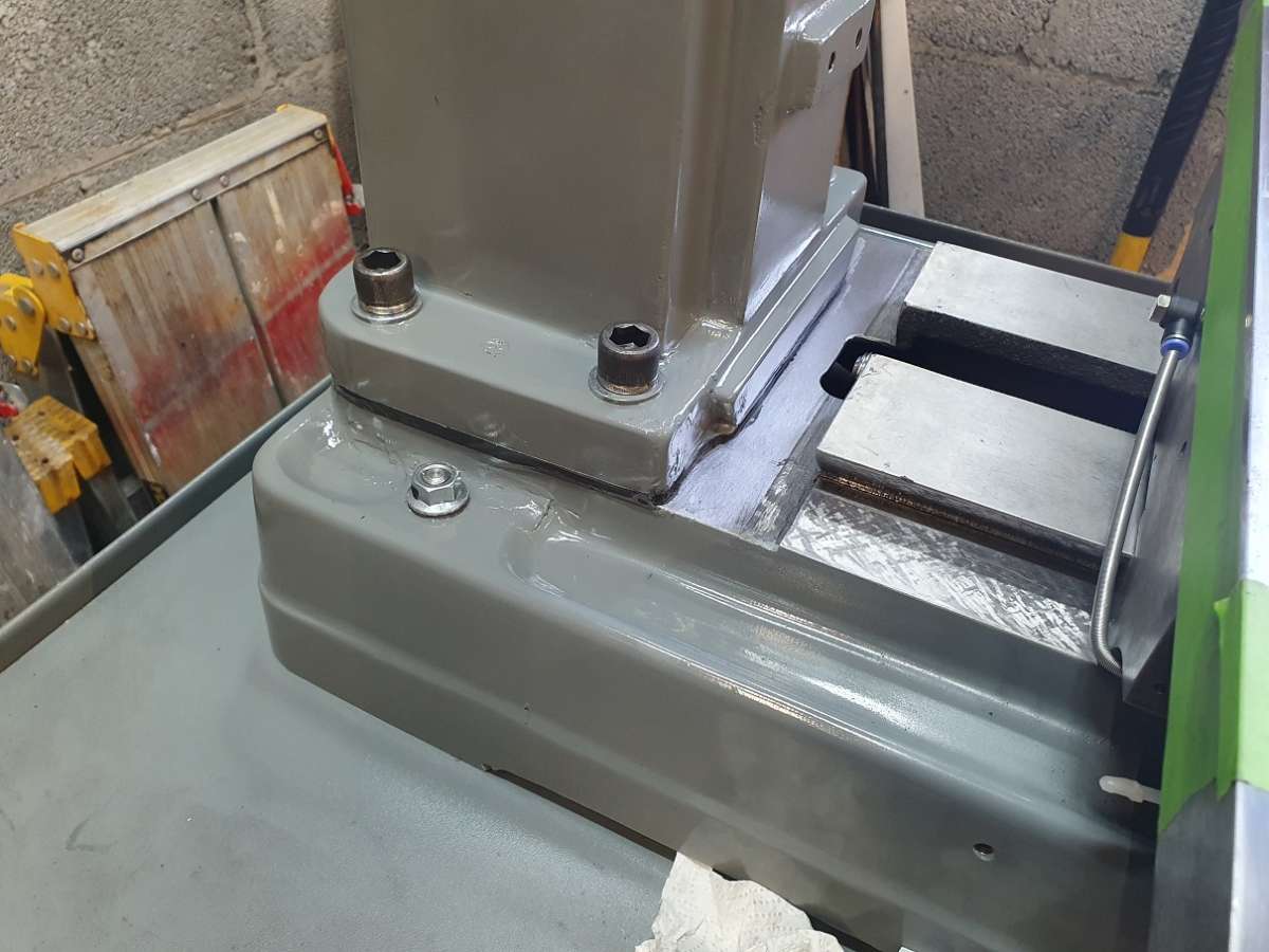

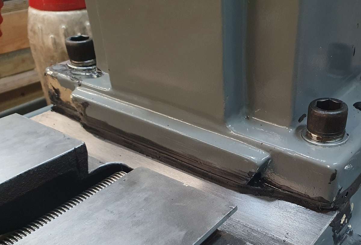

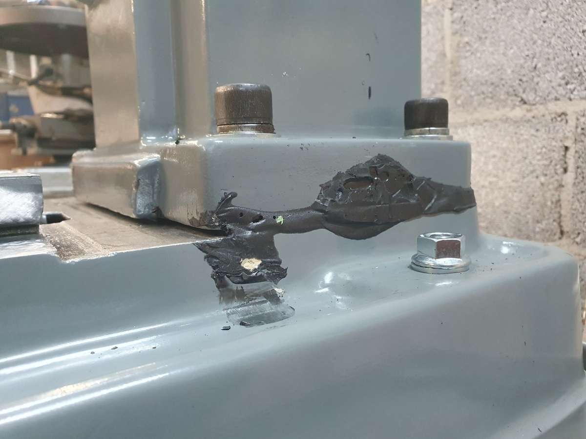

                As you may be able to see , there has already been a serious attempt to remove most of the excess but it’s bond is so good that everything else comes off with it!
                Anyway, it’s full right round. But.. that gap at the front where the foam was seems bigger than I expected. It isn’t much but when I worked out the area, it was over 16cm2 which bearing in mind the relatively small surface area of the total contact due to the different central hole positions between the base and the column is not an insignificant amount.
                Resin_Injection_11 So I cleaned up the area and faces, put another foam tape strip across the front to form a dam as there would be almost no injection pressure, I mixed up the remaining small pot of resin and filled the rest of it.
                Resin_Injection_5
                Resin_Injection_7
                Resin_Injection_8
                Once cured, all removed the foam tape and tidied up – it turned out OK.
                Resin_Injection_9
                All in all, pretty successful in the end, happy enough.
                If I were doing it again..? Set up a small fan heater to pre warm the base and column to around 20 – 25’C and do a far better job of the tape – several layers.
                Next job is to torque down the bolts while checking the column doesn’t move.. fingers crossed!
                Oh.. and a good clean up and touch up the paint.

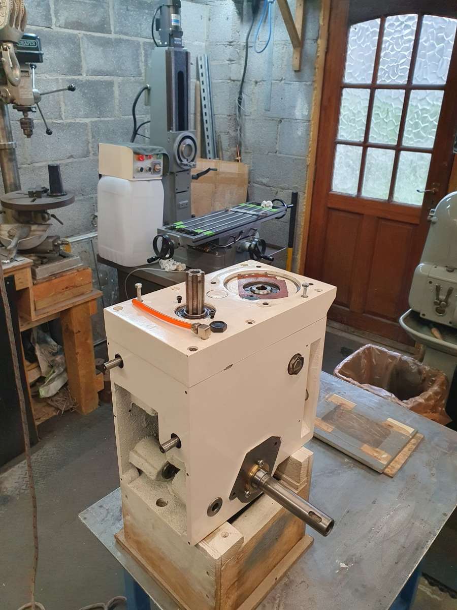

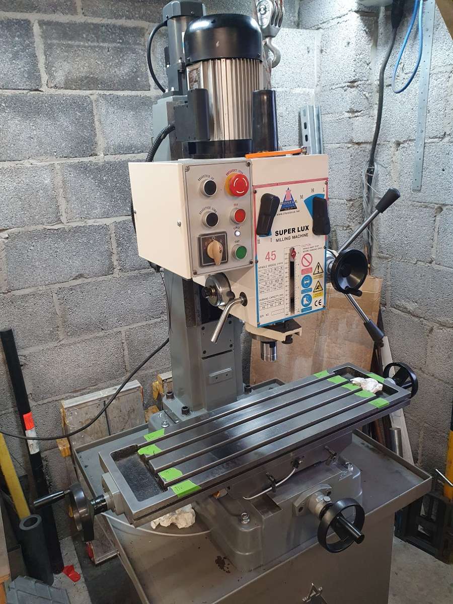

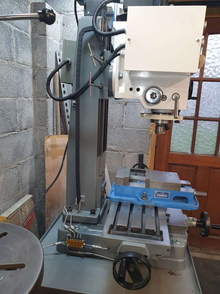

                                    Morning All..!
                                    Taa Daaaaaa!!
                                    Final_Assembly_1

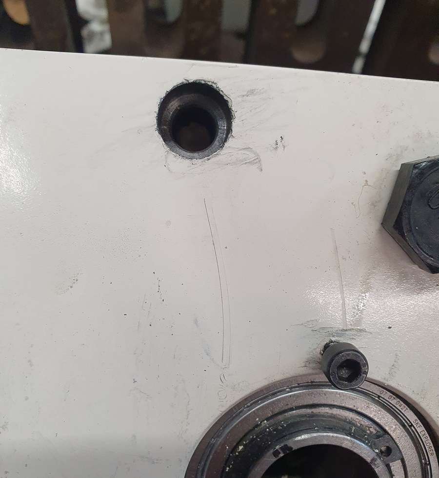

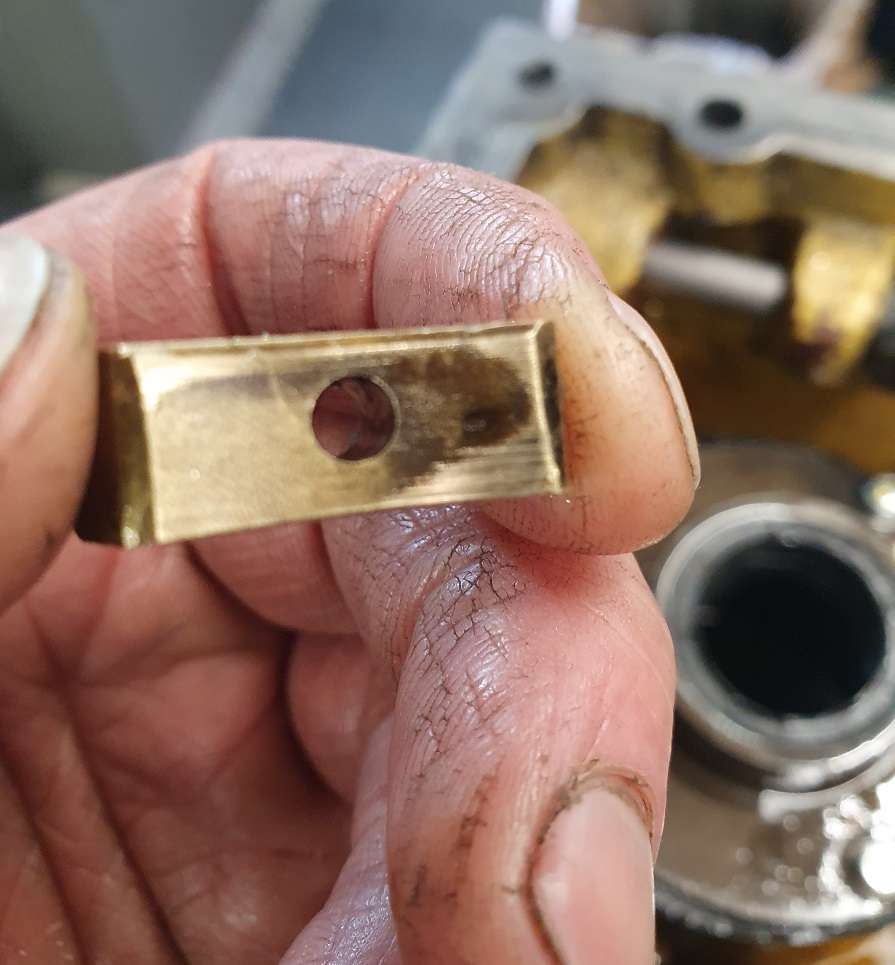

                                    Power on – Check … Power Z drive – Check. All other axis moving properly – Check
                                    Motor Start – **^^$£%^********. ****, *&^**&^*, *******.

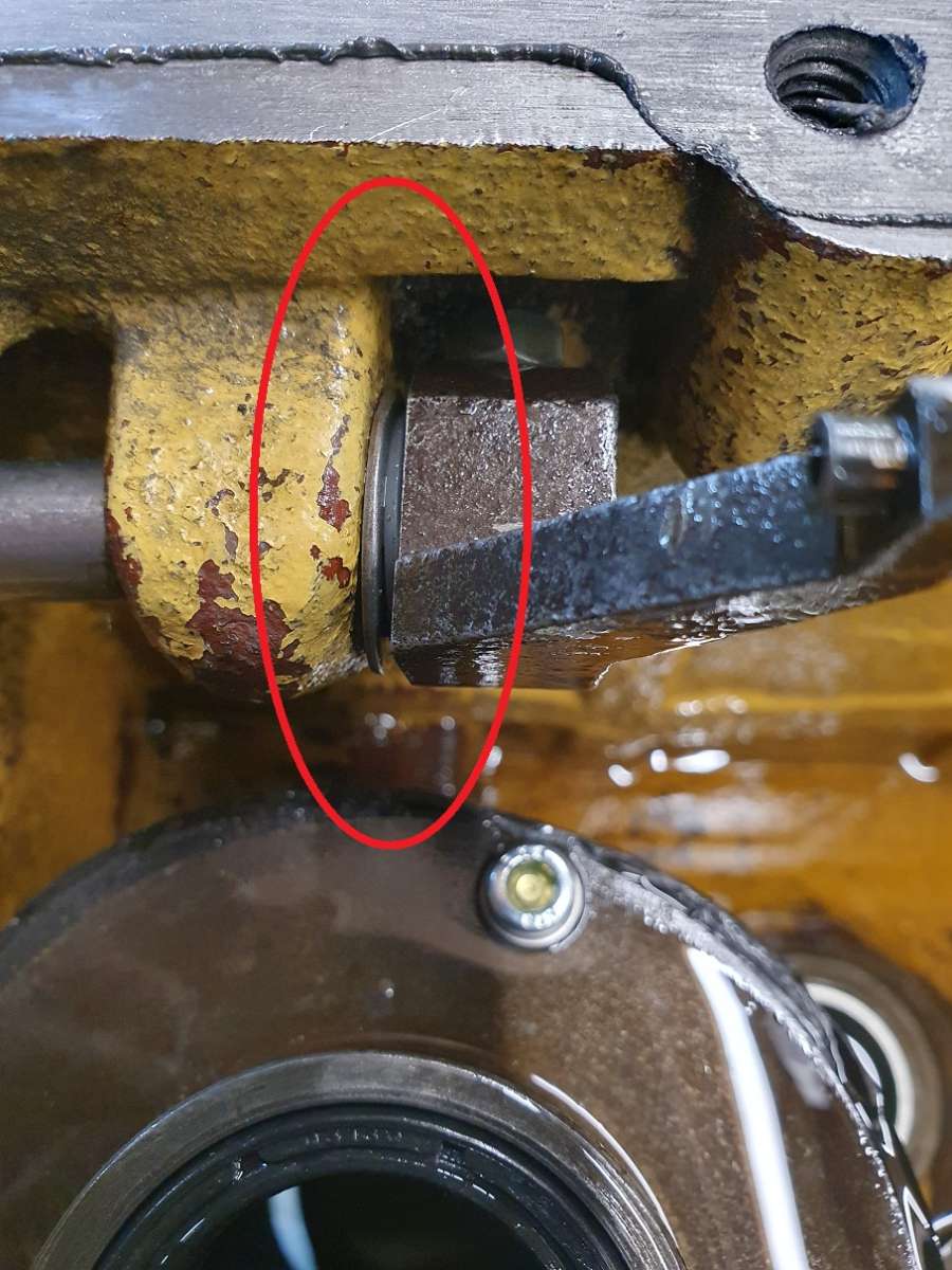

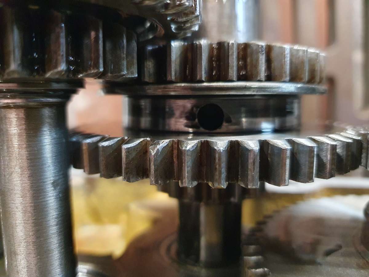

                                    Final_Assembly_2

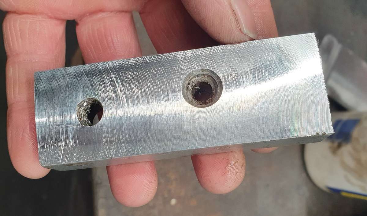

                                    Turing everything over by hand during each test and final assembly, everything felt fine but obviously that wasn’t under motor power. However I’m not sure how something can rotate so freely by hand then make a strange clicking noise and suddenly be a little stiff to change form low to high range.
                                    Strip down and have a gander. I inspected every tooth of every gear although it was worse in low range rather than high. All the gear teeth looked how I’d left them after tidying them up a little with one of those little diamond EZ Lap ‘files’, they were OK bar 1 that has more ware to it than all the others (I presume the previous owner liked that speed!).
                                    Then looking at everything else it was staring me in the face – Hi – Lo shift. My fault!
                                    Final_Assembly_4
                                    Fresh ware and I remembered where the clicking came from having seen it and it’s wonderful workmanship when first inspecting the thing –
                                    Final_Assembly_5
                                    It’s the deep craters where they have attempted to deburr the hole.

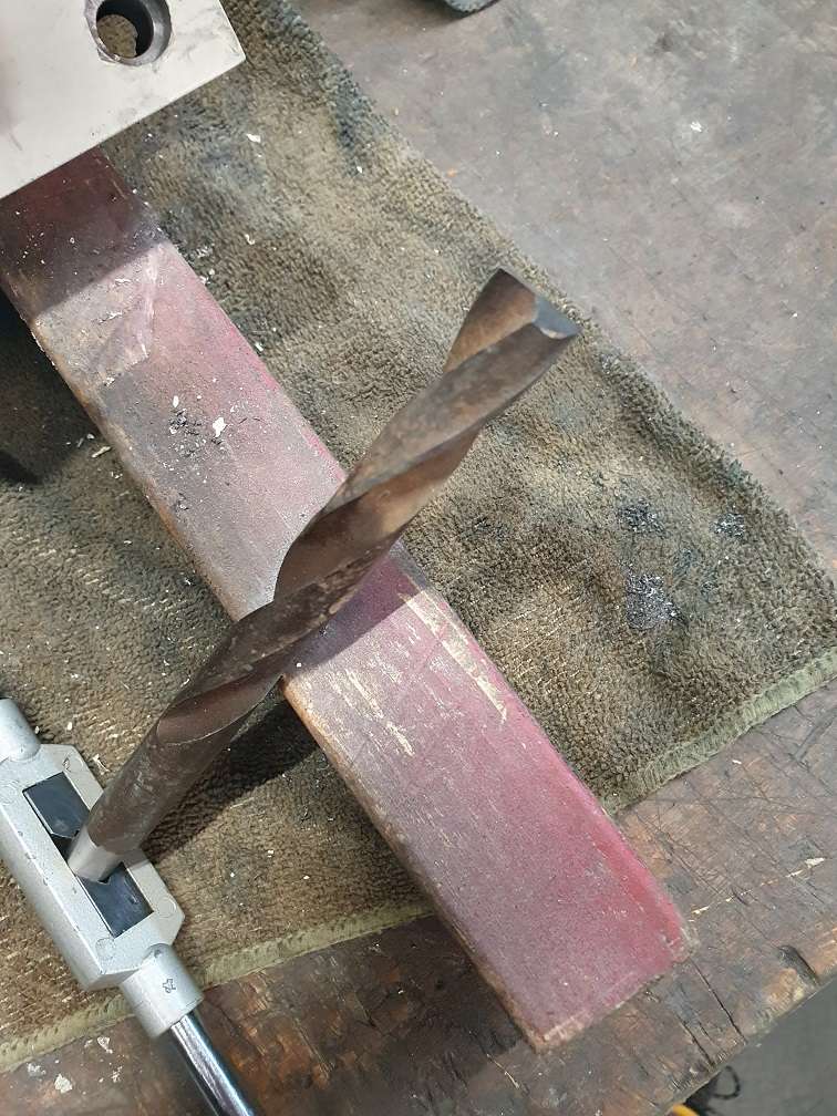

                                    As for the My Fault bit.. well the selector arms were very loose, it was really noticeable when changing gears before the strip down, lots and lots of ‘end float’ on the shafts. so in an attempt to reduce that and make it feel a little better I shimmed the inner ends so there was only a little free play – Obviously not enough!
                                    Final_Assembly_3
                                    With that re shimmed to give a little more freedom and checking the other side it was time to re assemble.
                                    Another thing I noticed was that until all the 6 the bolts were released (top casting to the body of the gear head) the 2 dowel pins that locate the top casting to the body of the mill were impossible to move yet prior to main assemble I checked them and they move freely through the top cover (as they should) but also freely through main casting. The dowels have an M6 tapping in them to remove them if required I suppose.
                                    I knew straight away what to look for and yes.. the chap at the counterboring station when being built had his drill bit in again rather than a socket cap counterbore tool. I found a 9/16 very old drill bit that was suitably butchered (I really must but a set of counterbores for bolts) as the holes are basically 14mm the 9/16 would have a good guide and hand dressed the recess bottoms.
                                    Final_Assembly_6
                                    Final_Assembly_7
                                    Funnily enough when reassembled I could (with only a little force) withdraw and reinsert the dowels properly and I genuinely think the location fit of the drive sleeve to the spindle top is smoother, certainly feels to slide smoother. Bonus!
                                    Ok… Taa Daaaaa!!!! 2.0
                                    Final_Assembly_1
                                    Try again.. All worked perfectly!! All the gears shift fine, a bit noisy but then it is a straight cut gear box so it’s going to be but it is significantly quieter than it was – Excellent!
                                    Phew.

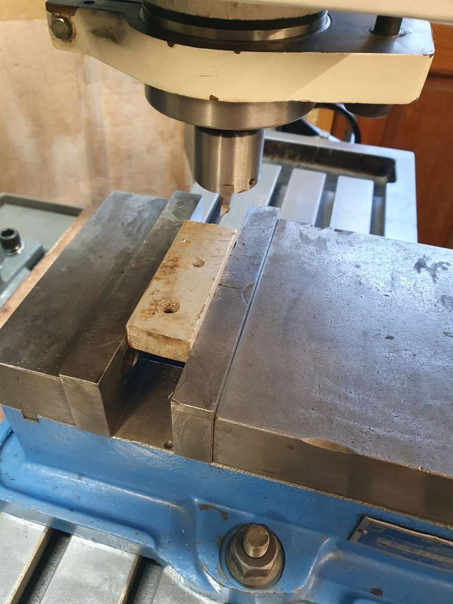

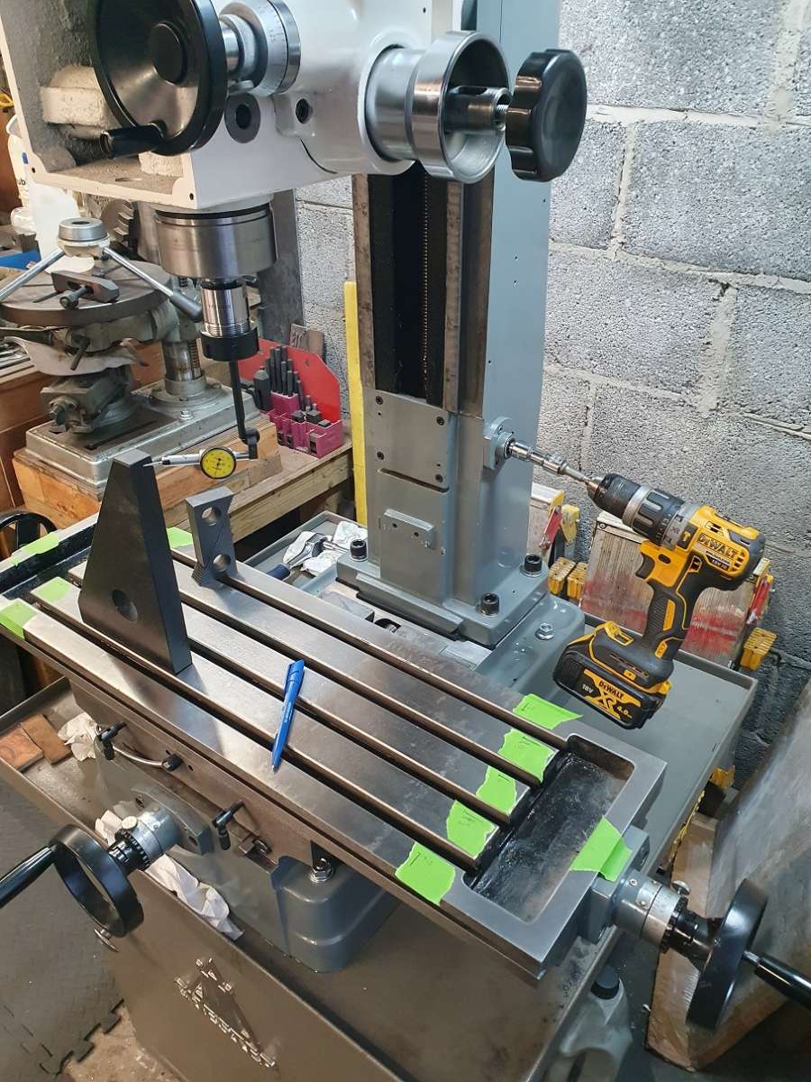

                                      Anyway, all this is a little pointless if the results for trying to fix it’s main problems of head tramming and column tramming are in effective.
                                      I set up an indicator much to the misses displeasure as I used my Christmas present early, my new Noga short arm indicator base (They really are as good as they say!!) and set about tramming in the head. A sweep of around 280mm in X and after a fair bit of tweeking here is the result –
                                      As they say up north, That’ll do!!! Very Very happy indeed!! I wasn’t going to mess about with that any more.
                                      But.. What about in Y? This was the biggest problem as is due to the miss alignment of the Column..
                                      WOW..!! I can breath again now. That has worked better than expected! Less than 0.01mm over table width.
                                      I’m going to call that a success! 😲😁
                                      I checked round a few places and it is all within 0.01mm so proper happy.
                                      Just to finish the oiling system now and I suppose I’m going to have to use the thing!

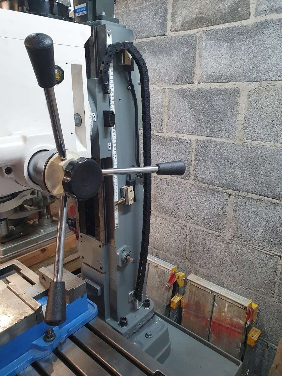

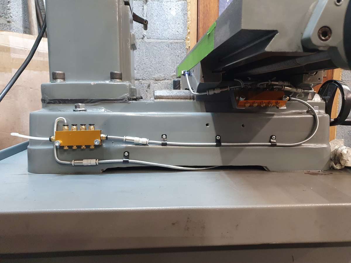

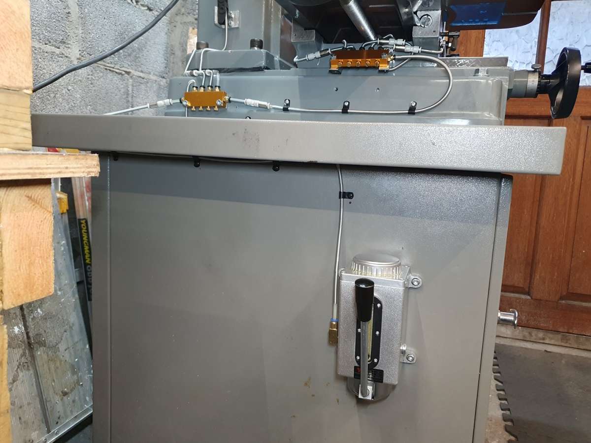

                                        Had a pretty quiet Christmas etc, but did manage to get a couple of hours in the workshop over the last month, and actually got round to doing a few bits!
                                        First job was to finish the oiling system. I got the 2nd manifold mounted and plumbed to the pump but then decided to wait until I got a couple of lengths of drag chain from china (proper cheap but it isn’t doing a lot!) to finish off the vertical saddle supply.
                                        The manifold.
                                        Oiling_Sys_1
                                        The pump.
                                        Oiling_Sys_2
                                        The R/H Drag chain carrying the oil pipe to the vertical saddle. The brackets for this are angled outwards so everything clears the vertical limit switches. It’s hard to see but there is small ally bracket around half way up the drag chain for support.
                                        Oiling_Sys_3
                                        And the L/H set up. Same again with the small support bracket.
                                        Oiling_Sys_4
                                        All those little check valves seem to be working really well, I did have to remove 1 and clean it through but been fine ever since. all the lines stay full of oil and the whole system seems to be working really well.
                                        I’m sure I’ll be tweaking the metering valves a little but they only just need to be cracked open for it to work well. Pleased with that.
                                        Problems..? Yes. I’m going to have to lengthen and re route the rear table oil supply pipe as it is going to be in the way of fitting way covers. No biggie. The main problem I see is if I do decide to keep this mill then how am I going to fit DRO scales, the table oiling fittings are surely going to be in the way. will need to look at that a little closer.

                                          As I’ve said before, it was trying to fly cut a piece of aluminium that started this whole mission yet despite turning the workshop upside down I can not find the piece that I tried to cut so sorry, no before and after pic.
                                          It was a section of ally that was around 2″ x 3″ but no matter what I did the result was not even as flat as the Preseli Mountains – peaks and gouges all across it.
                                          Anyway, I found the ground HSS cutter that I used originally, I did check that it was still sharp but didn’t want to regrind it (it wasn’t a particularly good grind it was just what was in the box with the cutter) as I wanted a direct comparison. I put it in the fly cutter that I used before and set to cutting a scrap piece of ally that I had laying around, slightly smaller but similar.
                                          First_Chips_1
                                          About the same depth of cut (about 0.25mm), but this time I sped up the feed (by hand unfortunately) as I literally just wanted a test cut to see the main cut and back cut to make sure things were going as they should.
                                          Press the green button and start turning the wheel….
                                          The result
                                          First_Chips_2
                                          The cutter clearly needs regrinding to a decent sharp point and the feed rate is (as said) way tooooo fast but the result is a whole world away from the result I originally had!
                                          Both main and back cut clearly visible and the finish is seriously smooth – it took me ages to get the light on it just right to show the detail of the cut.
                                          Phew!!!!!! Utter relief.
                                          I have since done some roughing out on a big chunk of a wood splitting hammer head whittling it down to make a new clamp for my fixed steady for the lathe which has been good for sussing out the overall performance but more on that next.
                                          Anyway, she lives!!! best I start using the thing now.

                                              To the conclusions..
                                              The gear head is a world away from the grindy noisy thing that it was, it is now easy to shift, sooo much smoother and quieter but obviously being a straight cut gear head it is always going to be somewhat noisy. Happy enough with that. The motor however has something loose (not really looked yet) and depending on the cut and speed can make a noise akin to the chatter of a cut on an unsupported 10 inch stick out of an inch bar in a lathe! Frightened the life out of me at first. Could be the fan shroud.
                                              Being able to tram the head relatively easily is great.
                                              The simple fact that all the axis are really true to one another is hard to get excited about as that is how it should be but I’m allowing myself to have a celebratory pint over that one, it was a LOT of work.
                                              The oiling system seems to be doing exactly what it is intended to do, everything is getting a nice dose of oil as it should but I’ll keep monitoring it as loosing supply to something would not be too pleasing after all this.
                                              The base unit that is the original Chester unit is utterly useless. First made obvious then doing the first fly cut, it’s like the machine is sitting on a wobbly drum. It is about as rigid as a jelly. Probably going to me next mission, get some decent box section and build a proper solid heavy base.
                                              Overall, everything is smooth. I have to admit I am very happy indeed.
