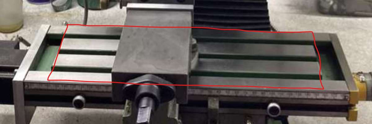

      Hi,
      I am looking into Warco WM14, WM14B, WM16, WM16B, WM18 and GH.
      All of them mentioning about table size. But it is not mentioning usable size.
      For example according to below sample picture, what is the red outline area for any of the machines?
      Screenshot 2026-10-28 121155
      WM14 table size: 500 X 140mm
      WM16 table size: 700 x 180mm
      WM18 table size: 840 x 210mm
      GH table size: 800 x 240mm
      But I need mountable area size like in picture.
      Thank you so much

        WM 16B 2018 vintage
        Overall width of table 180 mm
        Length of tee-slot section 590 mm
        Measured with a steel tape.

          My WM14 has the earlier smaller table (400 x 120), but if you deduct 70mm from the overall length that will give you the red area marked in your pic.
