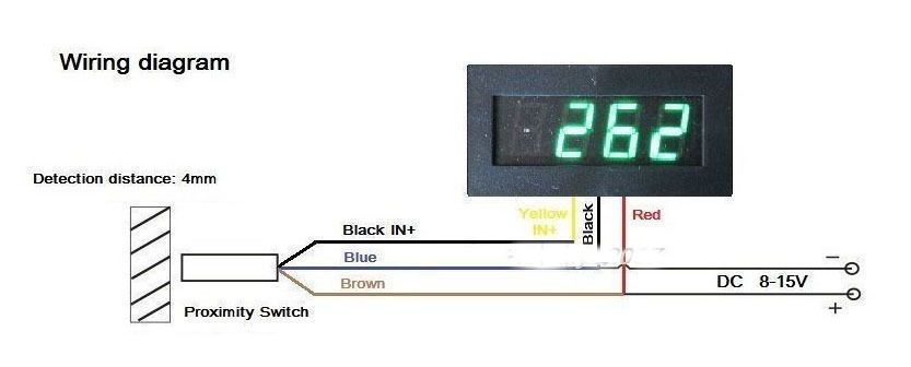

      rev counter.jpgdoes any one know how to use/wire up one of these cheap Chinese rev counter units . They don't come with any instructions ,
      regards Phil

            Hi Phil when you set it up make sure you put the magnet in the right way up the one i had would not work then i discovered turn magnet over and it worked.Graham

              There's a lot of info. in this previous thread:-**LINK**

                Doesn't the magnet cause imbalance?
                #220843
                  Posted by Gary Wooding on 13/01/2016 08:16:39:
                  Gary,
                  In theory, I suppose it must … But the one supplied is very small and light.
                  #220844
                  Howi
                    @howi
                    The Magnet is 5mm in dia and 3 mm thick, hardley likely to cause imbalance.  smiley

                      thanks ever so much , I might be able to get it to work now !!!

                        This got my counter to work first time, from a thread a few weeks ago.

                          If the mass of the magnet really is a problem, make up a dummy in brass or stainless and mount it opposite the real one.
                          I have used on the these tachos on my Champion 20V mill, and it gives a much steadier reading (ie slower changes) than the original. And surprisingly, they do agree pretty well …

                            I bought a cheap Chinese rev counter for my milling machine and spent a long time trying to get it to read off the magnet that I had installed. I only got it to work when someone suggested that I had a Hall Effect Sensor that did not require a magnet and would read off the shallow hole that I dad drilled to mount the magnet.
