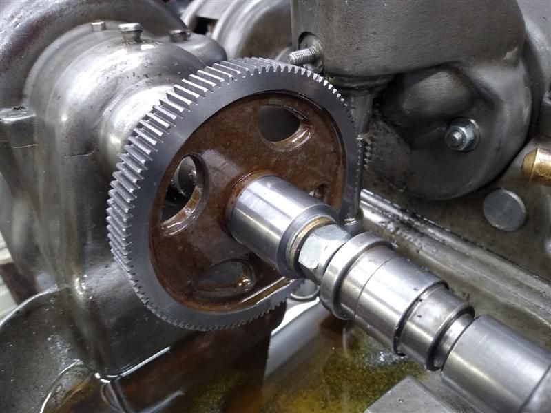

                          #489451
                          Pete Rimmer
                            @peterimmer30576
                            500 grade SG iron shouldn't be a problem to machine. This is 600 grade and it came out beautifully.
