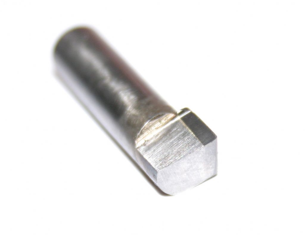

                  Hi Rick
                  Here is a toolbit for a boring bar, with a brazed carbide tip.
                  The carbide was from a scrap masonry drill, and is 1 mm thick. It is silver soldered to a 6mm diameter piece of silver steel rod. The solder was a small flake flattened from silver solder wire.
                  The carbide was tied on with steel wire after cleaning & fluxing. This stops it from moving as the flux is heated. The wire is removed when grinding to shape with a diamond wheel. You can just about see the solder line, surface tension pulls the carbide onto the steel stock. The assembly was allowed to cool slowly as noted by Keith (CuP) above.
                  I used this when line-boring sintered bronze camshaft bushes in a vintage car engine. For some reason sintered bronze "oilite" is quite abrasive and HSS bits tended to wear. I used similar bits when boring iron castings for a Quorn. This bit did not need re-sharpening during the job.
