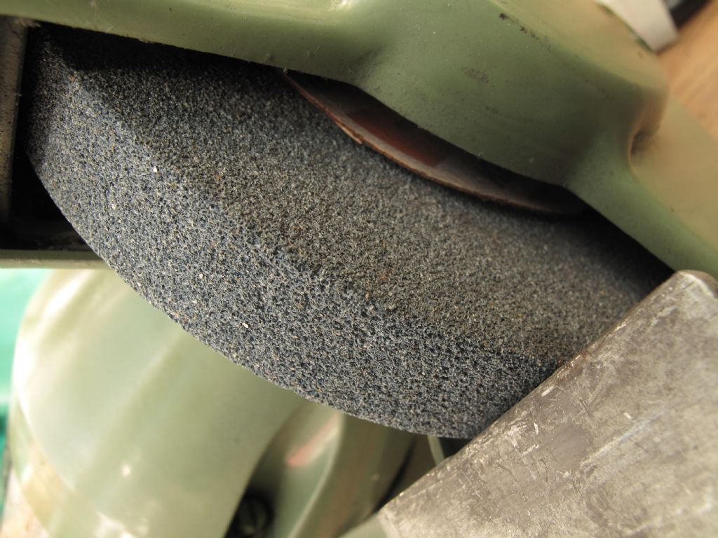

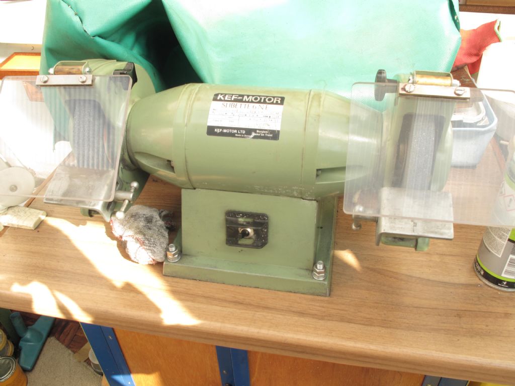

              img_4925.jpgJust to add some further detail its a kef motor grinder. Its had faily constant use, bolted down to a steel bench and has no vibration issues except on startup and de-celeration and even then its not that noticeable.
              The course and fine disks fitted are a blue composite that looks similar to carborundrum.
              I will add a picture later.

                #493666
                jon hill 3
                  @jonhill3
                  Pics of the coarse and fine disks for identification if anyone knows what type they are?
                  #493671
                  Nicholas Farr
                    @nicholasfarr14254
                    Hi Jon, they look like vitrified wheels to me, but one way to find out is to take them off and see if there is a classification code on the blotting paper. The top picture looks as if the blotting paper is actually degrading, it is important that these should be sound. Mounting the Wheels info below.Abrasive Wheel Mounting.jpg
