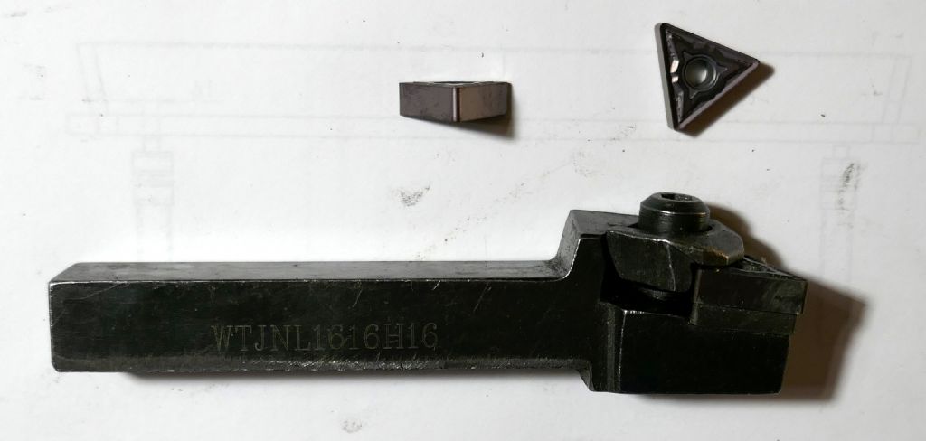

      I was given a box of various tool inserts that came from a closed down engineering company. There were some of these. They appear to be double sided. Giving 6 cutting surfaces, but no angle on the cutter. Do these fit some sort of holder that is at an angle to get the correct cut.

          you are correct, they are also intended to have an insert shaped blank beneath them and fit tool holders around 25mm square +
          Big stuff
          #456851
            Probably TNMG
            The lack of side relief "N" and what looks like quite a large tip radius would mean they are not ideal for your Myford so save your money getting a holder. They are better suited to heavy machines capable of heavy cuts.

                I use TNMG frequently, the 16mm size which is too big for a Myford unfortunately, and have never seen smaller ones. I have about 6 different grades for steel, cast iron and stainless, as well as the aluminium grade which is good for finishing cuts on all types of ferrous except the harder steels. You get six edges per insert unless loosing an end ruins the other side at the same time. If yours are too big to use on your lathe, then they make great scrapers screwed on to a handle, and the edges can be sharpened by rubbing on a coarse diamond lap.                                    Because they do not have any relief, they are held in the tool at a 7 degree downward angle on an axis through the tip and the centre hole.

                      I use that type of 16mm insert on my Southbend lathe which is a similar size to a Myford and the cutter is my first choice for machining. They are very robust and can leave a good finish and last forever (almost). The 6 cutting edges are a bonus, making them very economical.
                      I did however, have to machine a bit off the bottom of the tool holder as they were sitting too high.

                          These toolholders were not expensive and bought on ebay. The holder was not hardened and machined as though it was MS. They have a wedge type clamp and a decent size screw for holding the insert, much more rigid than a screw thru the insert. They stand up to a lot of abuse and I have not had an insert break. (turning irregular shapes, rough cast iron, etc).

                              You can use the mill to take off the required amount off the bottom of the lathe tools. HSS cutters may not fare well on the steel of the tool shank. I buy 20mm tooling and reduce the height to 17.52mm using a shell mill with carbide inserts intended for steel. The inserts do not last long doing this.
