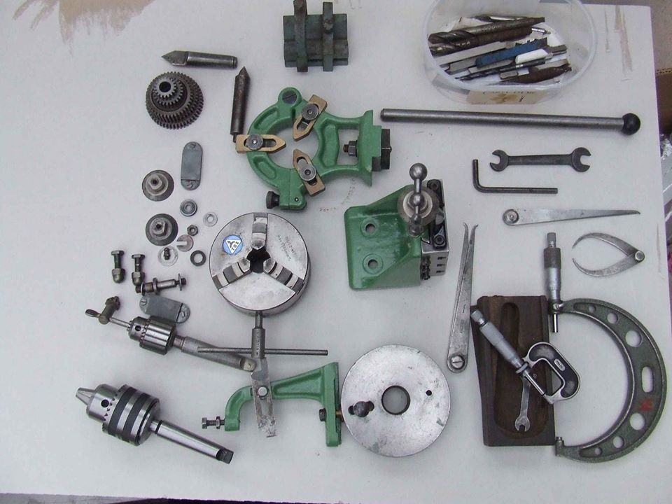

  • #481361
    Jacob Brown
      @jacobbrown

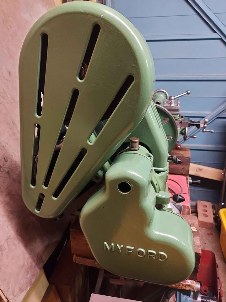

      Hi.
      I want to dive into world of metal turning. I been thinking about staying away from chinese machinery and get old English lathe with good reputation. Right now i got opportunity to buy Myford ML7. Judging by pictures it seems to be example in reasonable condition, however what bothers me is state of lathe bed from head stock side. It's got a lot of marks and scratches. Would you buy it for 1k? What are your thoughts on it? Don't think me rude for not replying to messages but I won't be online until afternoon. Thank you for help in advance.myford2.jpg

          A few scratches and dings happen and needn't be meaningful any more than an immaculate paint job means much apart from that someone cleaned it up at some stage and probably resprayed. Myford afficianados are almost a religeous sectsmiley
          What matters is whether the thing has meaningful wear on beds and drive and what sorts of accessories are included and, most importantly, what you plan on doing with it as to capacity and ease of use and your abilities when it comes to checking electrical/mechanical safety/
          Equally there's generally nothing wrong with far eastern lathes if bought from reputable importer – usually with a load more accessories included and some level of warranty.

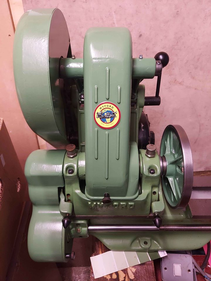

            The dulux paint colour match swatch under the left foot would ring some alarm bells ! Has it been hastily repainted?

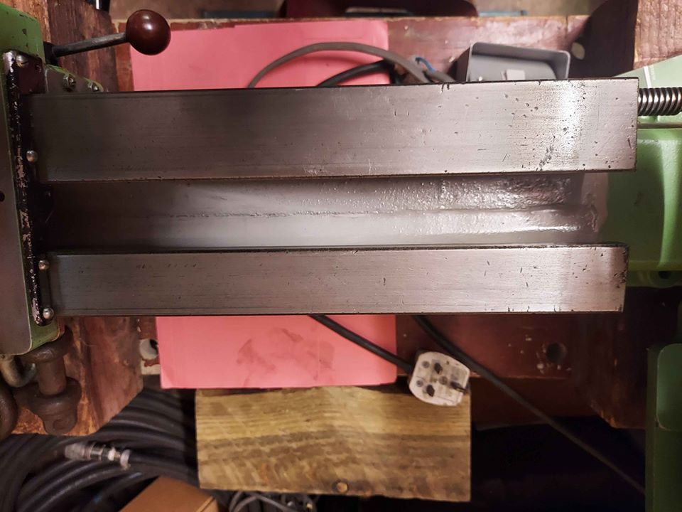

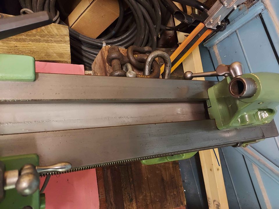

              It's always hard to tell from photos but it does not look too bad. There are quite a few unfortunate dents and dings in the the bed at the headstock end from some careless owner dropping things like chucks on there etc. But they won't affect the lathe performance. Bed visually in the pics does not look too badly worn, but who knows if it's been rubbed down a bit with emery cloth or a file? The machine looks to have been almost certainly freshly painted so somebody has been tarting it up. The original-looking black paint on the cross slide end bracket that holds the cross slide handle and dial, and on the felt wiper housing on the carriage,  probably is indicative of the original paint: some wear but not excessive.
              Best way to check is to measure the bed with a micrometer. Most wear will occur on the front bed way right about where the carriage is sitting in the pics. Measure the vertical thickness there and the horizontal width. Then compare with the same measurements at the less worn far left end of the bed. Max wear before a regrind is recommended is .005" on the vertical measurement and .003" on the horizontal measurement across the width of that front shear.
              The handwheels and levers etc do not show a lot of wear so it probably has not been driven into the ground in a commercial workshop etc. Can you ask the seller for some "before" photos showing what it was like before he painted it up?
              Is it worth 1000 beer tokens? Maybe, or not. You see them advertised for both less and more. Depends largely on the condition and also, very important, what accessories come with it. For that price you would like to get three and four jaw chucks, centres, tools, bits and pieces etc. The more the better.
              These old lathes are good when they are in good condition. And this one certainly appears clean and tidy enough. But it's like buying a 50 year old car. If you know what you are looking at and check it over carefully, you can get a good one. But if you don't really know and don't check it thoroughly, you might get a good one or you might get a dud that requires an 800 Quid bed regrind. My gut feeling would be that if this one has not been deliberately faked up, the bed does not look too bad. But who knows for sure? Best to inspect it in person and assess both machine and seller carefully.
              Sadly though, buying new is not always a guarantee of 100 per cent perfection either at the budget end of the market but at least you have warranty coverage and after sales service if you buy from a reputable dealer etc. Most people seem to be happy with them and many, many on here have used them for years with great success.

                    #481431
                    J Hancock
                      @jhancock95746

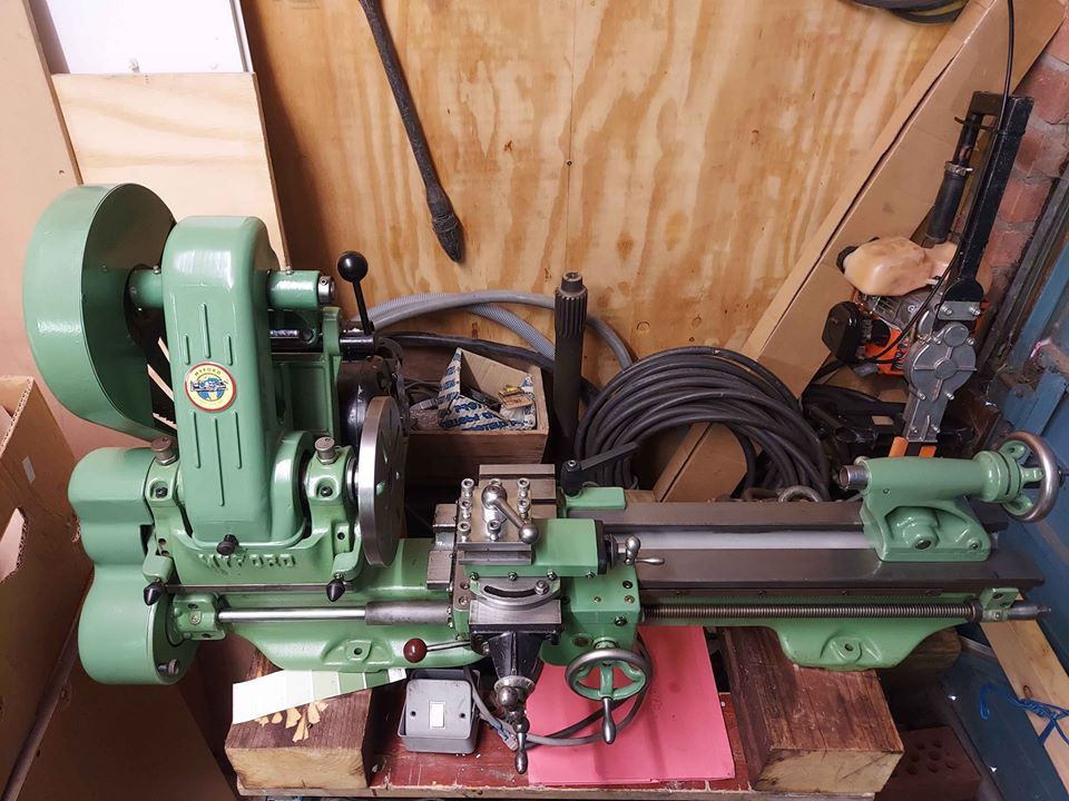

                      Looks nice but don't forget you will need a 4 and 3jaw chuck, full set of change-wheels, tailstock chuck,etc
                      as a minimum before you can really 'get going' .

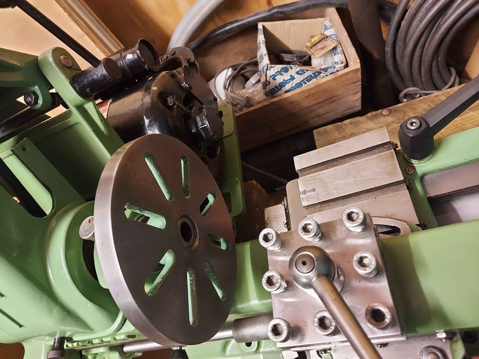

                                What is missing from the accessories are the second set of jaws for the 3 jaw chuck. Every 3 jaw chuck has 2 sets of jaws and at least 50% go missing. They are specific to the chuck on manufacture so would have the serial number on them so NOT available on ebay whatever the trader tells you. However 80% of your work will use the ones provided which is why thos ones don't get lost. You can get an adequate (not brilliant but adequate for a beginner) new chuck some time in the next 6 months for about £80. Again after a while not day one or even day 50 you will need a 4 jaw chuck (which only needs one set of jaws) for about the same.
                                The green thing with a handle on top in the middle is a 'vertical slide' worth £100+ gives you some of the functions of a milling machine the other parts would cost you at least £100. You won't need anything else for six months except a mask to hide the smug smile on your face. (ok, you need a better on off switch).
                                Although personally I would always prefer a Boxford on ebay this would have gone gone gone.

                                        It's relief to know I won't need much more to strat with. Good quality 4 jaw chuck is expensive but over time I should be able to afford one. Thank you for help Bazyle.

                                                I assume you can go and see it?
                                                Bed shows wear ridges, the depth needs checking with a feeler gauge & steel rule. Suck your teeth if a 5thou gauge slips underneath and tell him £600
                                                Don't forget it will only swing 7" dia x 20" long, which is just big enough for a Minnie traction engine wheel

                                                  Posted by Durhambuilder on 22/06/2020 08:31:04:
                                                  There again, it could be a good sign. Some people include a reference colour sample for the same reason others include a ruler.

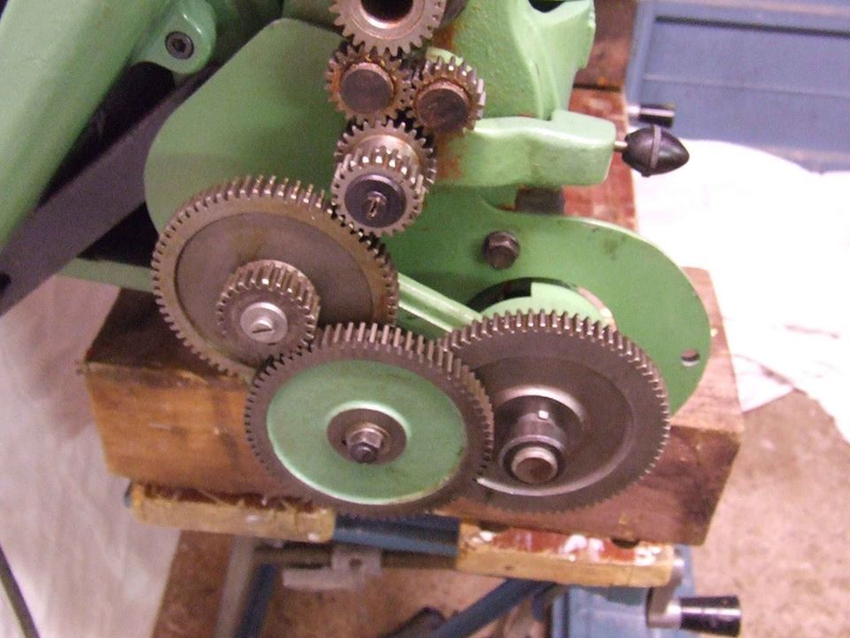

                                                    Plus ,I don't see the full set of change-wheels, add £80min.

                                                      I once had a ML7, but a fully equipped new one would have cost me four times what I paid for a new, larger Chinese machine, with power cross feed, and variable speed inverter drive. .
                                                      This one is almost suspiciously clean, but shows lots of minor dings. The lack of a full set of Change Wheels is off putting. Also, you ought to budget for: a 4 Jaw chuck, Cutting tools, and measuring equipment.
                                                      Worst case scenario, This one could have been nicely painted, but assembled for all sorts of bits. Headstock from one machine, Bed from another and Tailstock from a third. And what state are the Spindle and bearings in?
                                                      In which case it may not be well aligned. And with respect, as a newbie, setting up a machine is not a job that you should undertake, unless you are a patient, rich, masochist!, with lots of knowledgeable and sklilful friends!
                                                      You may well be far better paying out more for a new machine, such as a Sieg SC4, from a reputable importer, where, if there are problems, they will,be resolved quickly, and without argument.
