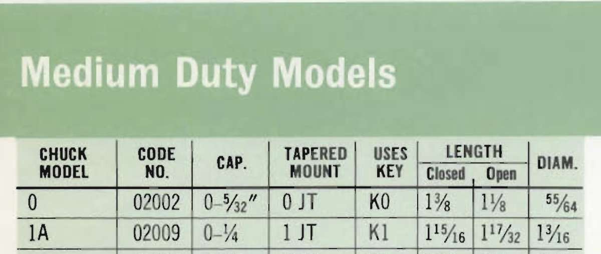

          Understood… My rationale was/is trying to stay true to the original design … I’m a bit of a purist sometimes.. When I found the Jacobs ‘1A’ (my mistake, I thought it was a ‘01’) I thought ‘ah-ha’.. 😎 But then discovered that it was larger than specified for the UPT…
          I have seen Jacobs ‘0’ advertised, so may see if I can get one.

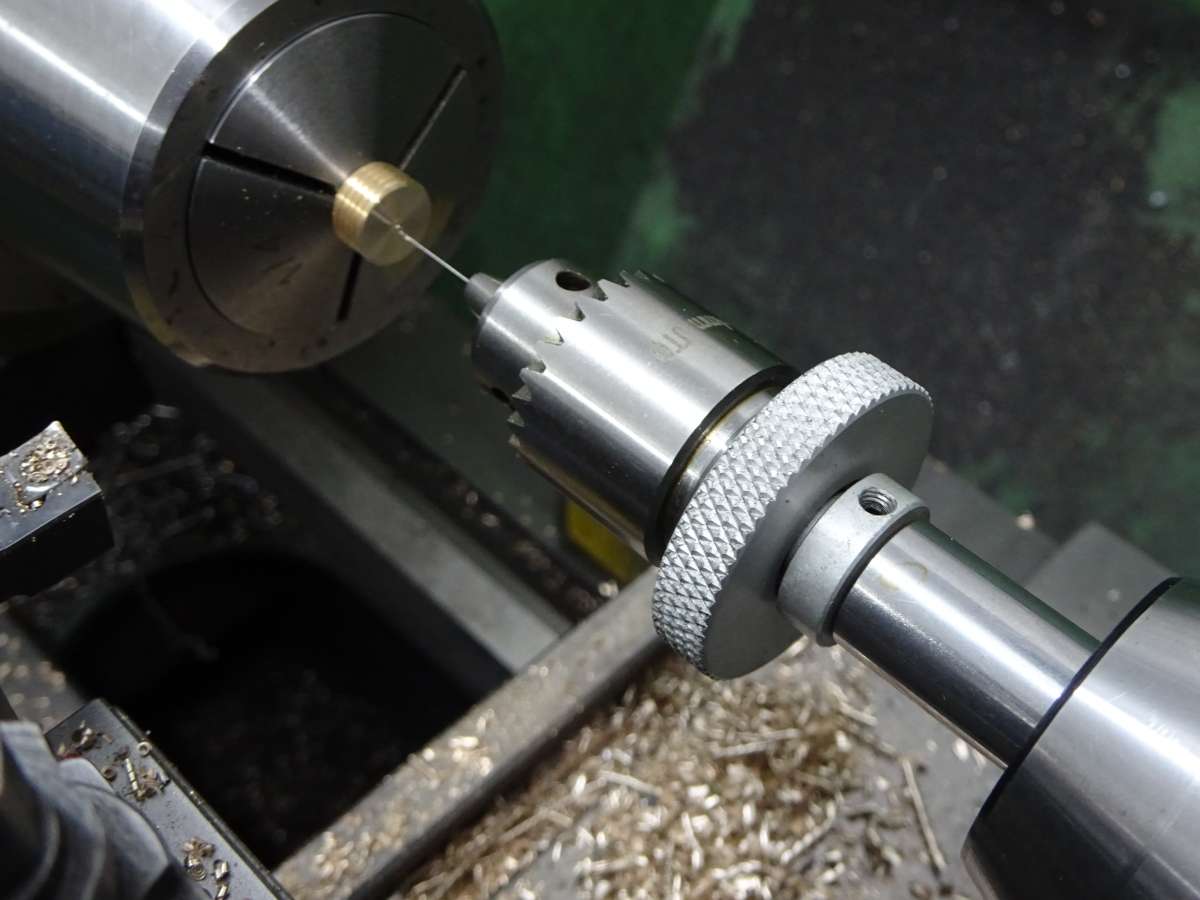

            There is no doubt that the #0 is a delightful little thing:
            IMG_9956

                  In practice it does go smaller, I think that is why ARC put the * next to the size. Also at those sizes a typical jobber HSS drill is so flexible you would be better off with PCB drills with their short business end and a decent dia shank to hold
                  Mine holding 0.3mm which is the smallest bit I have
                  DSC02676

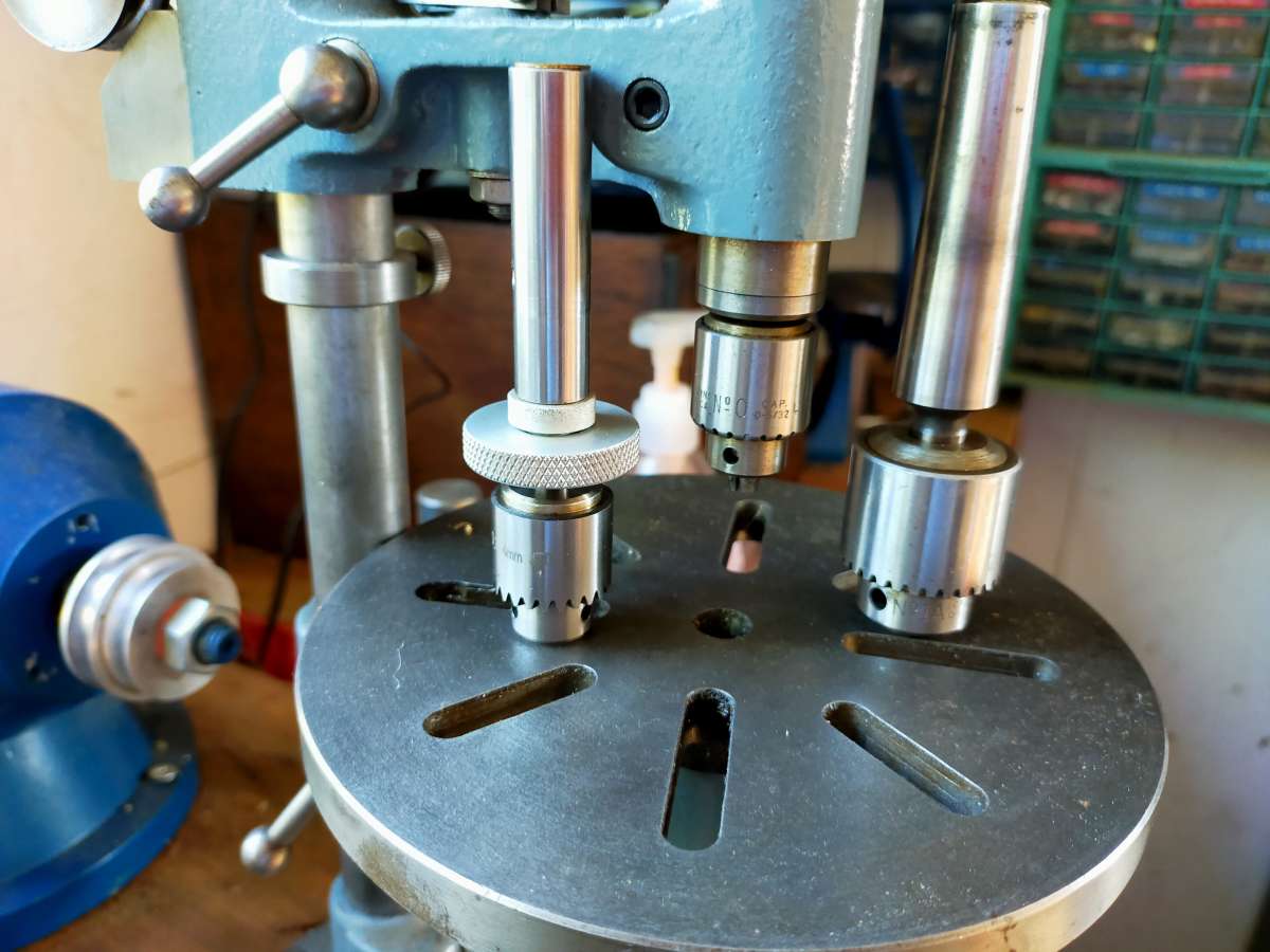

                      When I made my UPT 30+ years ago I hesitated for a long time before spending £40 on the No.0 Jacobs chuck.  The big advantage was that the diameter is less than the 7/8″ OD of the drill spindle housing so the whole thing can be withdrawn from the arm.  I have just had a look at the small ARC chuck and this OD is less than 7/8″ so this would be my choice today.  A typical 1/4″ chuck is too big and looks clumsy in my view.
                      small drill chucks

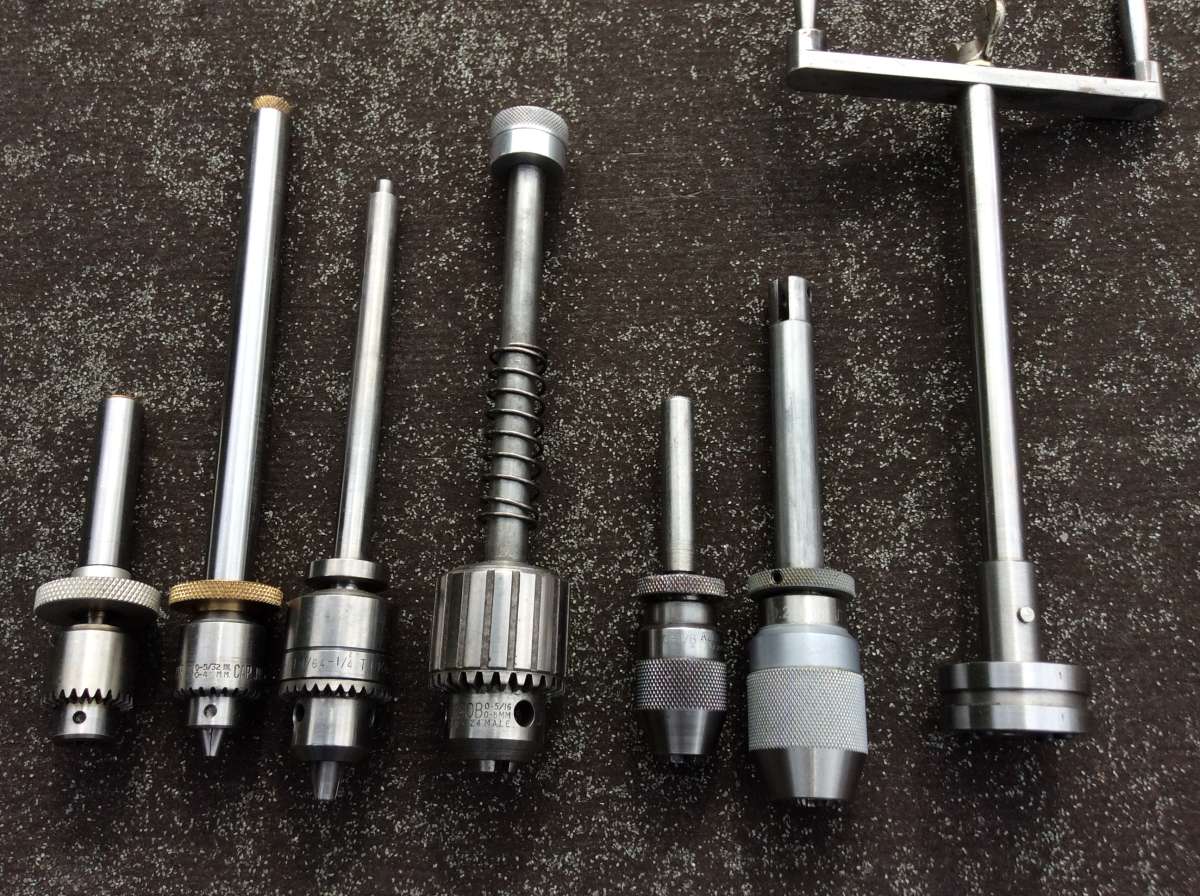

                        Over the years I have had several different chucks on my UPT and have settled on a 0.2 to 4mm keyless from Rotagrip, the body is a bit larger than the previous chuck but the convenience out weighs that. The chucks that have seen service on my UPT are below and go from L to R Arc euro 0.3 to 4mm/ 0 to 5/32/ 1/64 to 1/4/ 0 to 5/16(for tapping)/0 to 1/8 keyless(too restrictive in capacity)/the current keyless/and lastly the tapping chuck made from drawings on Mikes Workshop site, fiddly but works well.IMG_3636
